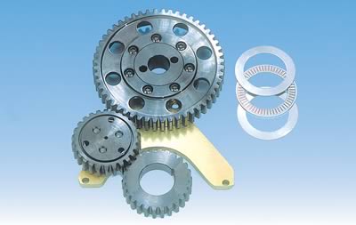

Here ya go Bruce
BTW thats the "dog bone" style I was refering to. this is the floating gear style or the other choice as it were.
this is also the style that requires machining of the engine block.
