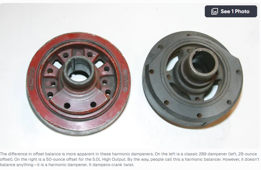

If there's a balance weight in the damper that means it isn't the six cylinder unit, so that's good.
Here's the 28.2 and 50 oz-in dampers:
Edit: Strangely, the caption incorrectly states that they don't balance anything.
It is a harmonic damper with counter weights for external balancing.
We just get lazy and call it a harmonic balancer.

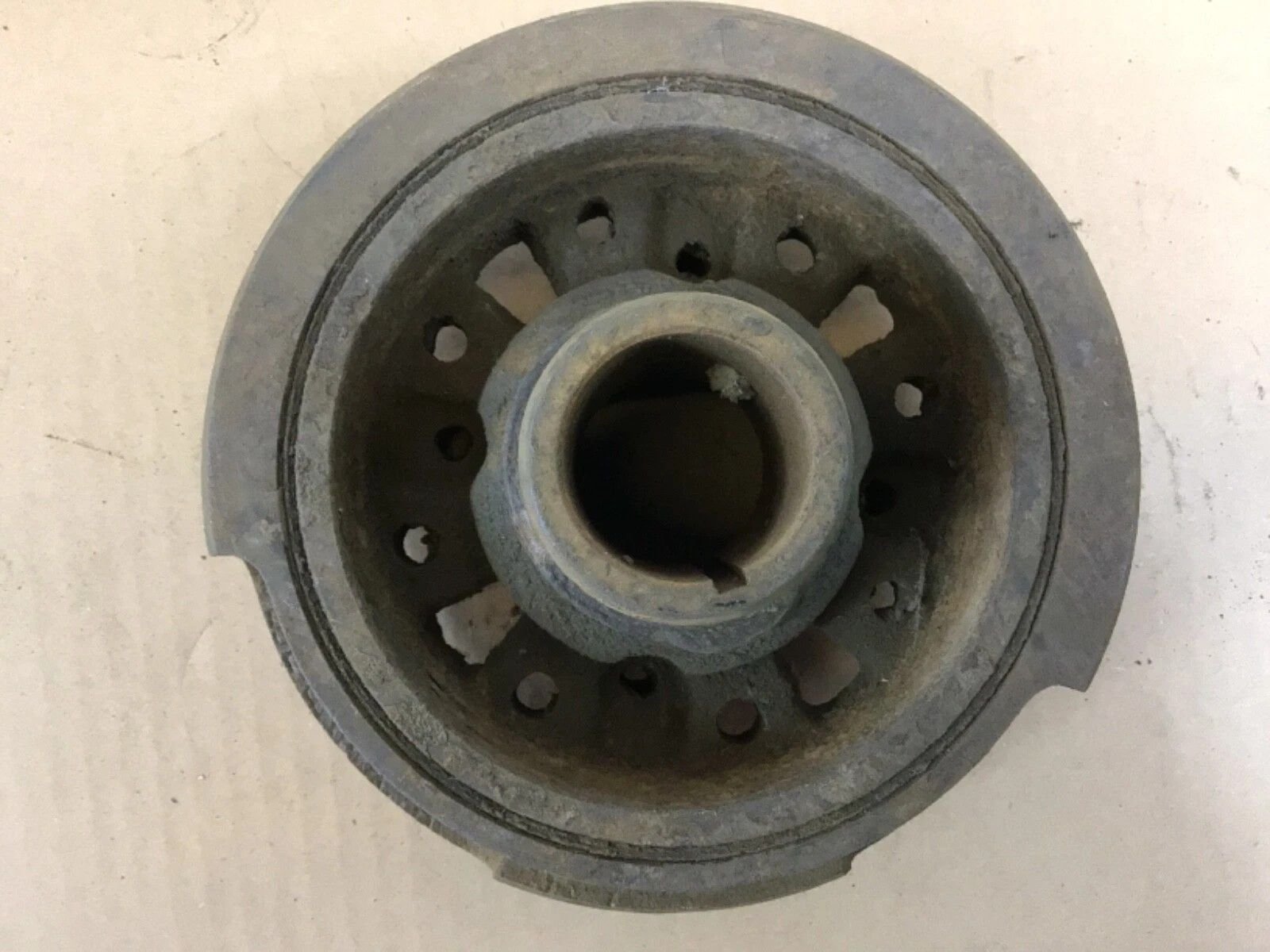

So I was able to find my notes on the original harmonic damper. It was D20E6316-A2A. I know for a fact it came off of a 1973 Gran Torino 302-2V. What I "believe" is that it is a 28oz imbalance. The replacement I used looked exactly like it, so I assume it's the same imbalance. The application said it fit 72-74 Gran Torino and a whole host of 1972 to 1980 model vehicles. If so, the new flywheel should work....I think.

Referring to the images of the balancers I recently posted, it's quite easy to tell if you have the 28 vs. the 50 ounce version.

Beanscoot - This is a pic of a damper like mine but not the actual one. Mine came off a stock 1973 Torino 302-2V.

Hmmm, that one doesn't look like either one I posted, so I guess it's not so easy to tell!
Anyway, a '73 Torino 302 would have the 28 oz harmonic balancer, so you no doubt have the right one, confirmed with the smooth running.
