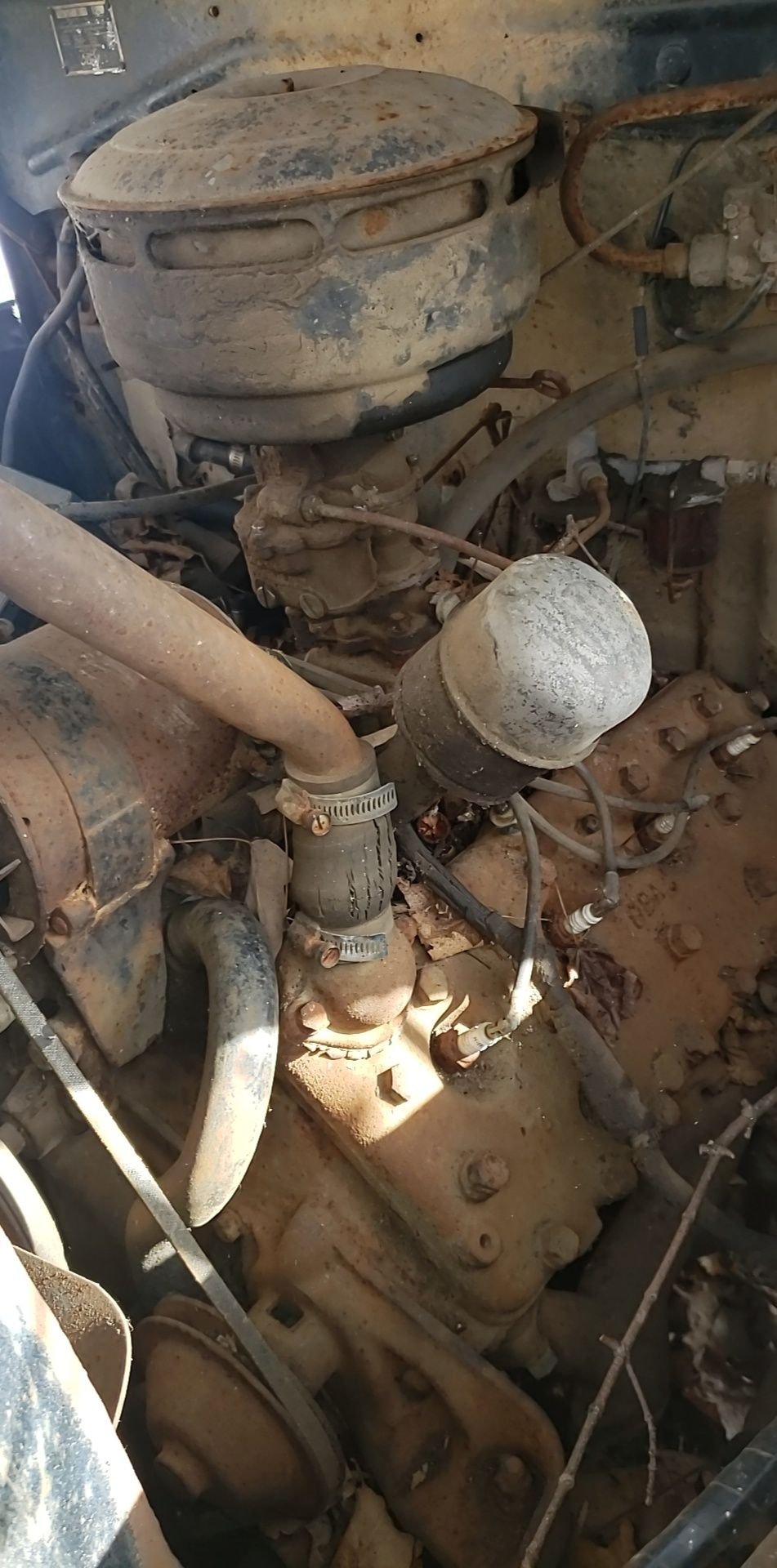

I wasnt about to scroll 16 years potentially of posts so im replying hoping this is still an active thread?
Old Jan 4, 2022 | 04:08 AM
  #1224
AuroraGirl's Avatar
AuroraGirl
Joined: Jun 2021
Posts: 5,207
Likes: 798
heres a shot of a cement mixer frame but the f6 is visible and steady
heres the axle and ***
Old Jan 4, 2022 | 09:53 AM
  #1225
mtflat's Avatar
mtflat
Joined: Oct 1999
Posts: 6,765
Likes: 547
From: Kalispell, MT
Thanks for sharing, and yes the thread is still active or at least monitored.
That is a very early 49 F6 produced in St Paul assembly plant.... 14th place in the data!
Differential is one of two: 2 speed with ratio either 5.83/8.11 or even slower 6.33/8.81
If there is a stamping on the firewall it would tell us a bit more. This would look like a number, SP another number and letter and probably 3 or 4 more numbers - something like: 3SP12B2345
If you find that post it and we can fill in more details.
Tim

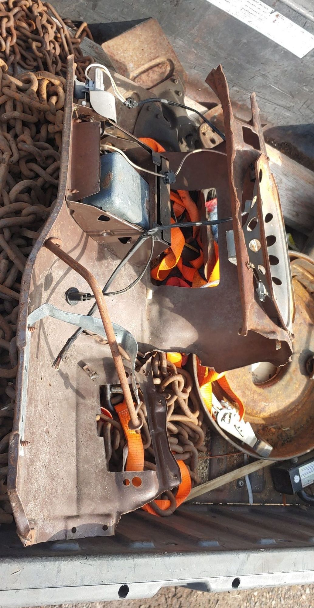

Cool. Ill have to try and get back there and check more for that. Question, would tire chains have been a factory item? I yanked two chains quite ****ing long and not very wide and I was thinking its for that logically but beings my gpa has owned it since before my mom was born it may have been for a smaller tractor.
St paul makes sense, my f150 and old LTD came from there and I think my 53 customline prob did too. Its from a northern wisconsin county truck its whole living life, close to minnesota. makes sense being 14th but sweet
That bed is also not stock option right, it would have been a cab and chassis most likely?
Old Jan 4, 2022 | 10:26 AM
  #1227
mtflat's Avatar
mtflat
Joined: Oct 1999
Posts: 6,765
Likes: 547
From: Kalispell, MT
Unless you find a tag on the bed that is Ford script, it is probably after market so it would likely have been cab and chassis.
Chains are available and are long and heavy. I have 2 sets that fit the 8.25x20 tires for my F6 and F4 plow trucks. They are similar in size to tractor chains.
I'll try to get a picture that shows the difference between pickup chains and big truck chains. I'm sure your grandpa used chains in n Wisconsin like we do in MT.

Im sure the county did too, for whatever the truck did. im guessing it maybe had a large dump bed but the dump bed went on the next truck when they replaced it
Old Jan 4, 2022 | 11:17 AM
  #1229
AuroraGirl's Avatar
AuroraGirl
Joined: Jun 2021
Posts: 5,207
Likes: 798
I may be wrong but i believe the chain sitting under this dash piece from a square body chevy is at least one of them but i may be wrong
Old Jan 4, 2022 | 11:38 AM
  #1230
mtflat's Avatar
mtflat
Joined: Oct 1999
Posts: 6,765
Likes: 547
From: Kalispell, MT
They're dualie chains so they measure approx 26"wide by 10' long with a third chain down the middle. Tractor tire chains wouldn't have that. The picture you have looks like truck chains.
