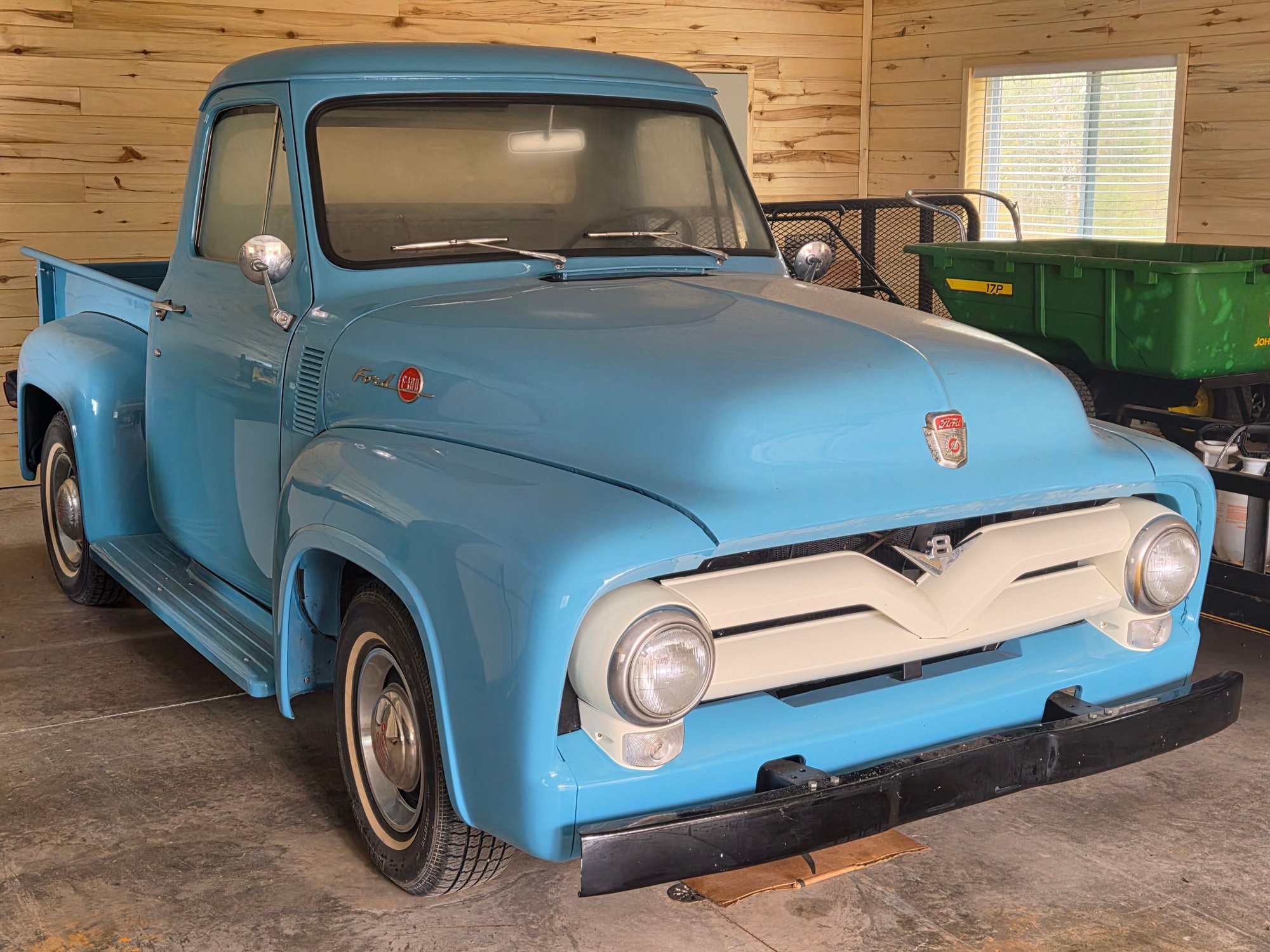

When you found your truck, very nice looking truck by the way, and it had the 223, did it have the V8 emblem on the grille?

Forgot to answer the question about the V8 grill emblem from 55F250. Short answer is that it originally had a chrome, 4 point star. When I swapped out the 223 for the 292 I rebuilt, I replaced the star with the V8 emblem. I know it's not OE correct from a purists perspective, but it makes me smile and feel good about the work it took to make the conversion. Otherwise, everything else is original to the truck. The color Regatta Blue, was original but it may have been an option. I never saw it on the 55 truck paint color sheet but I know it was available on the 55 Thunderbird. Restoration took about 8 years but I'm pretty close to being all done, if you ever are on a 71 year old truck! Lol
