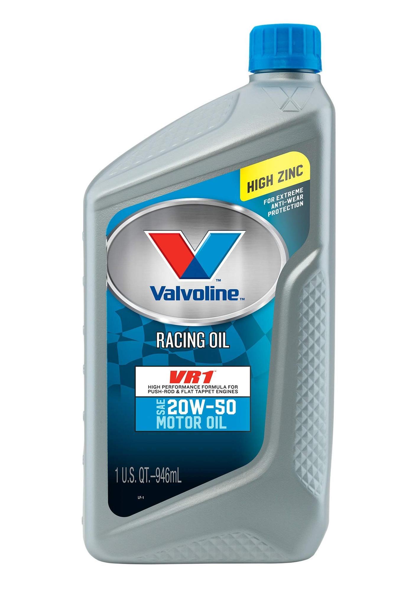

Also depends on your engine. Most newly rebuilt engine owners will use a good detergent oil. Valvoline VR-1 racing oil is considered one of the best choices.

Vavoline VR1
