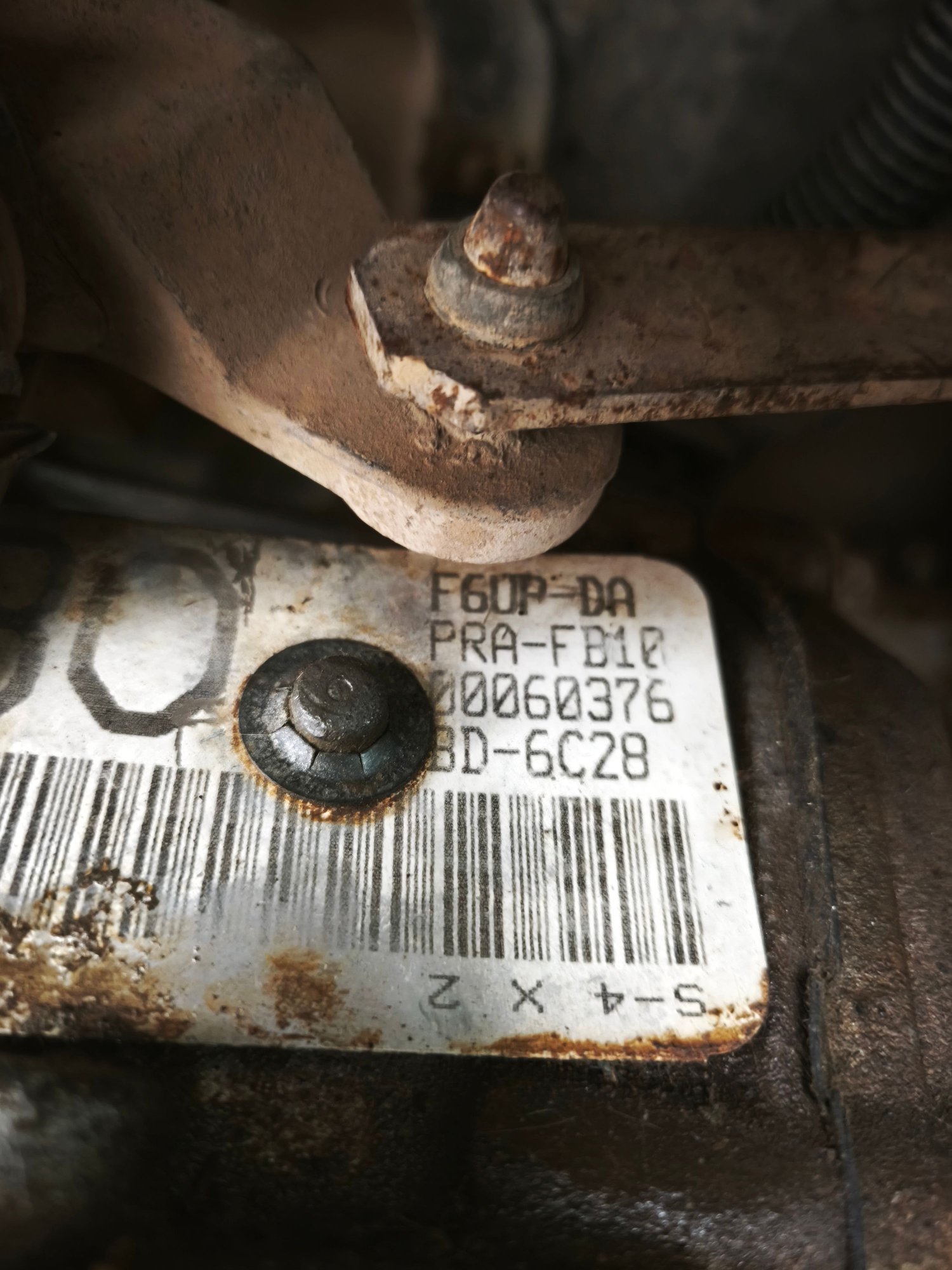

Ford did not put the AOD behind the 351W in a truck so was it swapped in by you or someone else? What is the transmission code on the driver’s side B pillar?
Old May 14, 2026 | 06:54 AM
philippe de marseille's Avatar
Joined: May 2024
Posts: 32

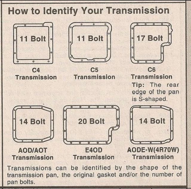

The best thing would be for me to provide you with a photo of the plate on the box.
Old May 14, 2026 | 01:45 PM
My4Fordtrucks's Avatar
My4Fordtrucks
Joined: Jun 2015
Posts: 12,871
Likes: 2,445
or you could look at the pan and match it up to a transmission ID chart easily found on the internet. This is one I got by searching for Ford transmission ID chart…
Old May 14, 2026 | 04:10 PM
Joined: May 2024
Posts: 32
it's a E4OD
Old May 14, 2026 | 04:24 PM
Mark Kovalsky's Avatar
Mark Kovalsky
Frmr Ford Trans Engr
Joined: Aug 1999
Posts: 24,730
Likes: 2,658
From: SE Florida
There are feedbolts between the valve body and the case. If they loosen, they can cause this. If they are tight, about the only other way this could happen is a damaged reverse clutch.
