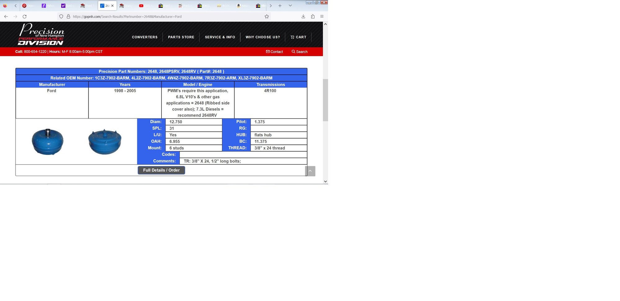

I need to get a torque converter for the 4R100 and the builder and supplier use Precision of New Hampton, which I'm good with. The supplier is saying the part number on the unit is 2648PS, but from what I'm seeing...see attached...that's not an option. I asked about the 2648PSRV and he said his warehouse doesn't have that available, but I'm thinking this is what he actually has. I think they make one which has a lower stall speed that has an additional MX designation, but I don't see that as even being available in the cut sheet. I'm assuming these are all triple disc convertors given I've seen mention of a single heavy duty disc, but I think that may either be an old add or one for the gas units.

#1 - What is the stall speed on the Precision 2648PS...assuming this is a 2648APSRV...torque converter?
#2 - Does Precision offer a lower stall speed convertor than the one above that possibly has the MX designation?
#3 - Would it be worth spending the money on the billet input shaft given the stock unit looks fine with my power levels?

I called Precision this morning and the 2648RV is a basic convertor with a lower stall speed of 1,800rpms. The 2648PSRV is the same as the aforementioned, but it has a billet face. I was hoping for a 1,600rpm or a little lower stall speed, but I'm not paying double/triple to get it.
