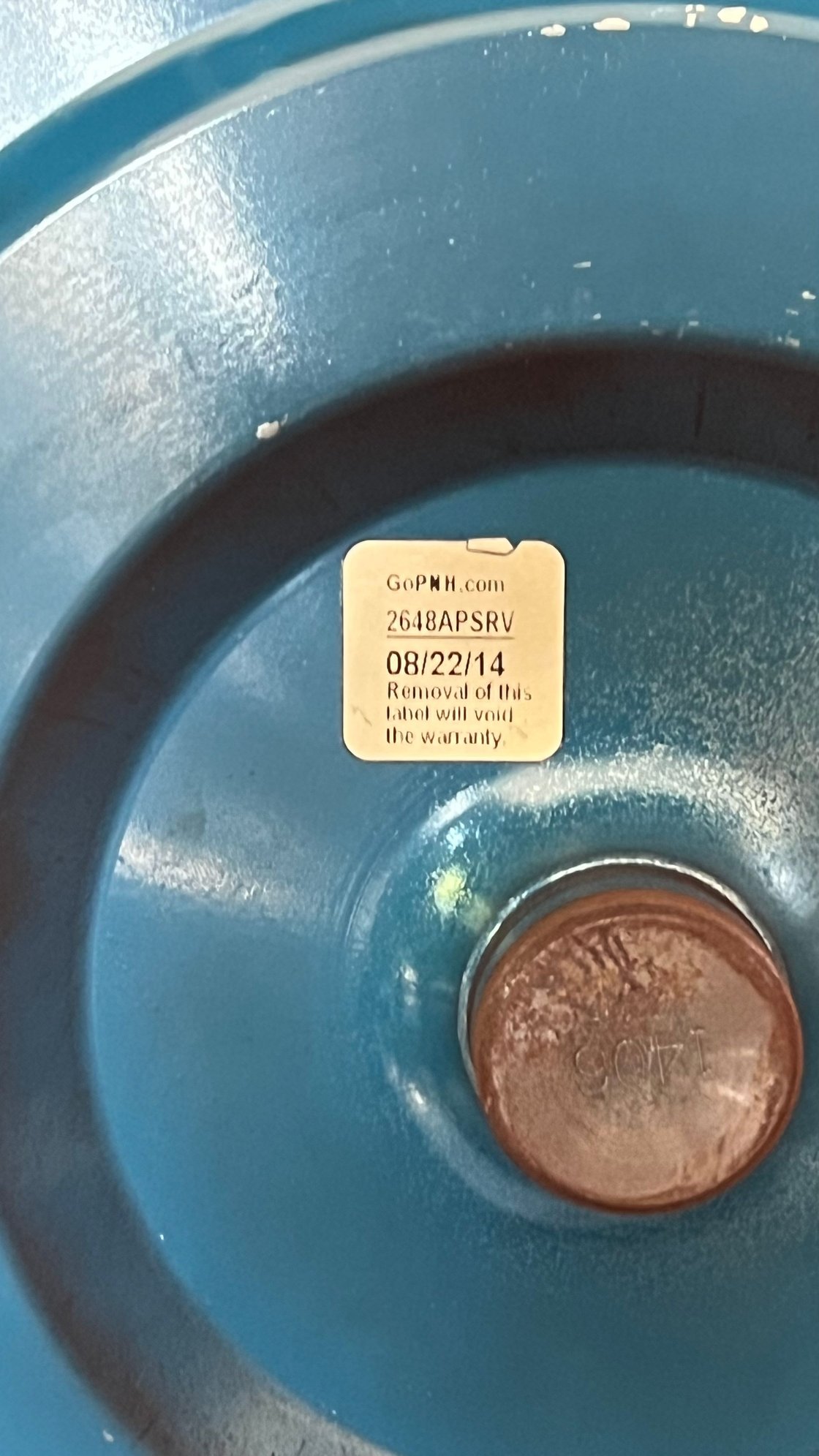

So I have the engine out, would it be ideal to replace torque converter? This is the one that the truck has, is this the stock one or a whole different converter that previous owners must have replaced before?

Looks aftermarket to me.. I think you would be well served to try and figure out where it came from.

That is a good precision of new hampton low stall converter, I would leave it in there and continue using it.

Now would be the most ideal time to do the up-pipes while the engine is out, assuming that they could use some attention based on the soot witness marks on the firewall.
Somewhat confusingly, there are at least two different torque converter vendors named "Precision".
There is Precision Industries, in Tennessee, which manufactures the "Stallion" torque converter, painted purple, that Brian's Truck Shop (BTS) uses used to use (thanks ESwift).
Then there is Precision of New Hampton, in Iowa, that is referenced on the label of the torque converter in the photo above.

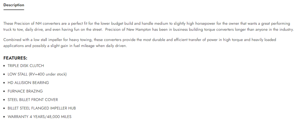

The transmission shop I get my customers' remans from uses PNH exclusively and they supply my personal torque converters on my rebuilds as well. The transmission shop has two flavors available for the E4OD and 4R100 but I'm not sure if PNH has more....never checked nor had a problem.

Here is some info on the PNH

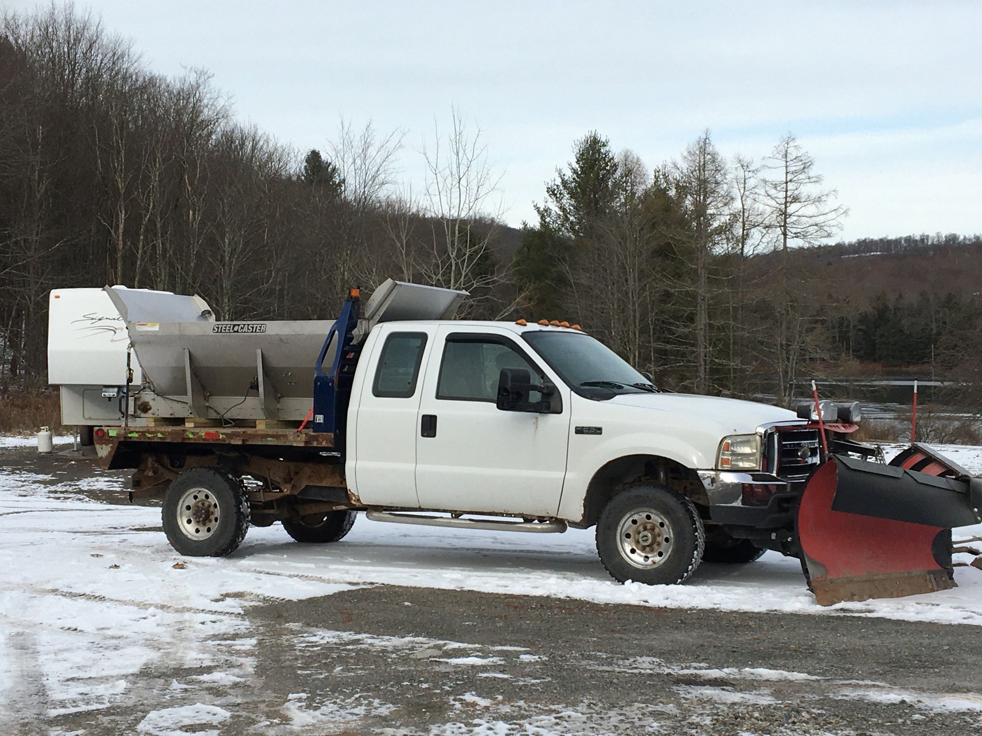

here are some shots from the last 16 years at this property(our family has been maintaining this place for 45+ years)
