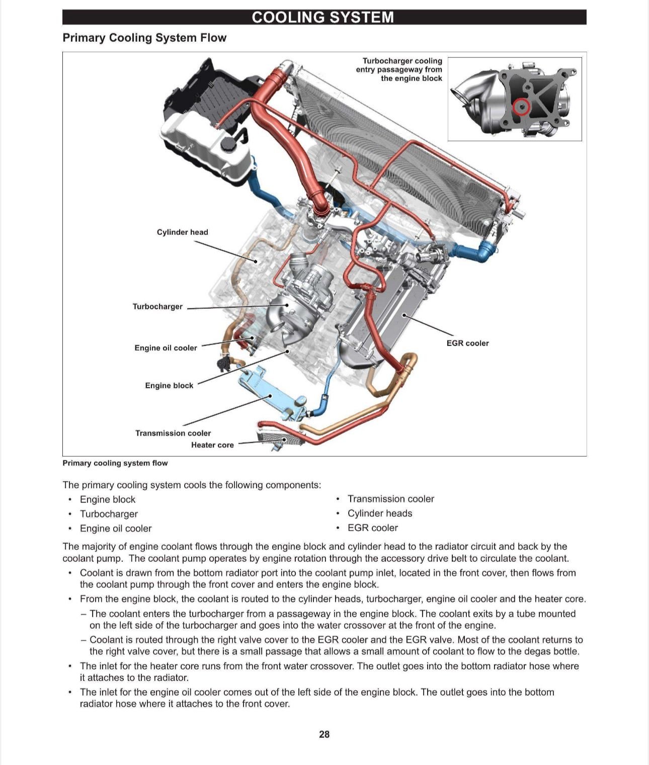

PSD Coffee Table books mention transmission cooler, relevant pages from the 2020 book:
link to the 2020 book: http://www.forddoctorsdts.com/forddo...-DTS-small.pdf

Originally Posted by Garbageman 134
We drove from Illinois to Tennessee yesterday and I was watching the transmission temp when we started doing a lot of uphill and downhill driving. I noticed the trans would get up to 221° and then it would drop down to about 207 and then work its way back up and then back down so I'm assuming the system is designed to cool down the fluid once it reaches 221.
I know the transmission cooler is underneath the truck next to the transmission and I'm just curious if anyone knows how the logic works. From what I remember the transmission cooler uses engine coolant to cool down the trans fluid. Does the computer open a valve when the trans gets up to 221° and cycle trans fluid through the transmission cooler?
Everyone looks at this as a cooler but it’s more than that. As @Gladstone posted the transmission cooler is really a heat exchanger and it works both ways. It also transfers heat from warm engine coolant to cold transmission fluid on cold starts. And as mentioned above it is thermostatically controlled to maintain an optimal operating temperature range
