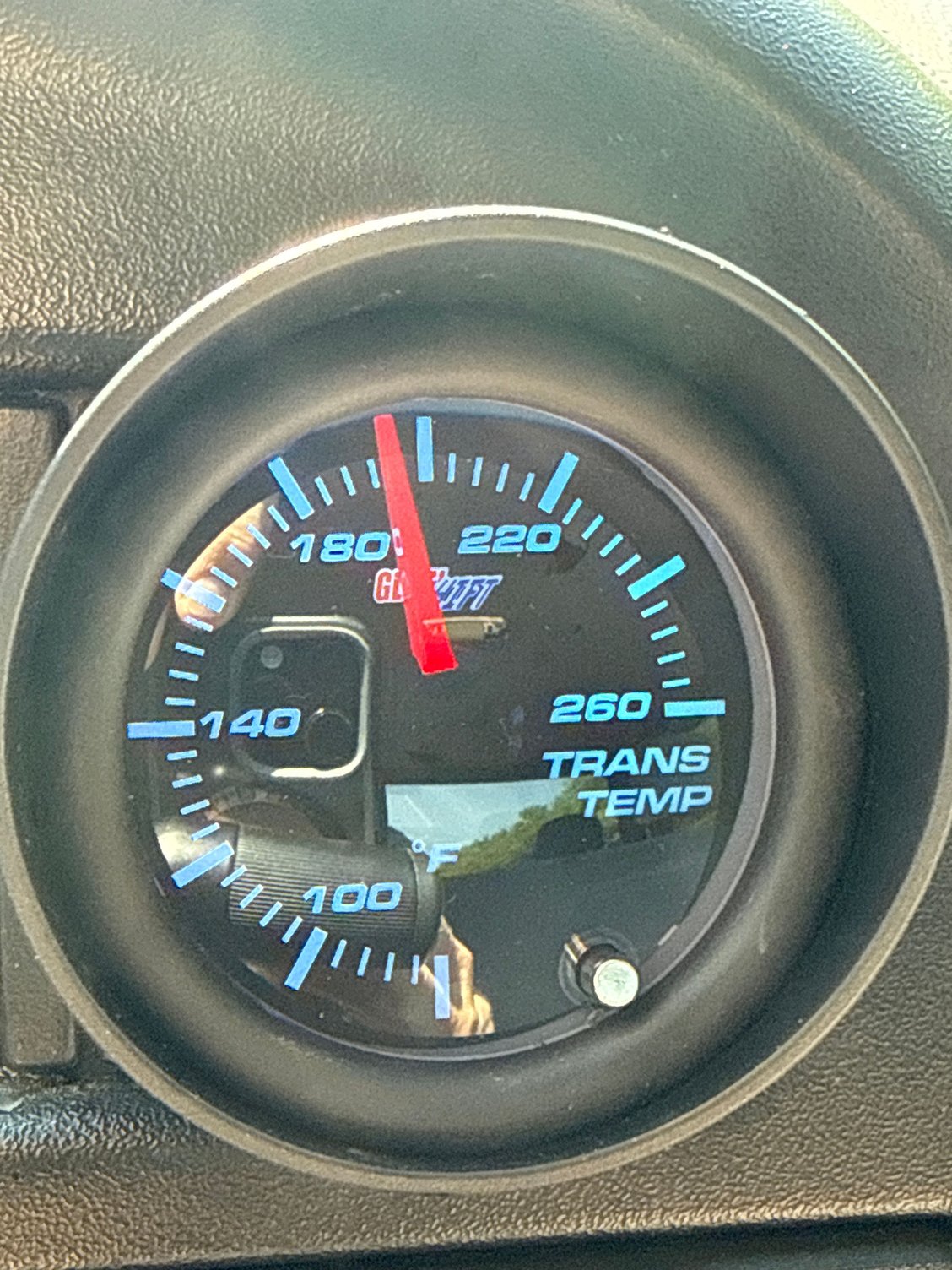

Are these temps okay?
I installed the temperature gauge just to see what was going on. These are my tips on the interstate at 65 miles an hour after driving for about an hour. Is this normal? 72 degree day. Unloaded. 65 mph cruise at 2200 rpm

In the same conditions on my F250/5.8/2WD, my temps are around 150-160. My coolers are much larger than stock. When I am towing and under load [ie up a long mountain pass in the summer] my temps do not go higher than 195F.
I suspect you are fine and within the stock temp ranges.

That should have been asked in a new thread, as it's unrelated to this one, but yes, those are good normal temps, if your sending unit is in the test port. Pretty much up to 225F is very safe. 175F is stated to be ideal, as it's warm enough to burn off any condensation (you don't want milky ATF in there) and the higher it goes, it will break down sooner, but pretty much "great" trans temps, as measured at the test port is 170F-200F to run all day long, issue free. Some guys make the mistake of running too large a cooler (without a t-stat) and not allowing their trans to get up too temp. Just like an engine, the trans has an optimal operating temp also.
