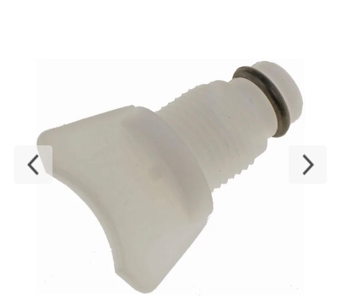

Passenger side under radiator leak. I was thinking original radiator but then got to thinking o-ring on the radiator drain valve. $1.99 vs $200.00. As I type this, the test gauge has been holding 15 psi for twenty minutes. Not sign of loose coolant.
O'Reilly's has an assortment of Murray o-rings. MRY 24629 is correct for my 1995 truck.

At one point, I thought it might be the drain valve, but it was "closed" so I stopped considering it. But you might be onto something. Can you tell me where this o-ring goes exactly? If the valve is closed, and nothing ia attached to it, where would an o-ring even come into play?

It’s on the drain plug, inside the radiator.

I don't understand. What is it sealing, if there's nothing connected to the drain plug?

Well, it’s sealing coolant from coming out since it’s the drain plug for the radiator.
Pull it out, you’ll see.

The valve body is tapered. There is an o-ring on the end of the valve stem. The original o-ring gets hard and flattened and quits sealing as when new. Drain the radiator and then unscrew the valve stem all the way and then yank it out.

I really just have no idea what you guys are talking about. Maybe that's the problem - maybe I'm missing some part that should be preventing fluid from coming out?

Does this help at all?

Yes, thank you! Now I know exactly what to check tomorrow.
