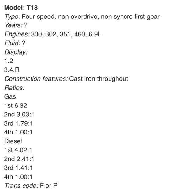

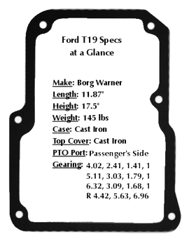

Originally Posted by OldTrucksAreBetter
Unless the trans has been swapped, you are looking at a T-18 transmission instead of a T-19 in that truck.
Not a huge difference but gear lower gear ratio's aren't the same. I have both ..
That’s not what I remember hearing when I was active on JeepForum. Guys would say to get a T-19 instead of a T-18 because they were the same except that the 19 has a synchronized first gear. That is also what is shown here
from a F150online.com thread.

My 89 F150 (gas model) came with the T-18 and had different gear ratios than the T-19 that I have in it now. The T-19 came in more gear ratios than 'My4Fordtrucks' is referencing here.
Anyways, the intent of my post was so that the OP would be aware that he may not be getting a T-19 transmission in that truck he posted about ... T-19's typically did not come in F150's of that era.
For those that want to debate gear ratio's between the two, check out: https://www.novak-adapt.com/knowledg...manual/t18-t19 which has a lot of information on these.

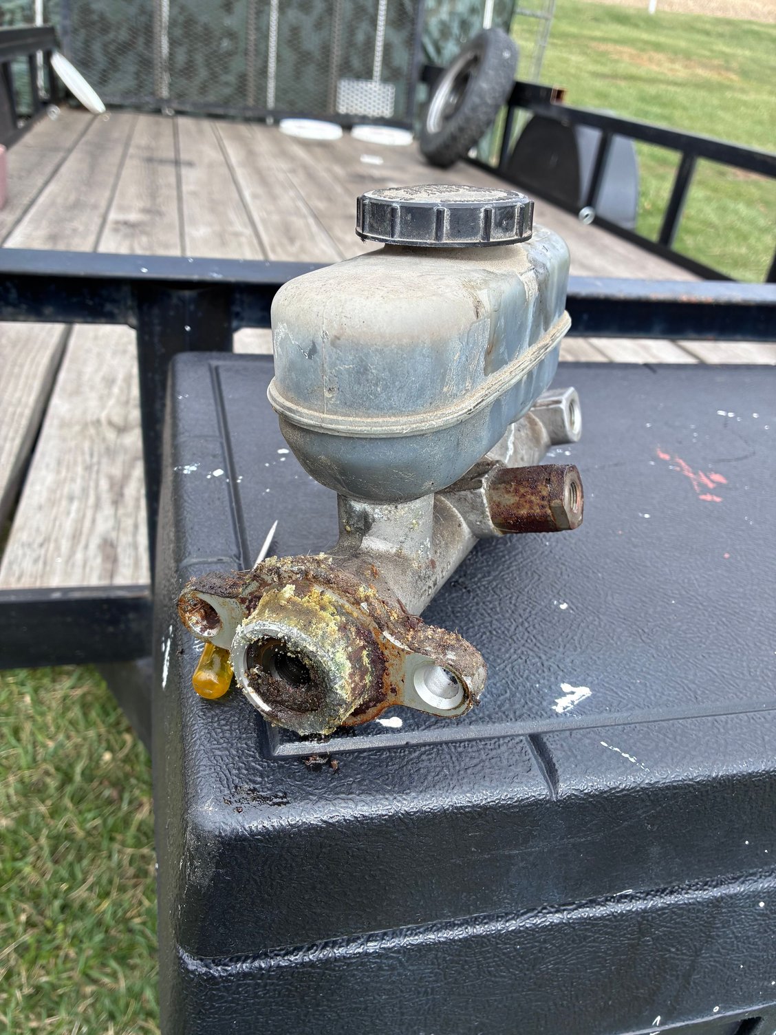

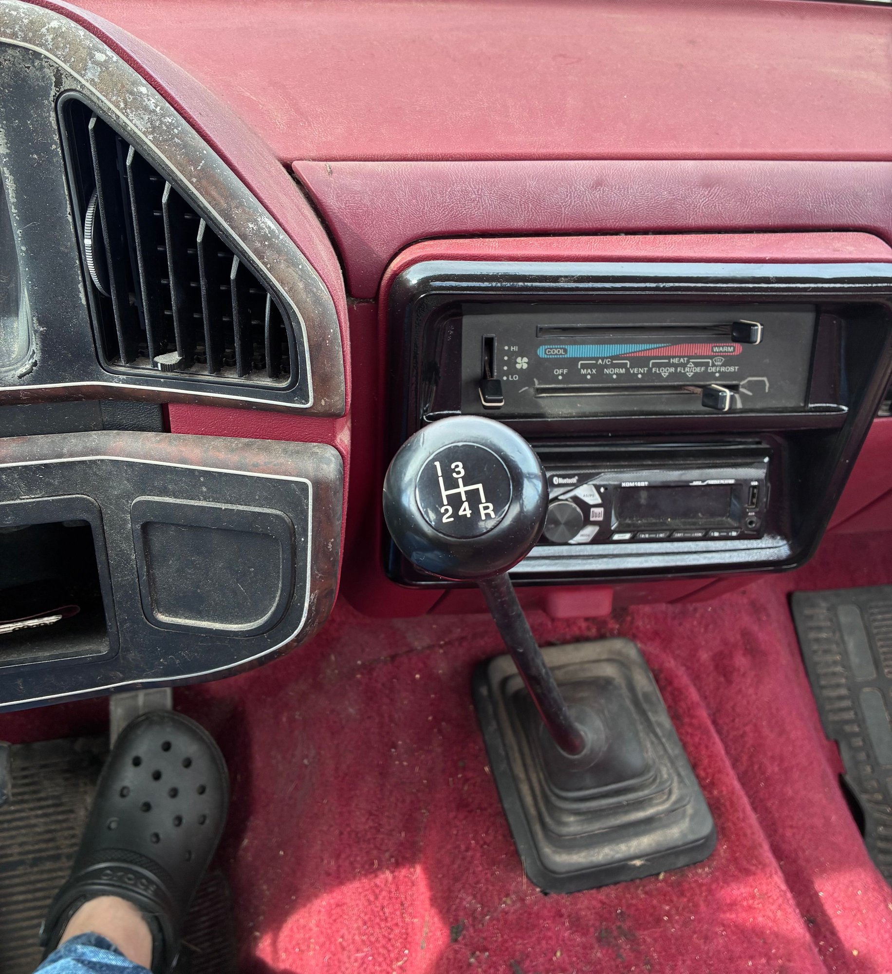

I guess it is a T18, either I read something wrong when I looked it up or the information I found wasn’t correct. Brakes aren’t that great, pedal very low & I noticed leakage on the brake booster. So - master cylinder time. Which may also mean new calipers & wheel cylinders if I cant get the bleeders loose, I can picture them all breaking. Probably a good time for new flex lines on the front. Have a whole laundry list of things but brakes are first since I dont feel its safe to drive as it is. future needs are drivers side window regulator & door hinge pins/bushings, nylon tailgate bushings & the side cables. thermostat & gasket (on order already) better tires, seat, gearshift **** (have the original but wont stay on, can see someone tried glue once before) Did get it put in my name & have a plate for it. Tried putting it in my garage but its a tight fit & impossible to work on in there so will have to wrench on it outside. May pull the tires tomorrow & start soaking the bleeder screws with wd-40.

Btw, I used Gorilla glue (the kind you hafta add a dab of water to) on my shifter **** and it did the job of keeping it on very well. So well that I can't get it to come off

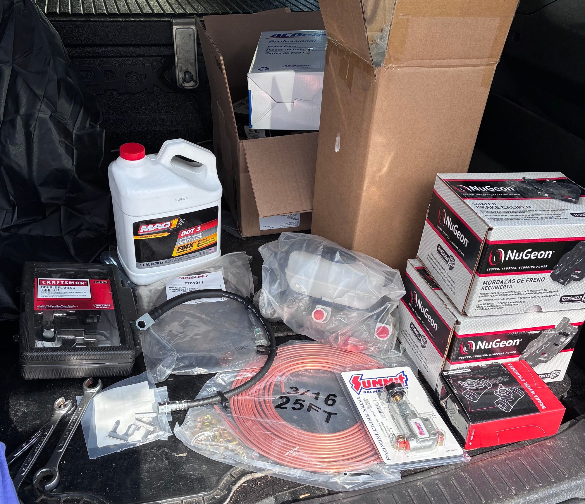

Used jb weld for the gearshift ****, it seems to be on good now. Started on the brakes today, master cylinder is indeed bad. Im bypassing the rear abs for a manual proportioning valve. Changed the thermostat last weekend but still not getting the heat in the cab like it should, with winter about over its not high on the priority list. Hopefully I get all the lines made & the new calipers & wheel cylinders on tomorrow, bleed the system & can start driving it soon.
Brake system replacement time! not the usual 2 hour job!
original master cylinder

I had one RABS valve go bad causing a spongy pedal and I replaced it with another RABS valve. It’s not a great system like something brand new but it works ok enough for me to keep it functional. I did replace the RABS valve with another adjustable proportioning valve on the ‘87 Bronco but that was only because I replaced the 8.8 rear with a 9”.
Are the heater hoses getting hot? Have you looked behind the glove box to see if the blend door is moving as you work the temp control? It might be as easy as the cable isn’t attached to the door.
I cheat and get pre-bent stainless steel brake lines. Bending and flaring lines isn’t worth my time. I put a set on the ‘89 F-150 in 2014(?) and when I did the frame swap three years ago I transferred them over to the “new” frame. They were still in great condition.
