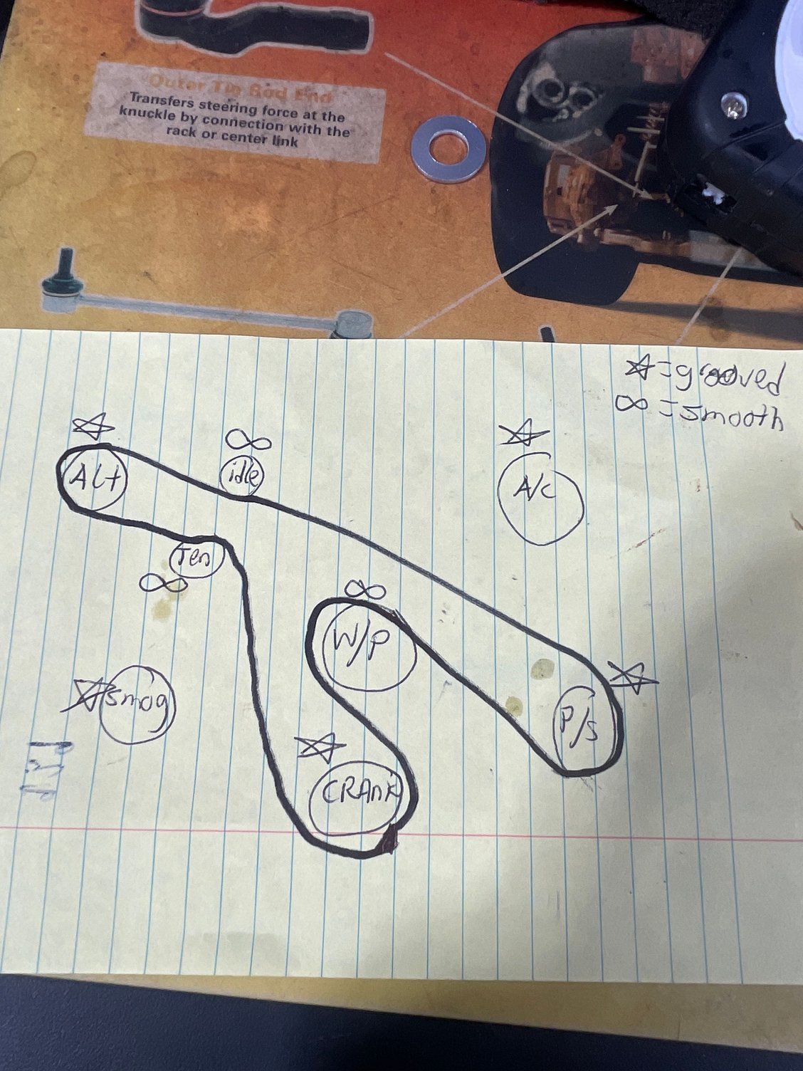

Has anyone gotten rid of both the smog pump pulley and ac pulley on their 92-97 with a 302/351? I didn't find much info on it online but I think it may be possible to do. This diagram I made is what I was thinking of how the belt can be routed.

If it were me, swap your idler for a ribbed pulley so you can route above it. That would assist in it not hitting water pump between alternator and power steering. I haven’t done this though.

If you put an A/C delete pulley on it, my belt ended up being 88.5" with no smog pump on a 351W.
I don’t see how that would keep tension on the belt and not squeal.

Yes and no benefit to removing them when you can keep as an idler pulley for free.
That depends on how far back you want to go because the belt routing and tensioner location was different on the ‘89 than the ‘94 serp system I have now.
