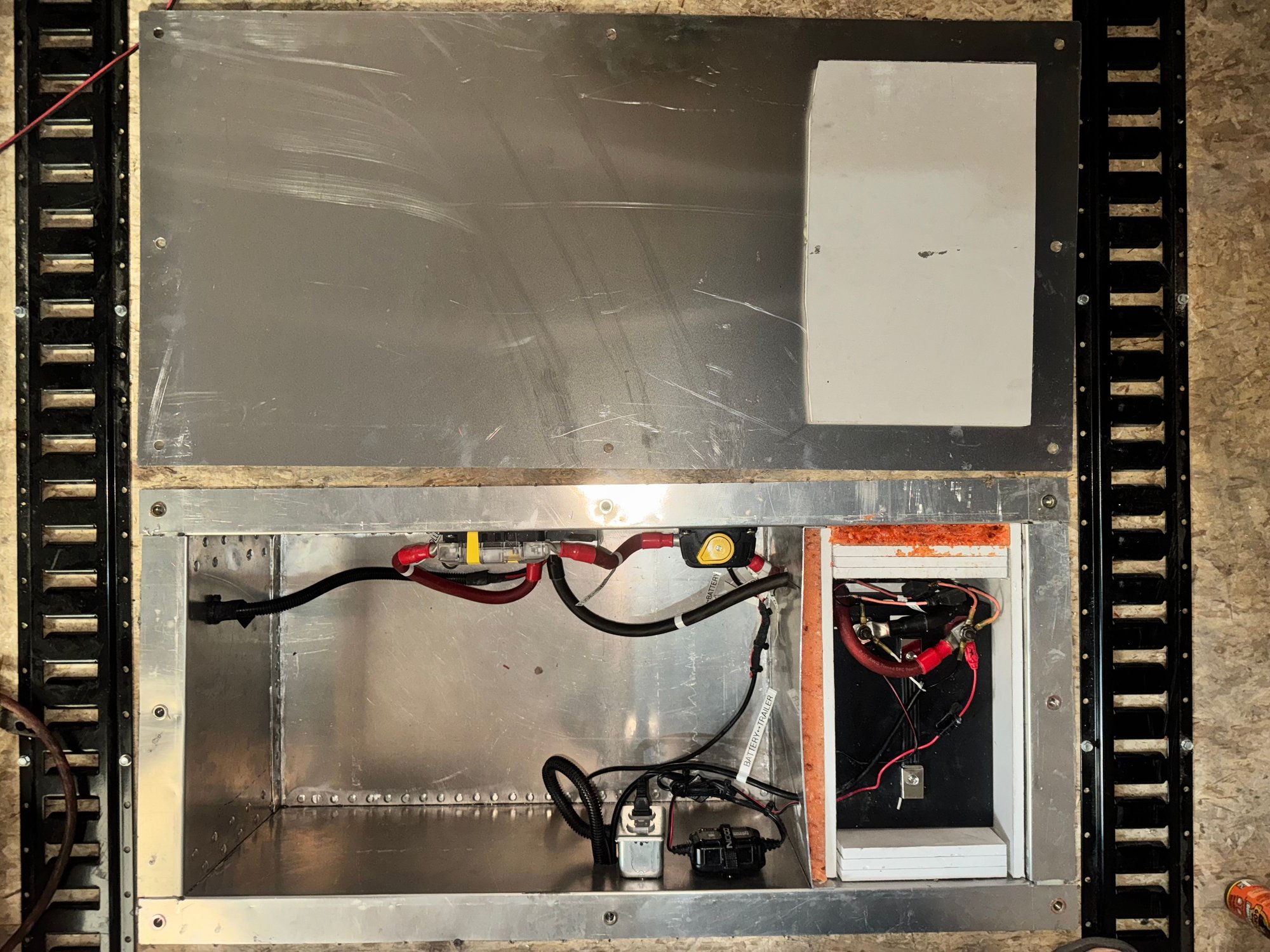

i installed the Power Master 9051. All new 2/0 welding cable (my wheelhouse).
here’s my ‘02:

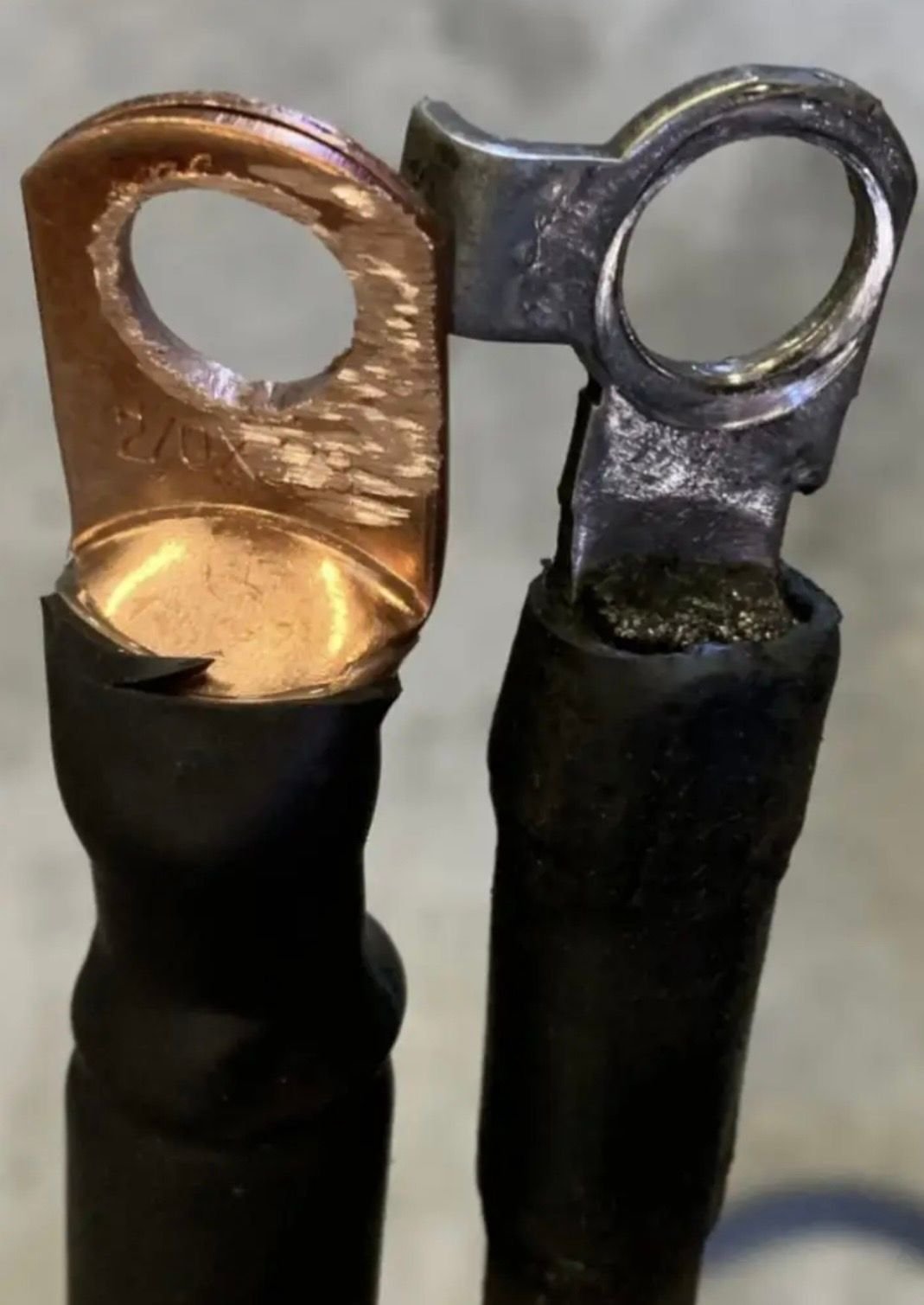

in my opinion, use closed lugs not what FORD did with open lugs (see picture and oxidation going leeching into the copper strands on the OEM cable
use marine heat shrink, it has a glue inside the shrink tube to seal it
do a test run with the dies, do not over crimp, it can break the copper strands

RigCity, a battery cut off can be a good idea, especially if there’s nowhere to plug in a battery maintainer. However, in my photo that is a Blue Seas 600A cut off switch for my 17,500# winch power going to the front bumper. I wanted to be able to isolate the power to it in case of a front collision when the winch is not in use👍
I also use the Anderson style plug for other things as well and have an ANL fuse holder where I can swap out different amp fuses.
i should have specified in my original photo. Enjoy your upcoming project🙂
