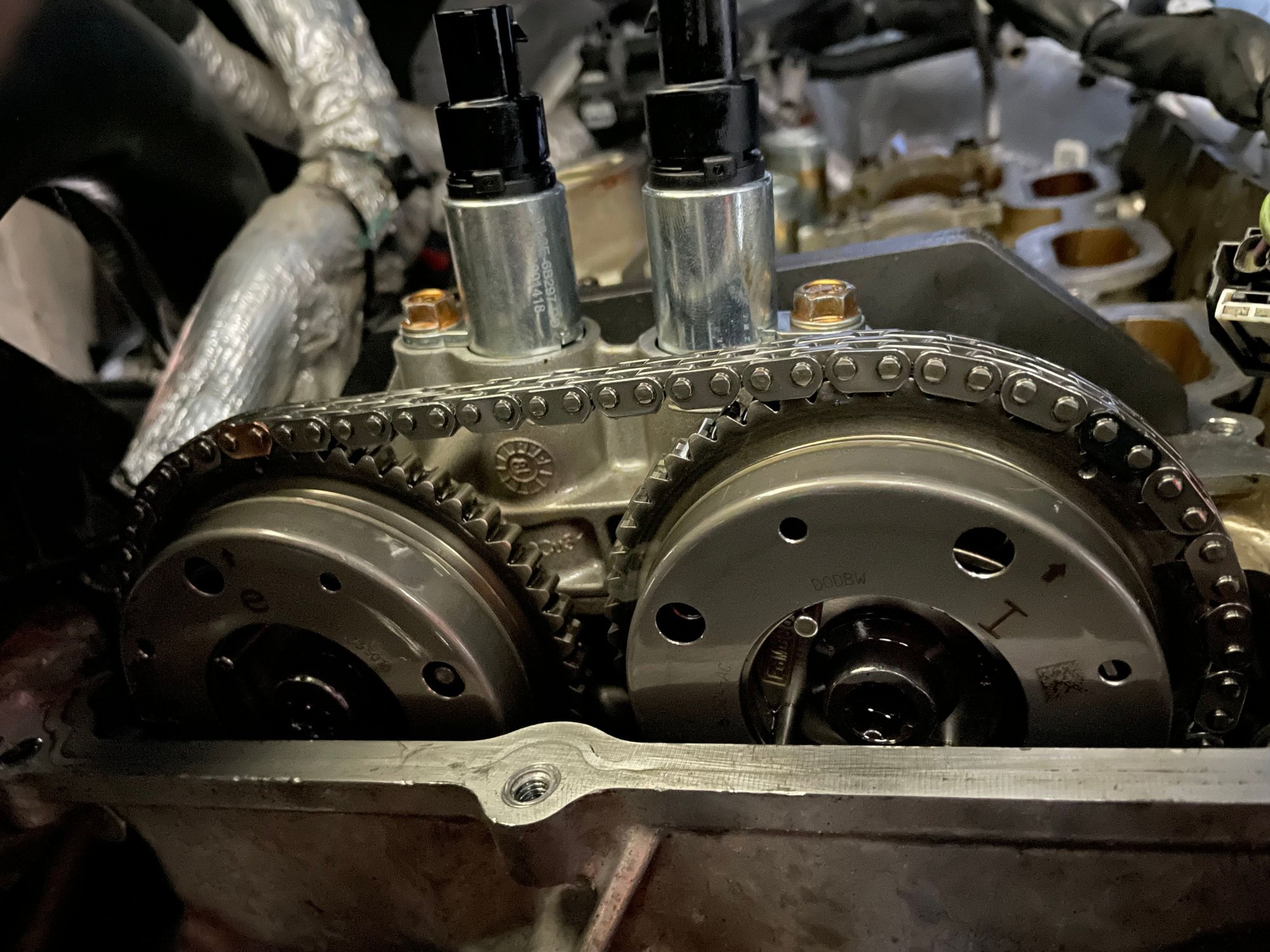

G
Timing marks w/ camshaft locking tool
Good morning FTE, I took the ps valve cover off in order to replace the solenoids, double checked the timing while I am in here and all the marks are checking out 100% where they belong. The customer bought 2 new solenoids and those are what is in the picture, I’m about to reassemble the valve cover and intake and see what these will do. I’m hoping it will fix it, if not he has a shop about 10 minutes from here that he is going to take it to with a retired ford mechanic that works there part time that said he will look at it. I’ll keep everyone posted as soon as I get it back together.

The filter they mentioned is the small mesh screen inside the VCT solenoid bore on the head itself. It sits in the oil passage before the solenoid. On high-mileage engines these get clogged with sludge and restrict oil flow to the phaser even when the solenoid is working fine. With 183k miles that is a real possibility. Remove the solenoid and inspect the screen in the port. Clean or replace it if it looks gunked. That alone has fixed similar VCT issues on high-mileage 3.5s when everything else checked out.

Got it all put back together after checking the solenoid bores and replacing the solenoids and still p0017, even after pulling the terminals on the battery and connecting them together. I don’t understand this truck, literally everything is where it’s suppose to be, everything is brand new, and everything is checking out on it like it’s suppose to be. This truck just doesn’t want to run correctly. Either I’m missing something or overlooking something or I’m just not good at fixing this truck. I’m 95% sure I won’t have the ability to fix this thing. I’m going to let the customer know so he can take it to the shop. It’s frustrating because this is the very first truck ever I can’t figure out and fix.
