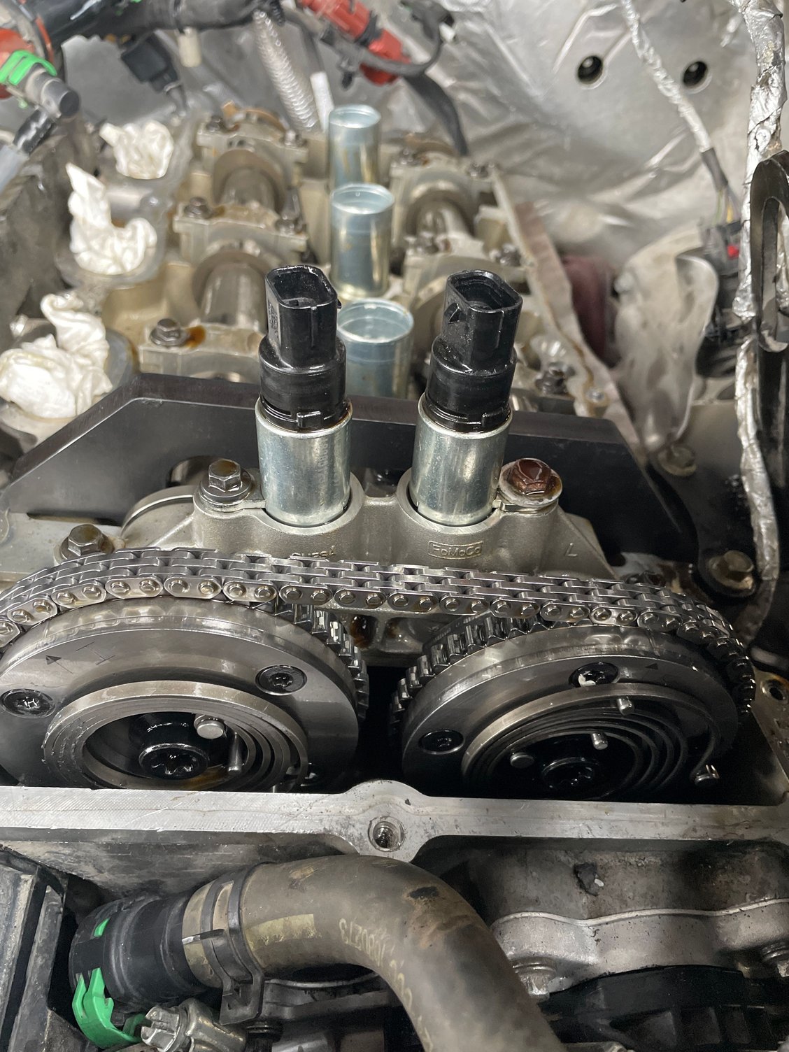

This is right this second with the valve cover off and the camshafts locked in place with the holding tool
Camshafts with holding tool

Are your holding tools correct? I saw a video of the aftermarket holding the cams out of place by just a little causing timing issues on assembly.

Yes these are the correct timing tools, they are the ones the dealership recommended for me to use. Yes if you are not experienced with these don’t, I repeat don’t do it. As soon as I figure it out I’ll post back here. I do however think I’ll have to replace the cam phaser that’s now malfunctioning so I’ll be reopening the front end of the engine in order to fix it but that’ll be after I have the parts on hand because I’ll have to replace the tensioners again since I’ll be unbolting them.

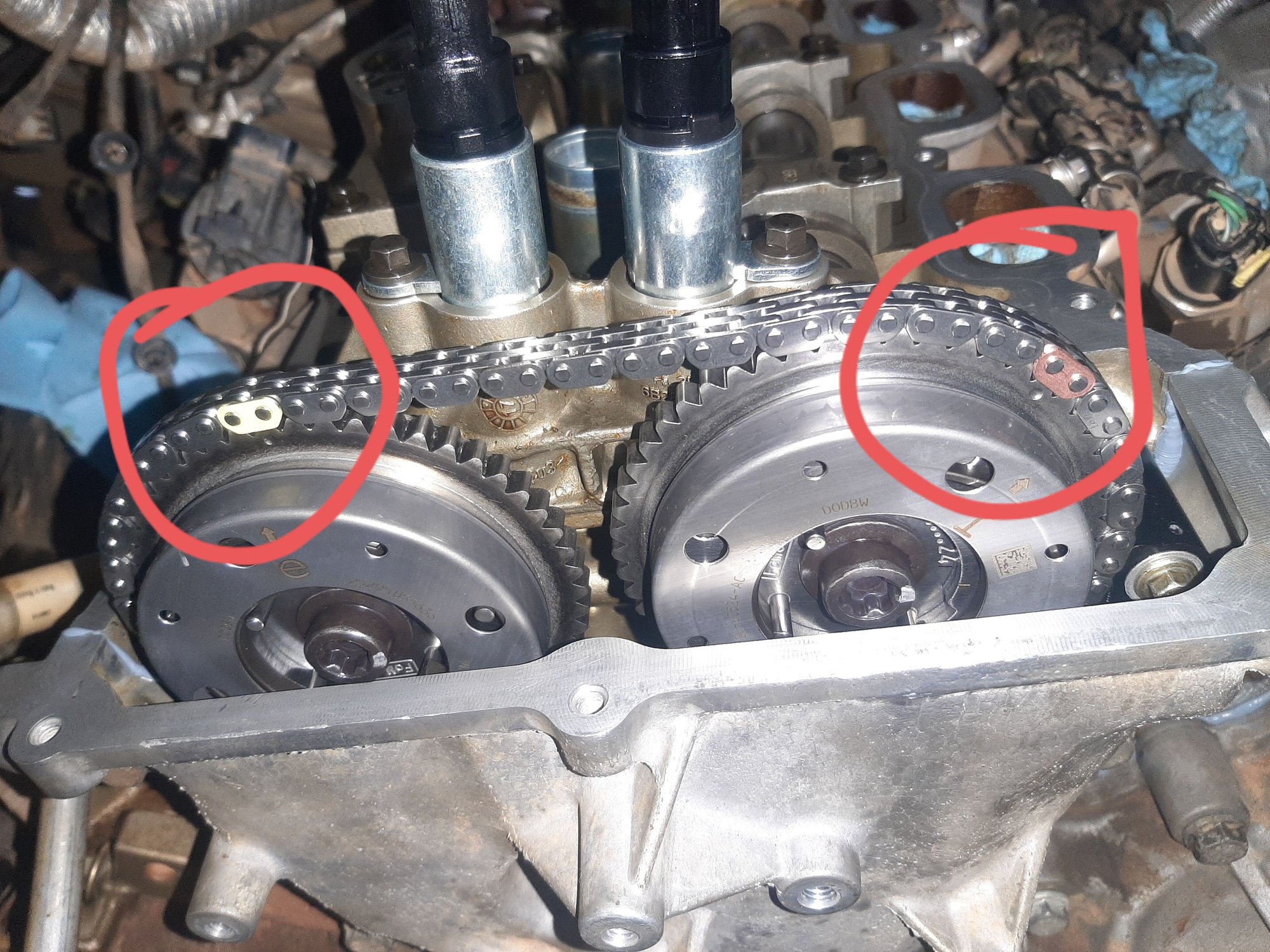

Those phasers are the old style.. I would recommend the new style like in the picture I posted..... Also your tensioners can be reused..They can be put in a vise and the holding pin reinstalled... Or you can replace again. Up to you.
