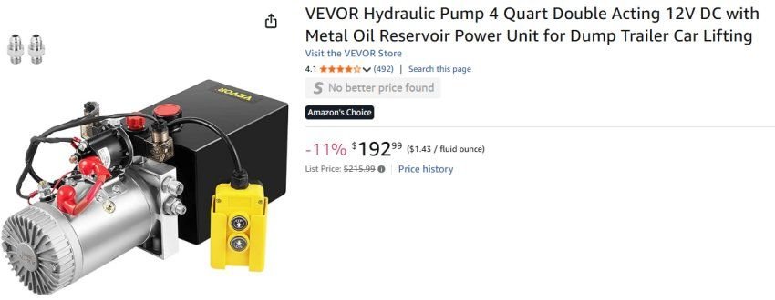

I don't know much about hydraulics so I'm hoping there might be someone from the FTE brain trust that can offer some of their hydrualic expertise. Can I use the stock hydraulic cylinder that comes on the trailer? Can I just add a hydraulic pump?

I was hoping I could use the cylinder it came with and then use something like this to power the cylinder. Again, I don't know if this would work and don't want to use trial and error. It's no big deal, I and live with the manual lift system as it but it would be nice to have.

No, that will not work. It includes a hydraulic JACk, not a cylinder, If what you pictured is correct. If that is the case your stuck pumping it up by hand. You would need a true hydraulic cylinder to use that electric hydraulic pump you pictured. If your tow pig has onboard air you could swap that cylinder with an air over hydraulic jack from Harbor Freight for about $180 bucks.

I could help you put a system together for a lot less than $1000 using the pump you listed.

Yeah that pump is cheap compared to what I have seen and used. If you can get a generic cylinder, hoses and whatever else needed at bargain prices like that it's worth a look for sure.

Would you use the hydraulic unit I posted from Amazon? I have farm supply store around here I can get hydraulic rams and hoses.

that cylinder wont work for that application, you can use that hydraulic power pack that`s shown, measure the existing cylinder pin to pin closed and all the way out, you should be able to get a cylinder from tractor supply with those dimentions with a 3.5 to 4`` bore,get fittings, a few lines from the cylinder to the power pack and you should be ready to roll

and if you want, you can buy a wireless remote on amazon, then you can drive and lift/lower on the go

Bob, yes that power unit you pictured should be fine. The cylinder could be procured at several places like a farm supply, but I recently replaced a cylinder on a lift table at a mortuary that I ordered online. Even after shipping, I saved a lot of money. Hoses can be made at several places, O'Reilly and Napa are just two places , but there are several. Hose can be made with several different fitting ends so that no additional fittings would be needed.
if that is the way you want go, H and H may even swap out the jack cylinder for the lift cylinder which.you could plumb yourself with that pump and save a bunch. Don't forget you would also need a box for a battery, the hydraulic pump and ideally some type of charger/maintainer for the battery (most use a solar panel). It all adds up but when you doing it you save money.
