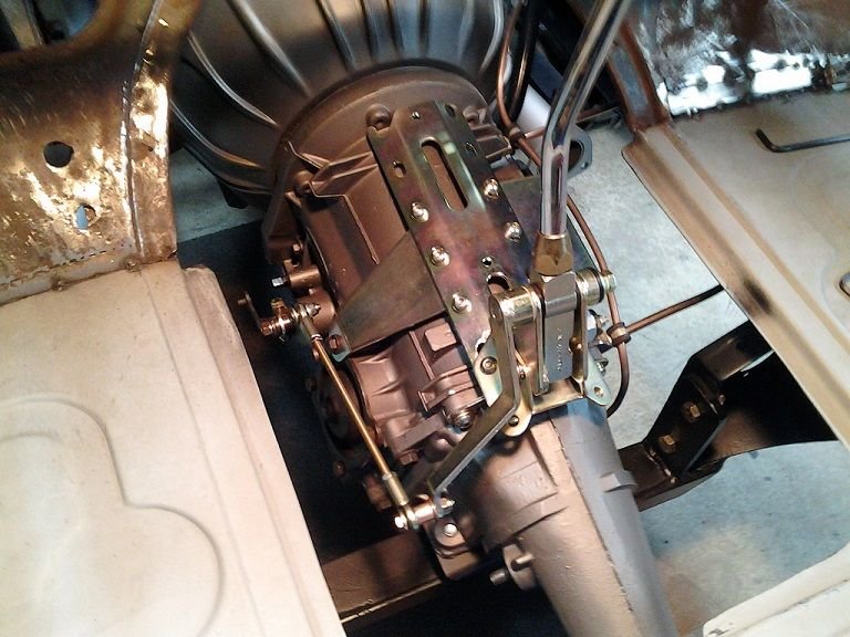

My friend is putting together a '54 pickup with a 351 and a C4. I'm wondering if anyone can recommend a particular shifter for the c4. Today he told me he'd like to see it sit at the top center of the tunnel.so it works nicely with the narrow bucket seats he has in mind. Here's a picture too. I'm assuming one of those connections is for downshifting and the other is for the shifter. Looks like something might be missing too. Sorry about the picture. After about 20 tries to get it flipped clockwise and shrunk in size, I just concede that even simple technology kicks my butt 100% of the time. Sorry.
Any suggestions for a shifter would be appreciated.

The upper lever(left in your photo) is the shift lever. The other lever is the kick down lever for dropping into second when cruising and you need some RPMs and power, e.g. like passing someone. Other than the clips for the levers it looks intact.
There is also usually a neutral safety/reverse switch mounted on the shaft between the levers.
There are several brands and option for a floor mounted shifter, he just needs to look at several and pick one he likes.
