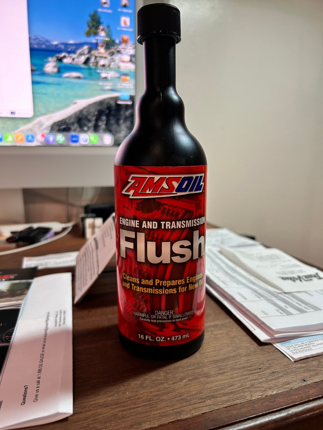

I fit up the gauges today. installed on A post, not sure how that is going to work so close to my face at night, I guess we will see. have to connect sensors and power to the gauges this weekend.
About the oil flush, you dump a bottle of that into the oil fill and idle the engine for 10 to 15 then drain immediately. it is supposed to thin the oil out and clean build up spots in the system. and be able to drain more out due to being a little thinner.

An oil flushing additive... got cha. I believe I once used this from Lube Gard. Now that I am thinking about it, when I switch to 5w40 from the 10w30 I have run for the life of the truck, and since I use Lube Gard products in my transmission, I'm now thinking I will buy a bottle and do a flush on the last 10w30 oil change.

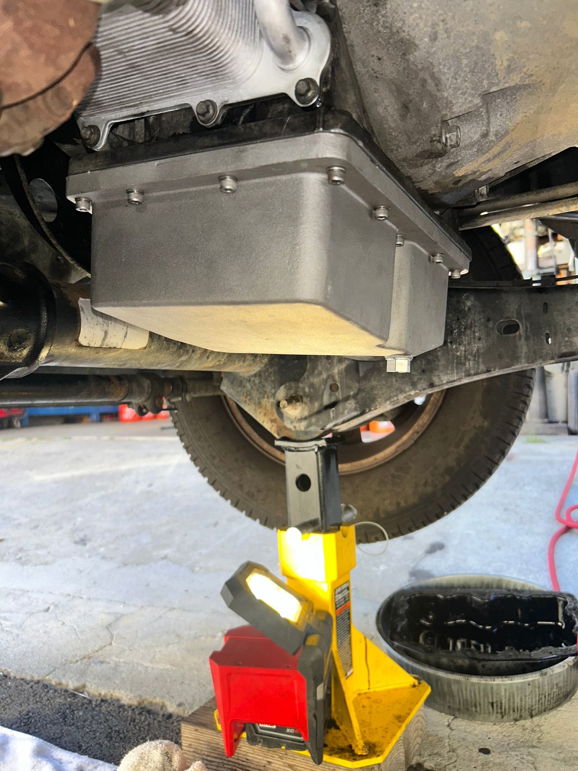

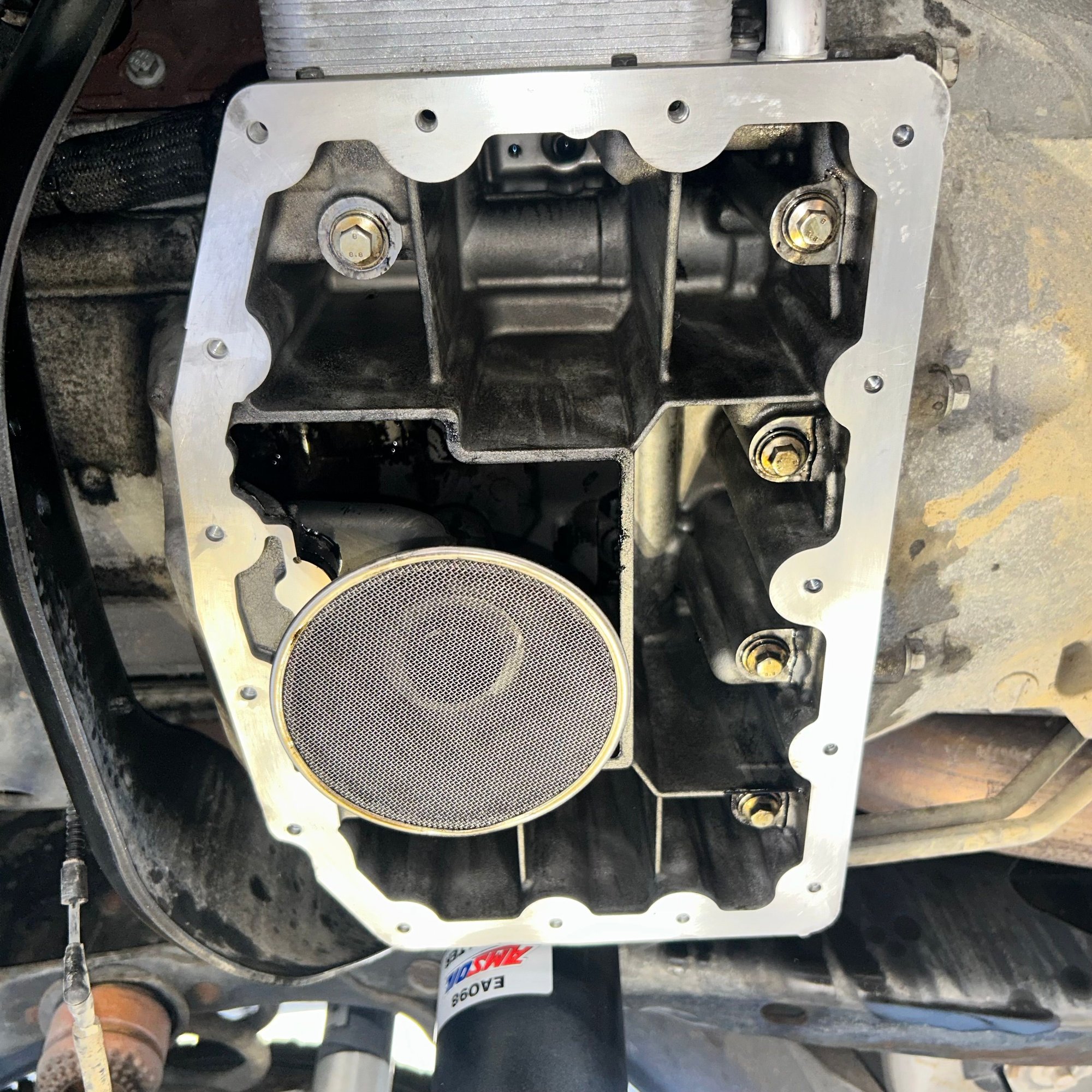

SPE oil cooler in, had to obtain the new O ring seals from Ford as SPE does not have them yet but are working on it. Installed SPE oil pan, went ok, make sure to use a plastic trim tool when opening the old oil pan, it was on there pretty good and was tough to get cracked open. Glad I used the plastic trim tools I had because the SPE pan seals with an O ring and any metal putty knifes or chisels would have scared the aluminum upper pan. Just got it started the worked a thin long scraping blade in to cut the existing sealant until I had enough leverage to pull it all the way off.

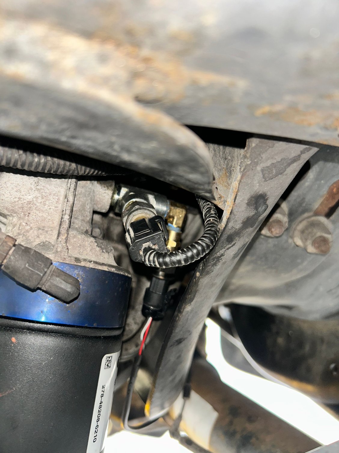

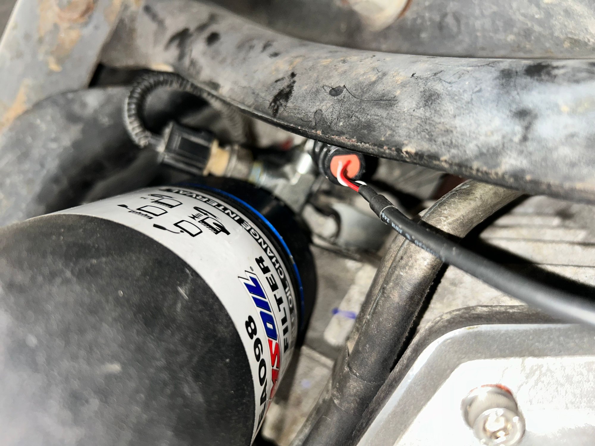

Installed the MAX Tow oil pressure sensor, used the 1/4 tee you suggested however there was not enough room because of the cross member. I added a 1/4 x 1/8 st ell with an 1/8" coupling and turned the sensor downward so it will be accessible with the original sensor turned out board.
Pics to follow,
installing 70 gallon fuel tank today

Appreciate the advice and pics.
I have a Filtration Solutions FS2500 bypass filter installed and it's teed off the oil pressure switch. Moving to an Dieselcraft OC25 centrifugal bypass filter with a custom install behind the grill in front because I di not know WTF happened to Filtration Solutions but they ripped me off for two soin on filters... I checked and I was not the only one. If I would have gone with the Insane Diesel bypass filtration kit as I looked into it as well, I'd be good to go.
