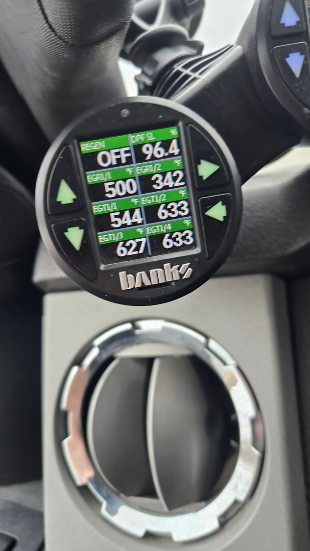

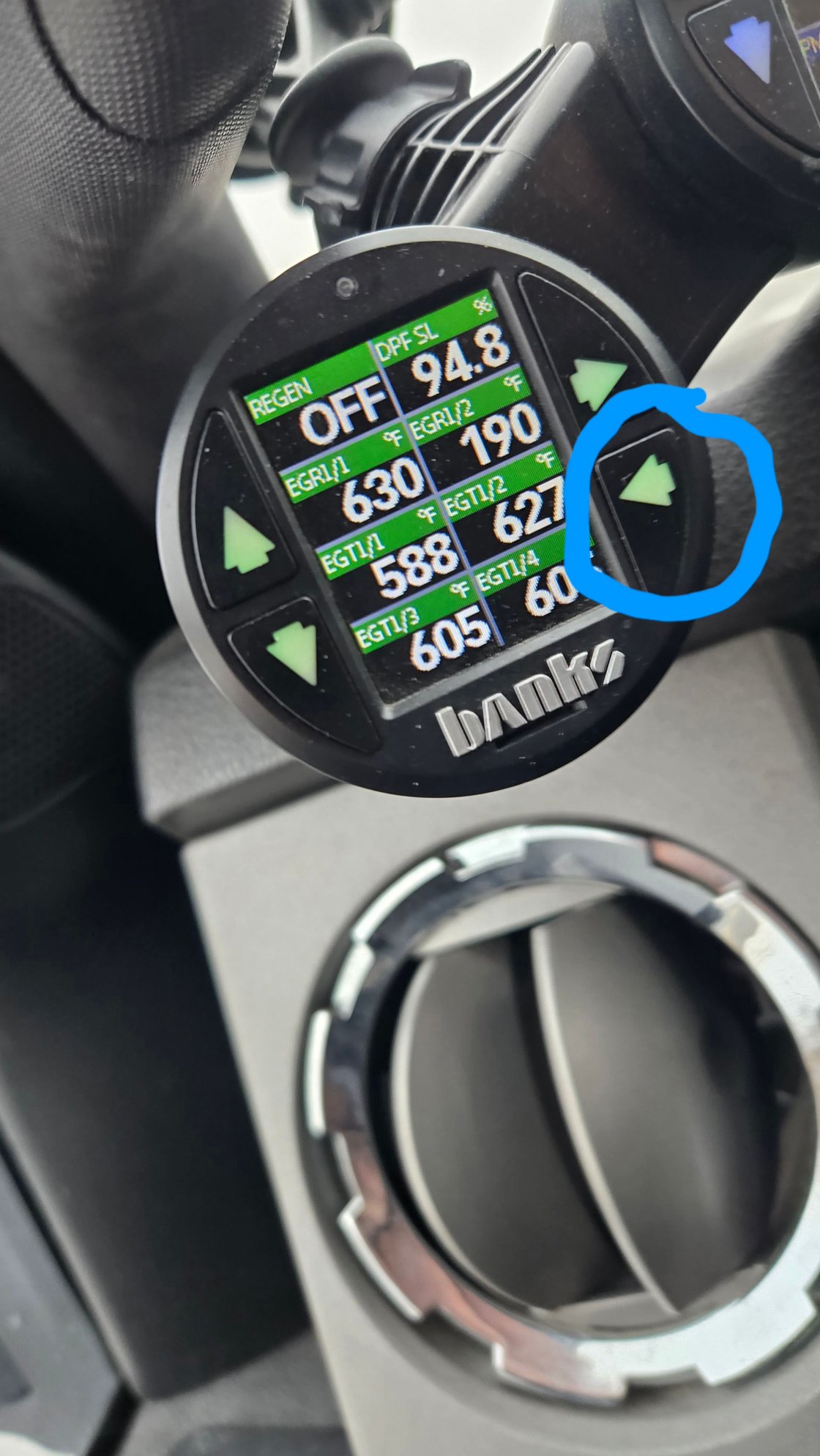

My truck just did an active regen today and took some pics with you in mind.. ambient air temp was 31 to 32 degrees.
This is the screen I have set up for active regens... the 3rd and 4th spots are pre EGR cooler and post cooler; the last four are the EGT sensors 1 through 4.
Pre regen on the 65 mph expressway I drive everyday... heading south as altitude climbs.

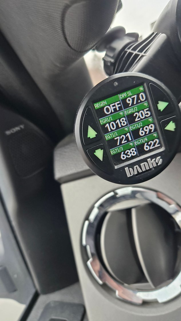

Now climbing the hills and getting warmer...
Now in the flats on top of the hills....
Going downhill... I believe I was driving 75 and with strong winds which is the norm for here in WNY...

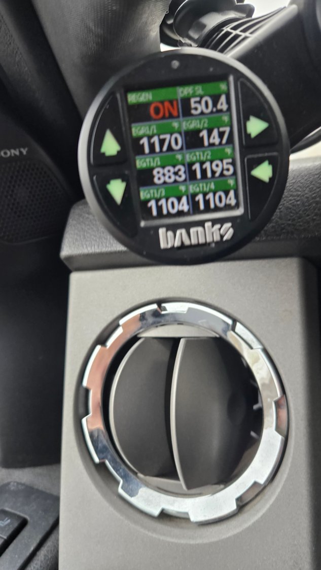

During the regen...
Climbing again... getting hot.
After regen and still on expressway... cooling off. Dash ended up at 35% and EGT4 stayed in the 1k to almost 1.1k degrees after it shut off, so soot load passively burned down to 30% before it cooled off too much...
At home... iDash soot load ended up at 4.9%... This regen went out about 330 miles or so, would have happened sooner but when I'm driving the expressway it gets hot and prolongs it...
The left upper slot which is DPFDIS or average distance between regens, is at 644 miles... I wish! The last one was 518 miles out, a personal best for my truck. Then there's the next at 300 some miles... go figure...
I also use additives as well...

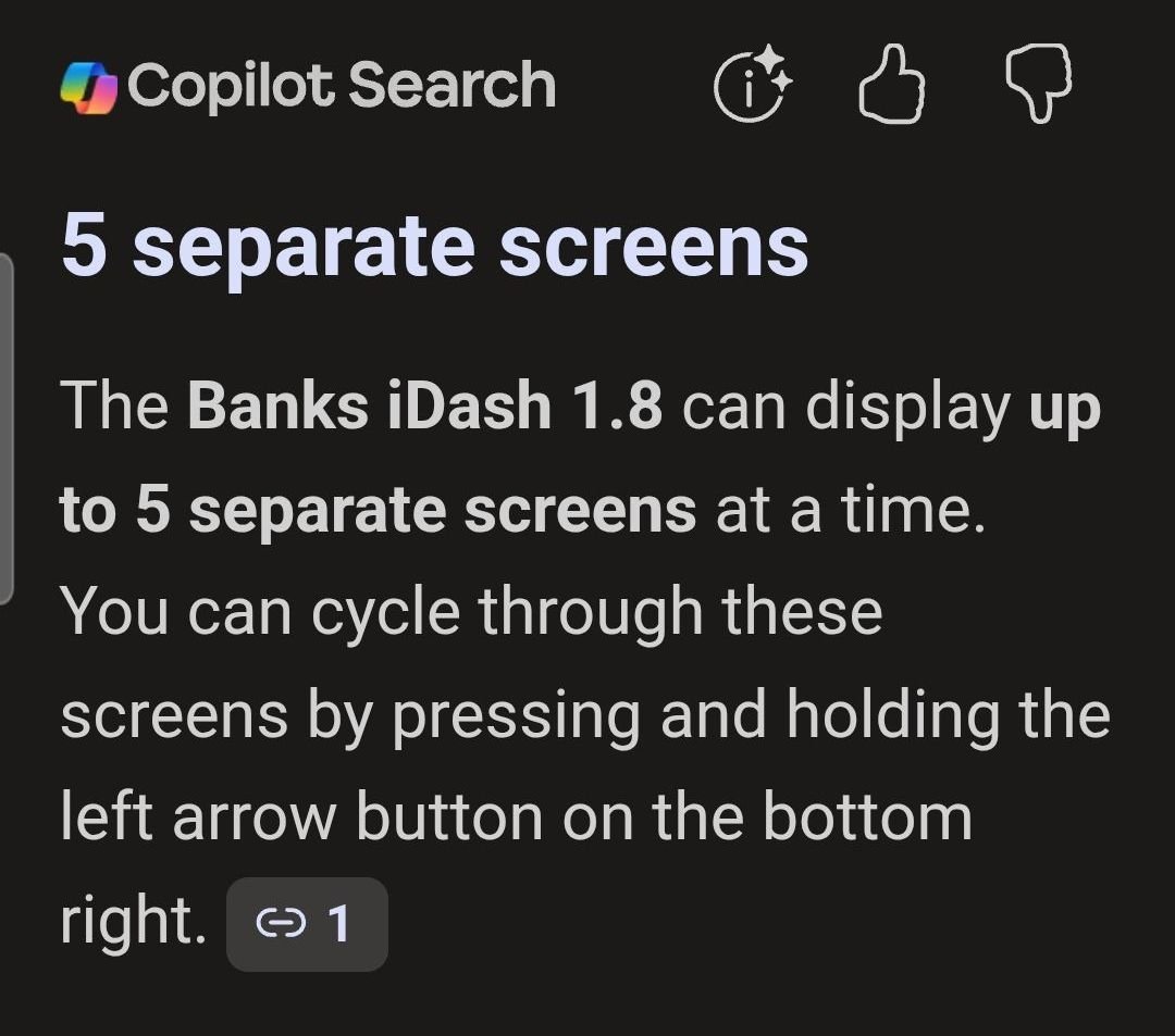

You can display up to 8 PIDs on one screen at one time, BUT, you set up multiple pages which you would have to press the back button, circled in blue, to go to the next screen set up.
