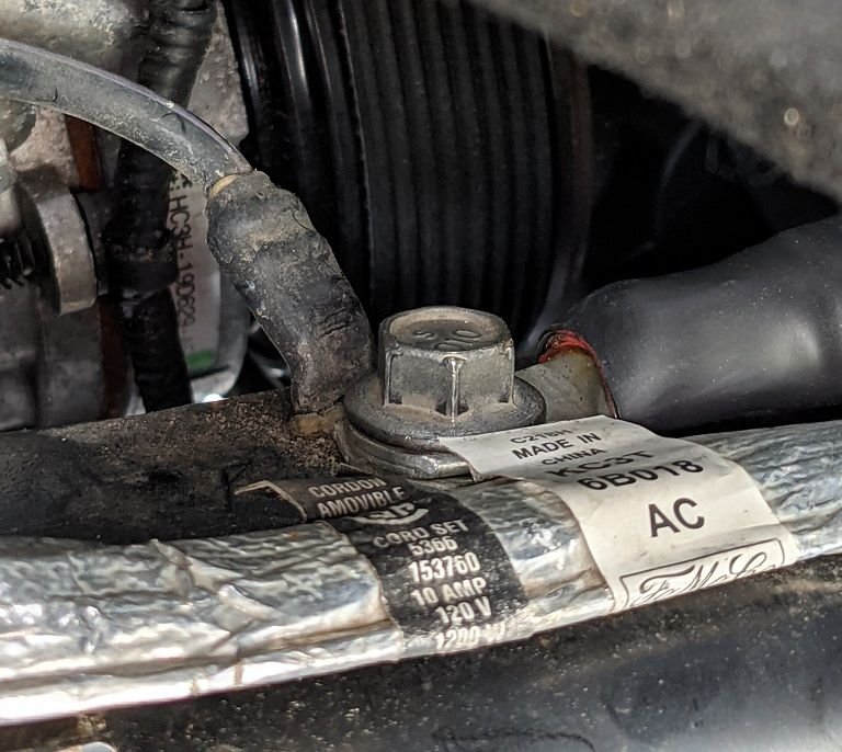

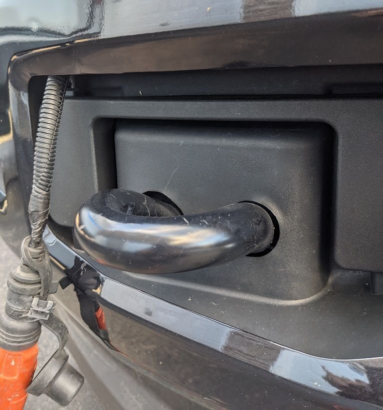

It is located up behind the steel on the top of the bumper on the passenger side. It's a crappy clip that doesn't hold on well enough to actually use the plug without it popping free and hanging down, like you see here:
If you look in the wheel opening on the passenger side, you can see the ground connection for the passenger side battery, located on top of the frame. The block heater wiring harness is right alongside that ground:
