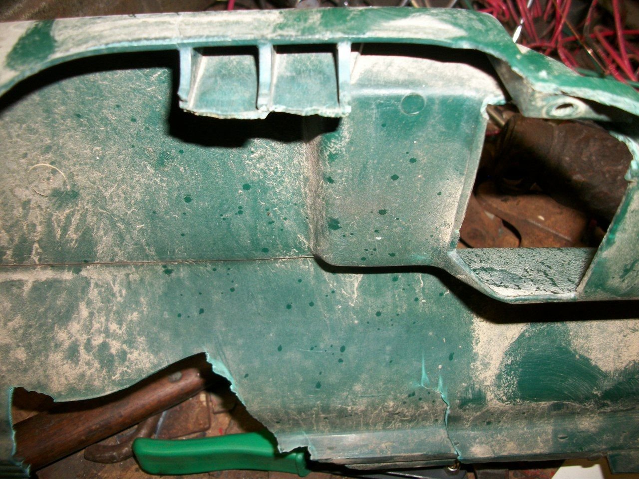

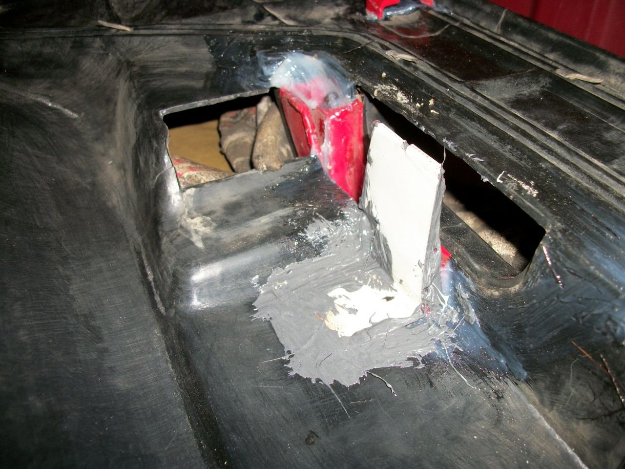

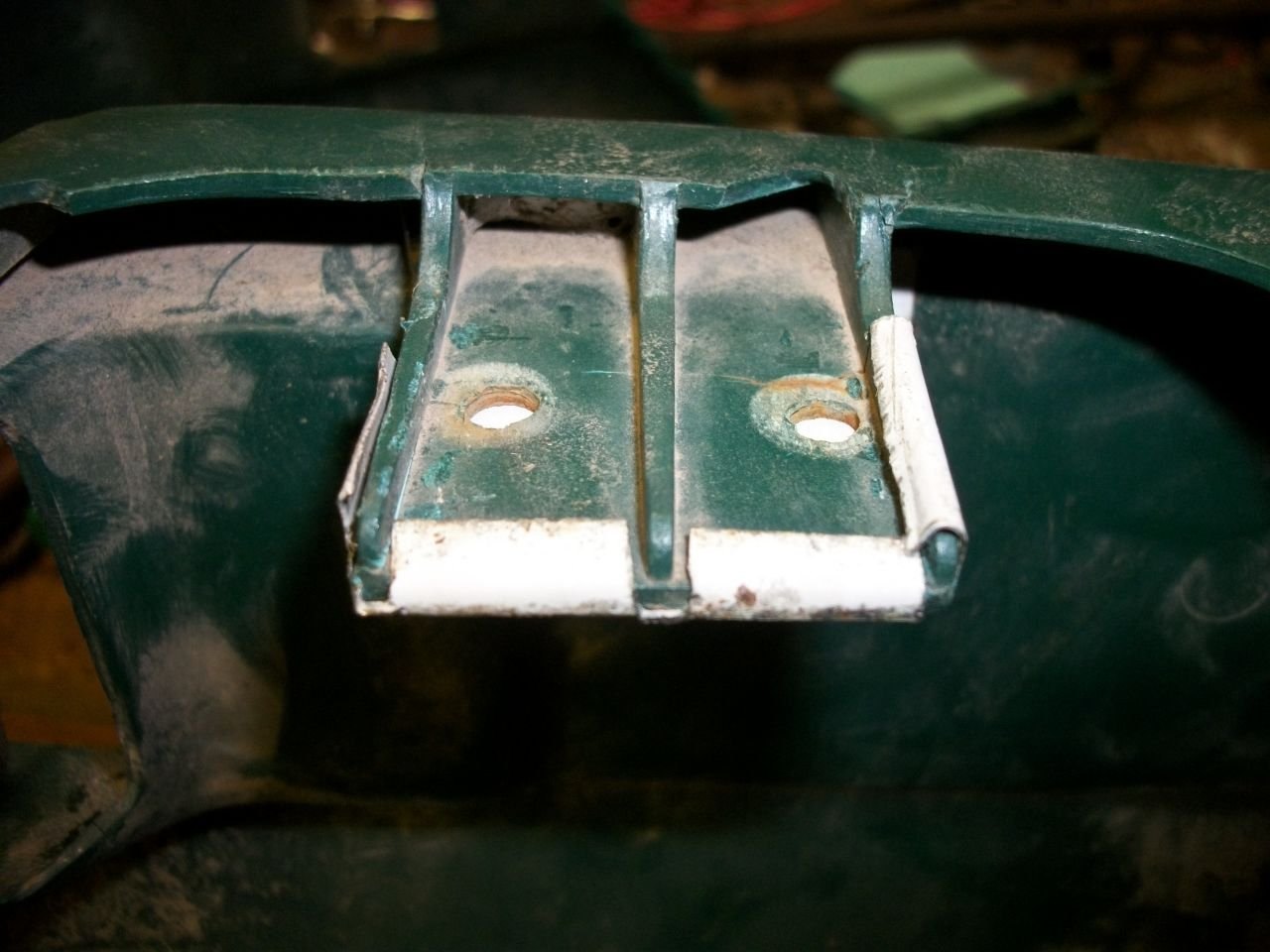

You can over lay that area with some thing sheet metal (white part) reinforcement. And secure accordingly, JB weld.
See the 2 notches? That helps the panel clear the 2 bolts of the door handle L bracket. And attach the panel closer to the inner door skin. The arm rest covers that area anyway.
Remove the arm rest, dremetl knotch and then put arm rest back on.
The sheet metal trick helps reinforce the the tab below the finger cup and that area takes all the force of a hard door closer/slammer. Below the end of thb was broke. I was experimenting with a busted to hell panel and making a set of metal reinforcement piece for a FTE member.
Yes I should or made the metal wrap around the L/H part also, like the right side.
