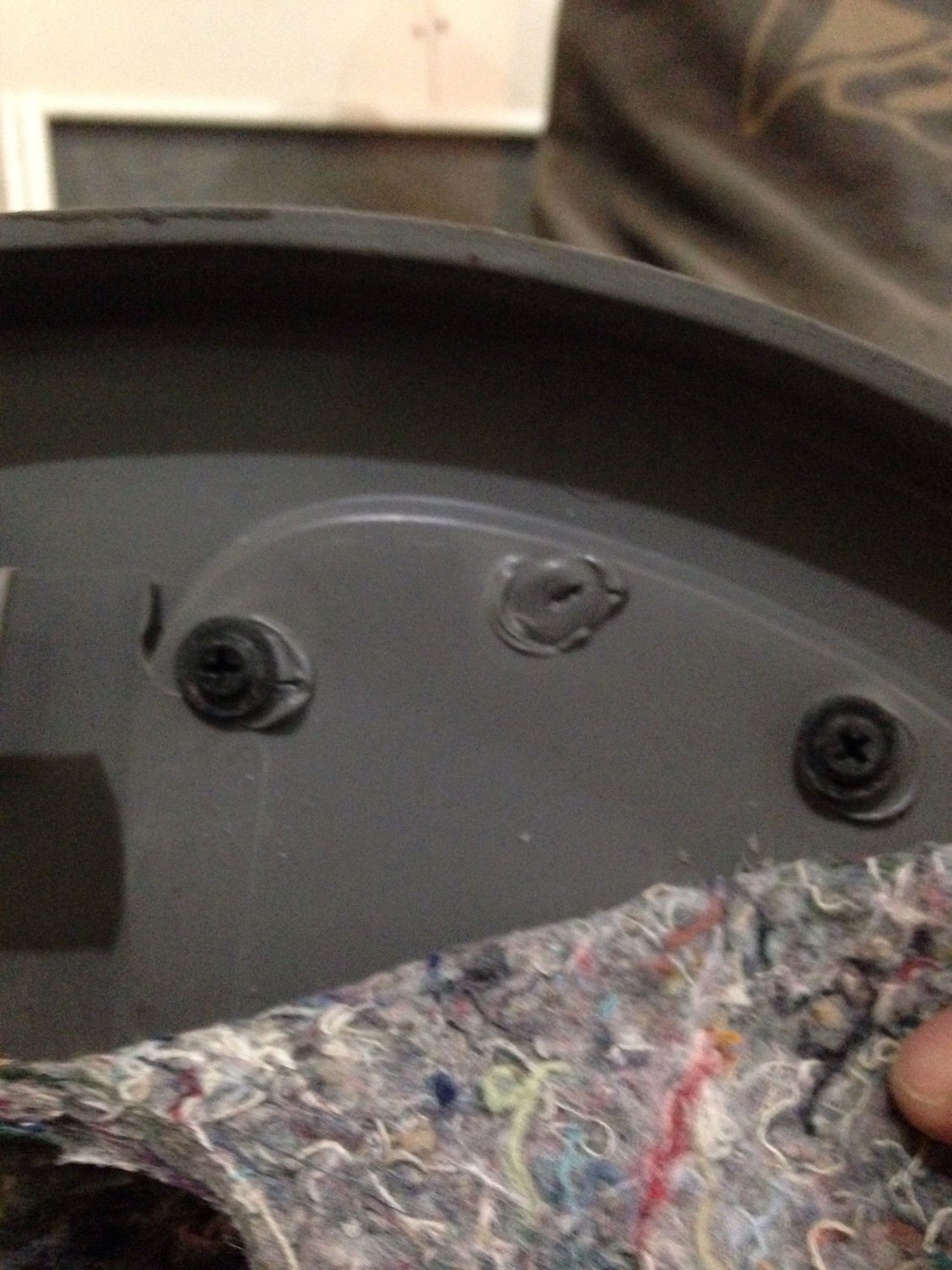

Has anyone repaired the door panel pocket mine is almost completely broke except for the last two studs hanging on.
My original thought was just to run some screws in but now that I have it off I don't think there's enough meat to hold, that is if they don't bulge or come thru the face.

I used screws and glue on my Excursion but I only had three that had broken off. So far its holding.

I used screws like this for all the broken ones and every other where it was still attached a little hairy drilling but ok 1/8 bit and #6 screws
