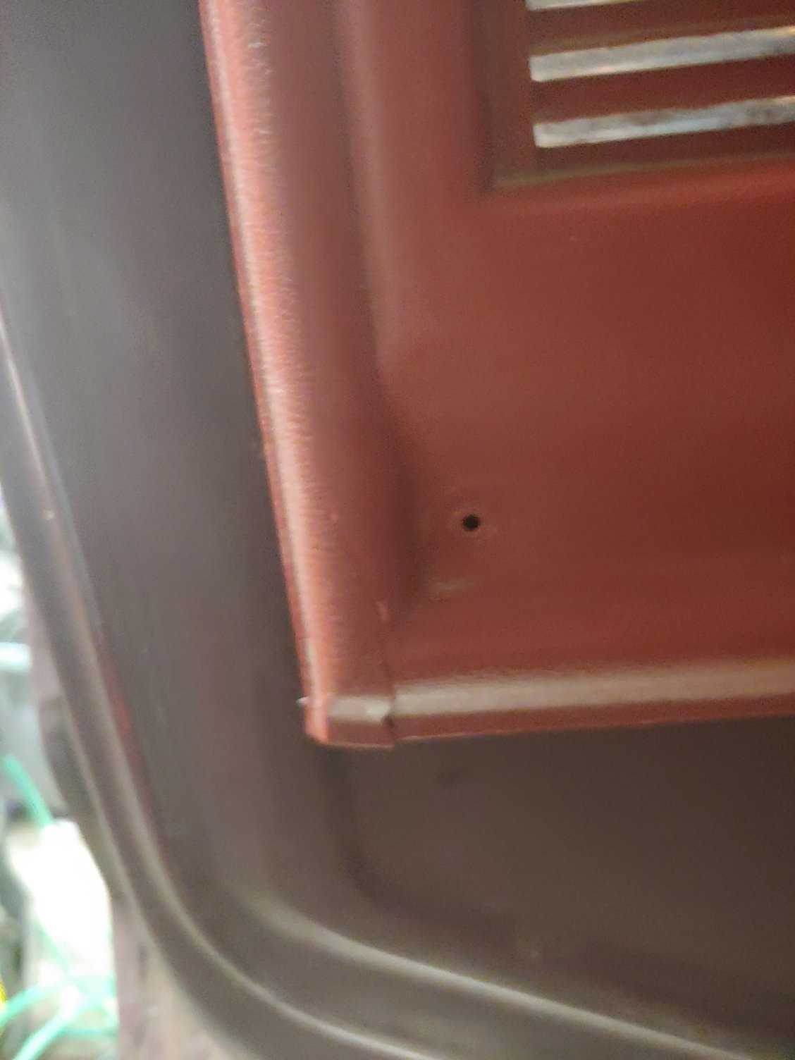

Hey guys I recently picked up a pile of parts which included a decent set of lariat door panels.
I noticed they have 4 screw holes at four corners but i am having a hard time telling if this was a factory hole or not. Does anyone know if this is how they were mounted along with the clips on the back of the panel or is this a modification?

You mean the overlay panel correct? No door panel itself (Lariat or otherwise) was ever mounted to the door from the factory (AFAIK) with screws. The were mounted to the door with the metal double 90* door clips. Now the Lariat/vinyl overlay panel is mounted to the door panel itself with plastic studs thru the door panel and then a small metal washer is pressed on that plastic stud. Here are some of the Lariat door panel options. More to follow.

So judging by the pictures they dont look like factory holes. So much for perfect.

Yes that is the dreaded "I can't get my door panels to stay on the right way, so lets just ruin them and throw some sheet metal screws in them" move.....

Yeah i was afraid that would be the case. Fortunately the passenger side is not as creatively modified and my truck is not a looker so I will live with it.

You can fill the lower holes with JB weld or paintable 2 part epoxy from the back side, dremel sand off what comes thru and paint marker it. Maybe the same for the upper just fill the hole in the vinyl and use a white paint marker?
