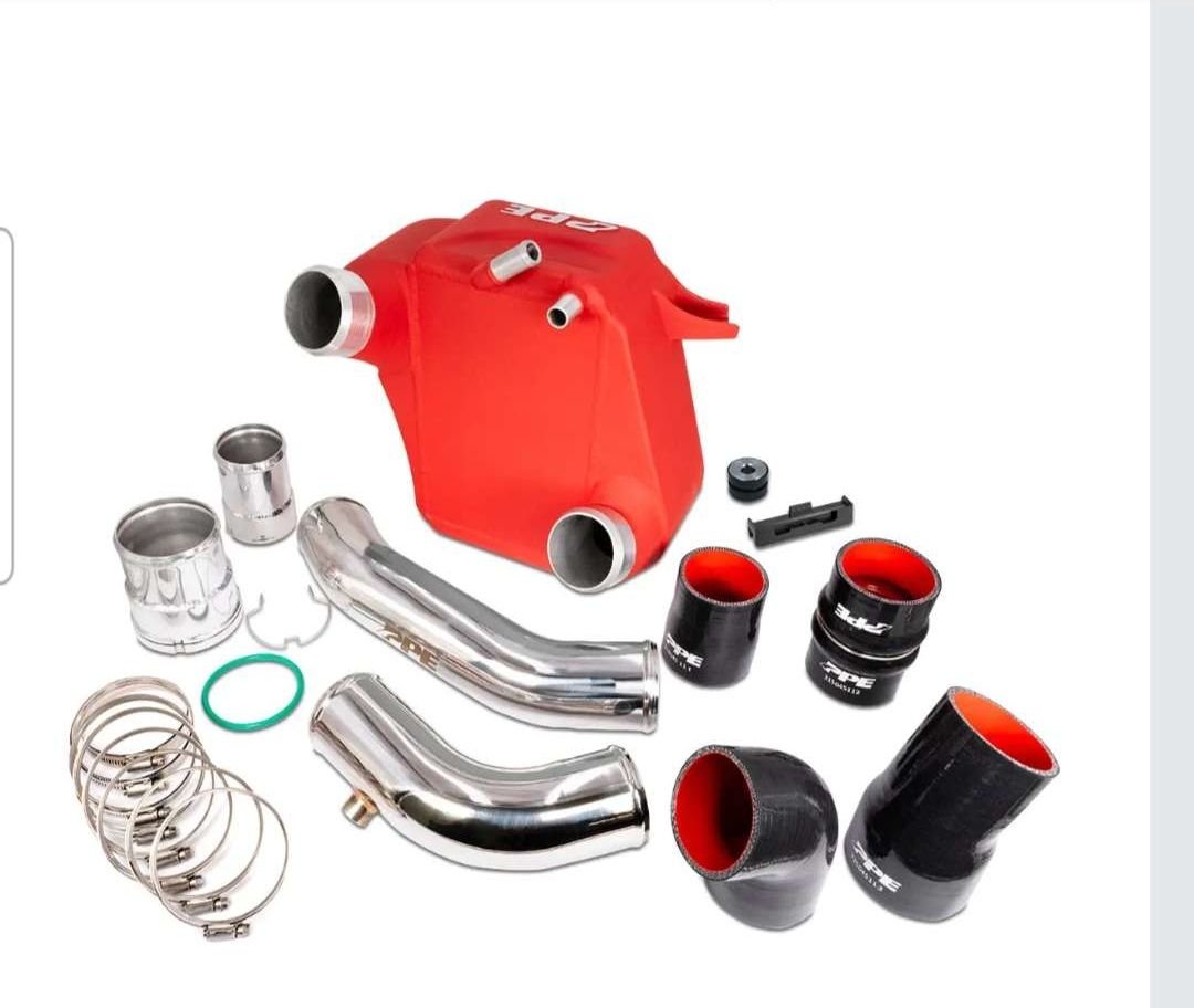

Intercooler - Aftermarket
I searched through the threads, didn't find one directly related to question. If there is, let me know and I'l move and delete this one.
Looking at the wide arrary of OEM replacement Air to Water Intercooler.
Don't have a direct "need", more of a desire without justification.
That said, I've been looking at the various Intercooler options.
PPE, No LImit, Mishimoto, SPE to list a few of the major players.
The SPE states a unique type of core that works better in normal ambient air.
No Limit & PPE seem to use similar core.
I agree with the fundamentals: you have to have pressure drop and a amount of physical time to cool the air.
As flow is greatly increased, this normally indicates physical time to cool (absorb heat) from Charged Air is reduced.
It's suggested that OEM IC probably cools the best, but also the more restrictive
SPE states it approaches OEM IC Cold side Temps, much better flow throughput and not as much pressure drop.
I've leaned toward No Limit, although some posts indicate both No Limit and PPE sharply decline in any gains as temps increase.
There's a significant price difference for the SPE vs other brands... essentially double.
Any of you played with the 3rd Party Intercoolers?

I have watched / read on the PPE, the PPE seems to have obtained the highest YouTube advertising, many YouTubers have highlighted it.
It's definitely best bang for buck with the charge pipes included. I did communicate with NoLimit and they indicated the PPE was a copy cat of their IC.
No Limit and PPE appear to advertise the same "core" type, whereas SPE indicates a core designed for maximum efficiency for ambient air temps.
I'd like to see better data on all of them vs their own claim statements... that's doubtful.
All my truck items are kinda of a Johnny Cash "One piece at a time" as budget (and Wife) allow. I've already acquired the Pusher Intake, Charge Pipes, and Upper Rad Pipe. All sitting in garage until I add a few more items... one being the Intercooler.
Appearance, the SPE is extremely nice, and construction sounds to be top notch... justifying the cost, but it does have a cost compared to NoLimit & PPE.
The SPE has been the only one to openly state, Cold Air will be slightly (1-4 F) higher than stock. To increase flow, physically shortening time to exchange does equate a higher temp. With larger volume, a lot of higher temp variance can be negated, but it'll still be equal or above. Increased Flow rate and pressure difference provide throttle feel and performance. My communication with all three and a few vendor shops; I get the feeling SPE is more accurate on their claims.
I'm always interested how PPE and other Brands gets a lot of YouTube coverage and SPE is minimal, but produces quality designs and products.
As you and others have stated... do you need SPE design or PSI pressures for street... probably not but it's nice product.
I had hoped to see a few more SPE IC's show up on YouTube, but most are probably like me in that YouTube isn't my thang.
