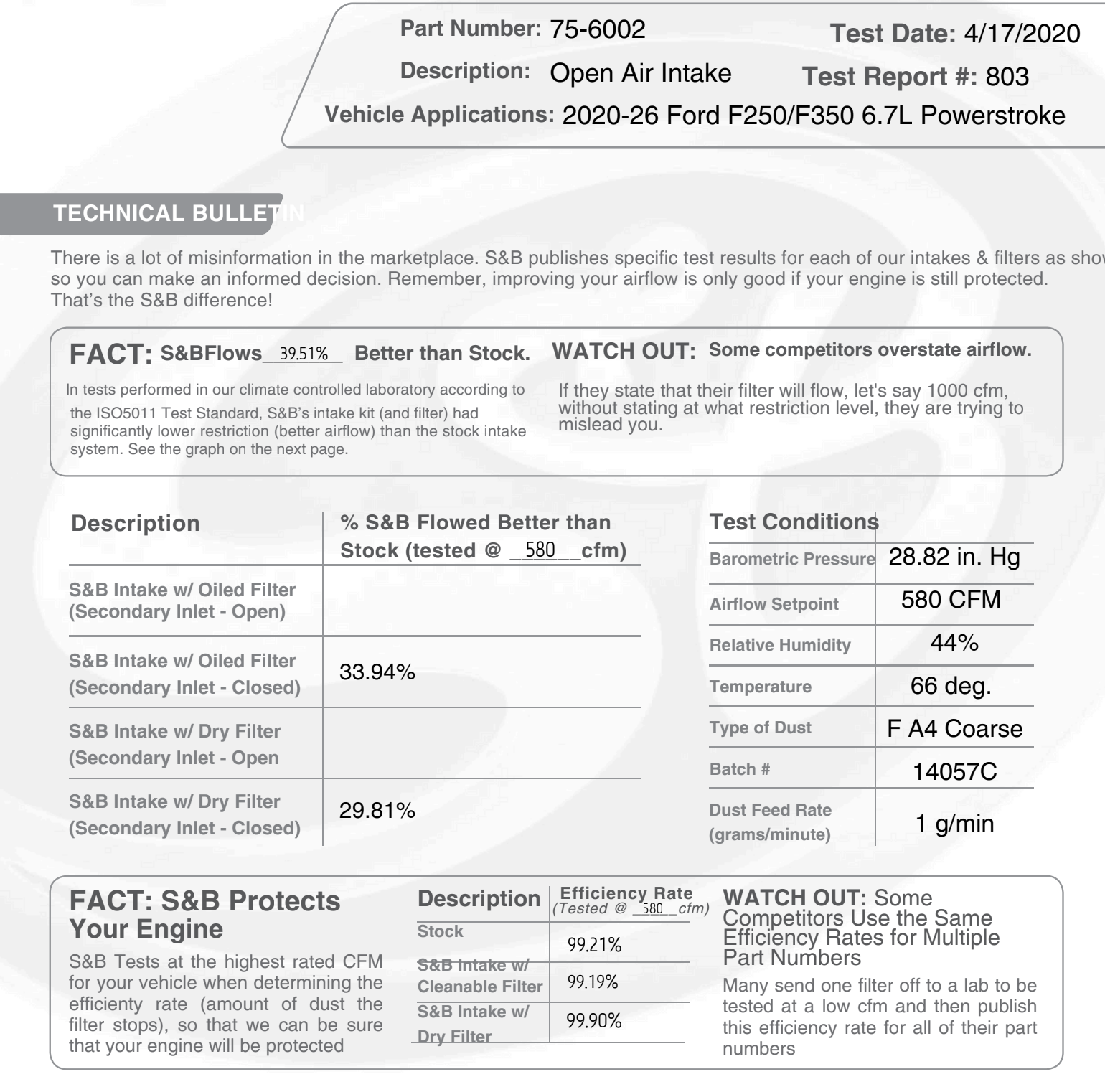

On the efficiency rating... there's some confusion even on S&B site:
Using the ISO5011 Links at the bottom of the advertised CAI.
Using their own ISO5011 Reports on the 6.7 Enclosed CAI filters and the Open Filter...
Closed CAI Unit: Shows Stock @ 99.21%, S&B Wet @ 99.42 and Dry @ 99.54%
Open Filter unit: Stock @ 99.21%, Wet @ 99.19, and Dry 99.90
Efficiency Ratings at the bottom of each page:
Top is new CAI enclosed, bottom is Open CAI.
