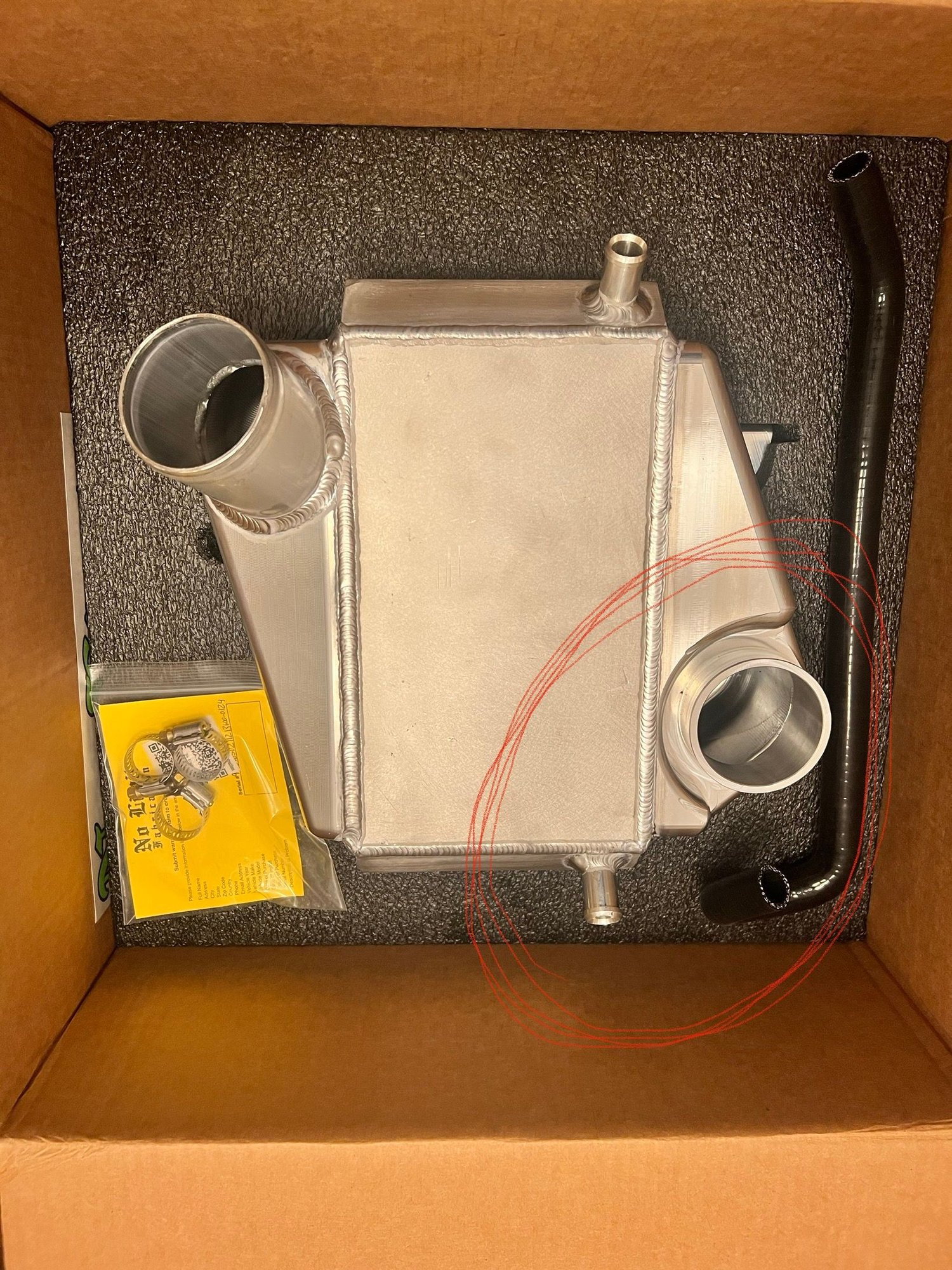

The new no limit fab intercoolers look like this. Note the placement of the bottom nipple and cold pipe (more on this later)

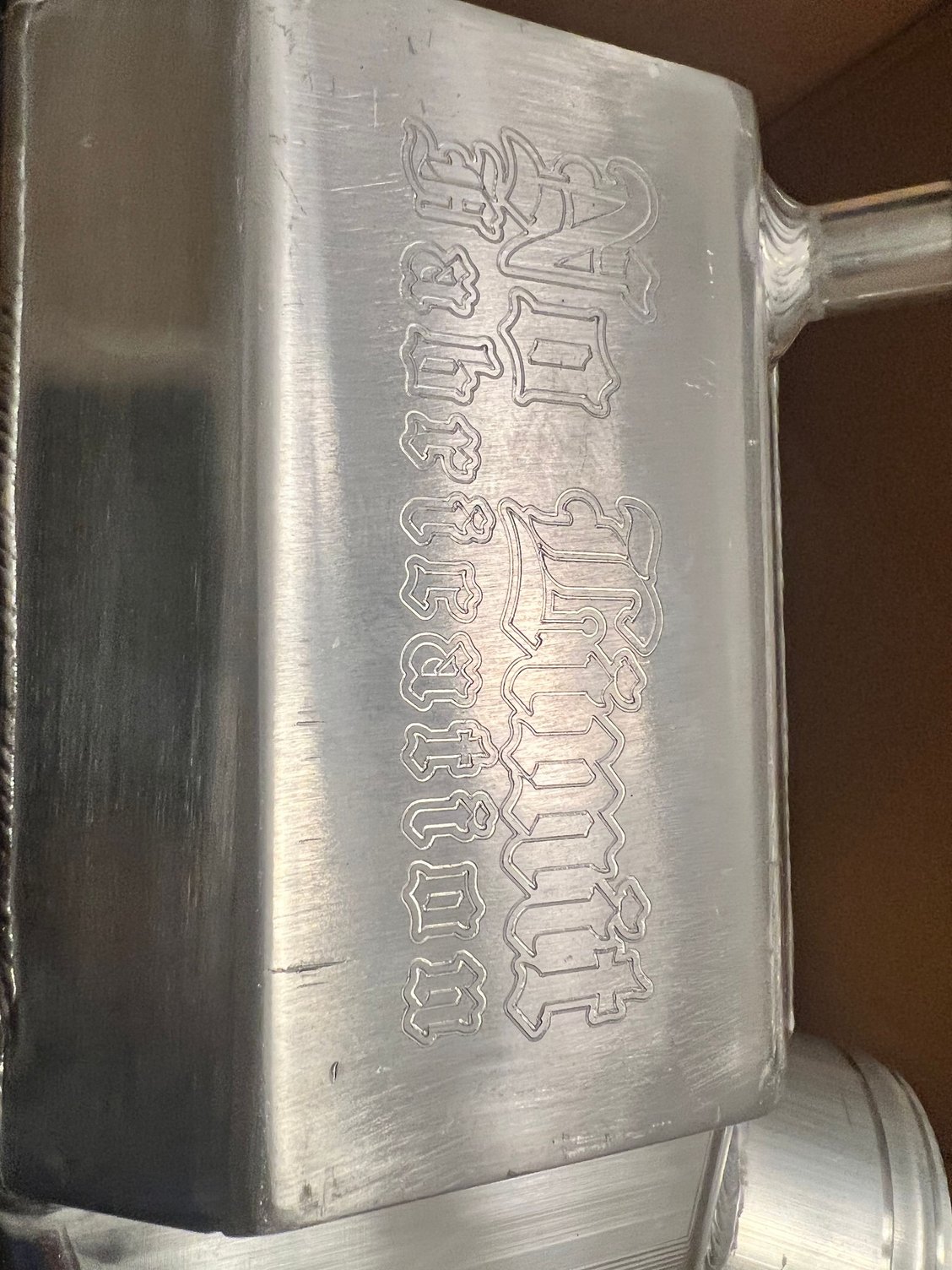

I did like the engraving on top but it was immediately covered up by the radiator hose.

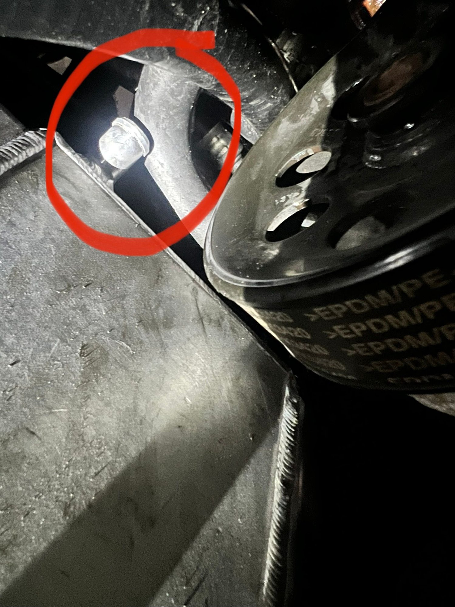

The bottom nipple runs right into the power steering hose which is not very flexible at all.

I went with the no limit fabrication intercooler I found online for $999 at alligator performance. I like the look of it but the install was an absolute pain in the a**. The bottom coolant hose runs right into the power steering hose and you have to really finagle it to even get the hose around it. Then there’s the cold air pipe location that is so far towards the front of the truck that it interfered with the power steering reservoir as well as the other coolant hoses. Getting that on with the clamp seated properly ended with a lot of cursed mothers. I called no limit and they stated that’s how all of the new ones are made and gave me a few tips on the bottom hose that ended up working out. After the install I took it out for a spin to see how it worked and I was pleased with the results. The turbo spools up quicker and I noticed a very mild increase in hp. I am helping a buddy tow a 9k boat from Missouri to Kentucky next weekend so that will be the ultimate test.
