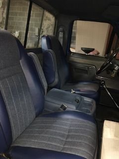

Originally Posted by 95ford4
I want a date night truck...........
I would be more concerned if the truck has a bench seat or not.
For a “date night” truck I agree.
99% of the time I’m by myself so the bench seat had to go
haha yes I’m going to likely swap a king ranch back seat into it. Right now is the Eddie Bauer lumbar seats, they’re pretty nice tho. I’ve got plenty of interior work I want to do, new carpet, blanket headliner, repaint all the tan to brown, etc.
