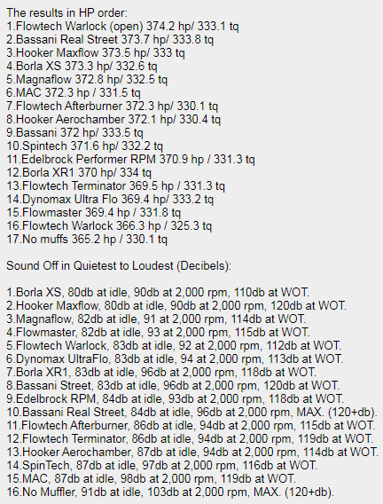

I have BBK coated shorties, I dont hear ping, used db meter to measure sound with cat still installed, stock muffler(77db) at idle, got the new borla pro xs muffler(81db) at idle and no drone cruising, good gaskets and torqued to spec, then ran for a week, then re-torqued the bolts, been 8 months no leaks, if you have stock muffler you barley will tell a sound difference, I dont like loud, never have, I picked the borla for quietness, and came in 4th on hp/tq, in test car craft did
