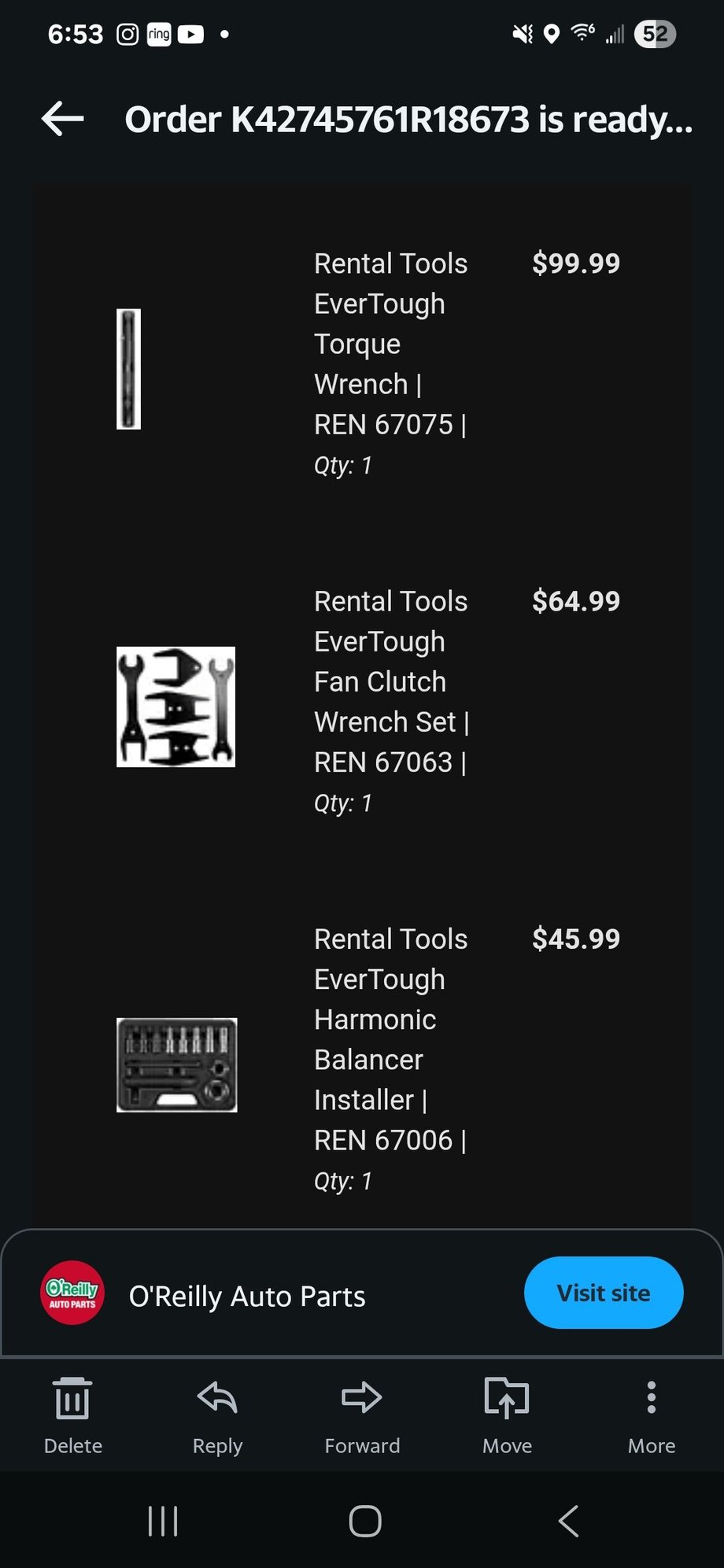

these are the PNs when I rented the tools back in Feb and they had long enough bolts for me. YMMV it appears.
