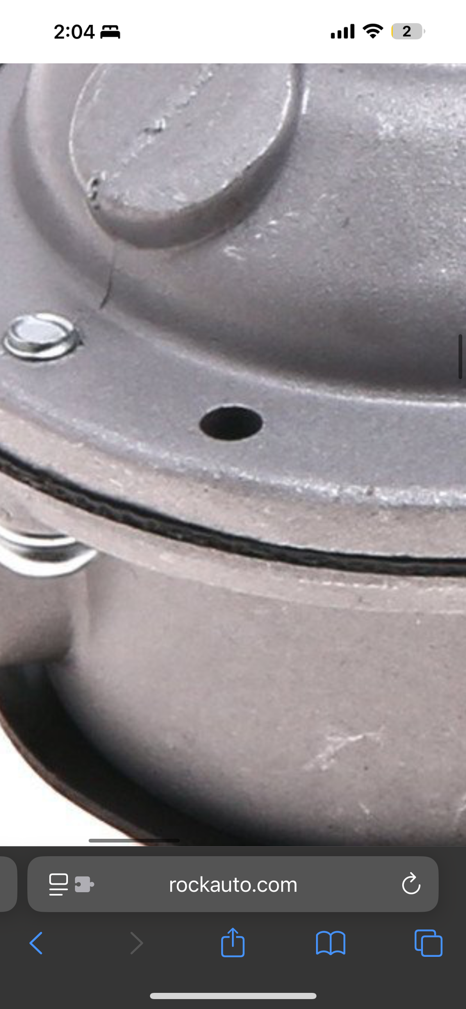

I looked up Alernatives on Rock auto. The pump that is working on my truck now looks like a US Motor works pump. My pump has the same aluminum tab on it. If you look at the diaphragm gasket it is thicker than the Carter one, as is mine. The Carter Oump is $20 on RA and the USMW pump is $38. Maybe the cost difference indicates a higher quality part??
When I get to the Raceway tomorrow I will take pictures of the tag and see if the numbers match by chance.
You may want to keep a spare pump in the truck as well with the tools to do a roadside swap. I just added that to my truck.
US Motorworks pump. Note the aluminum tag and how tick the gasket is along with a cord/fiber reinforcement.
Carter pump. Much thinner gasket and not reinforced.
