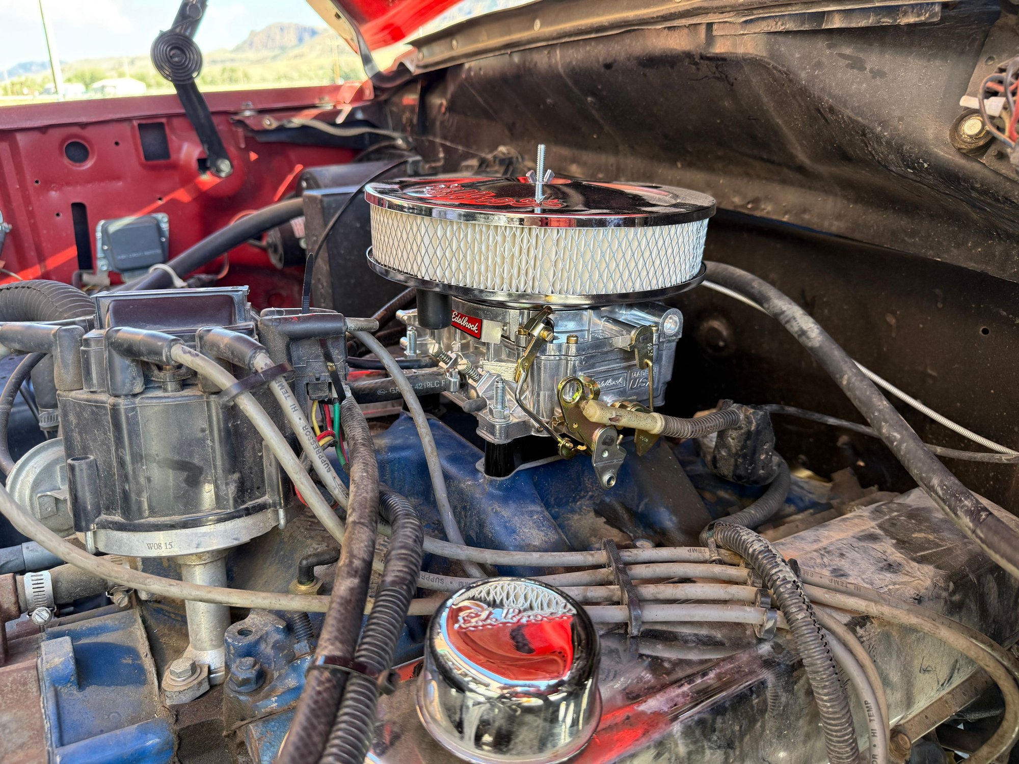

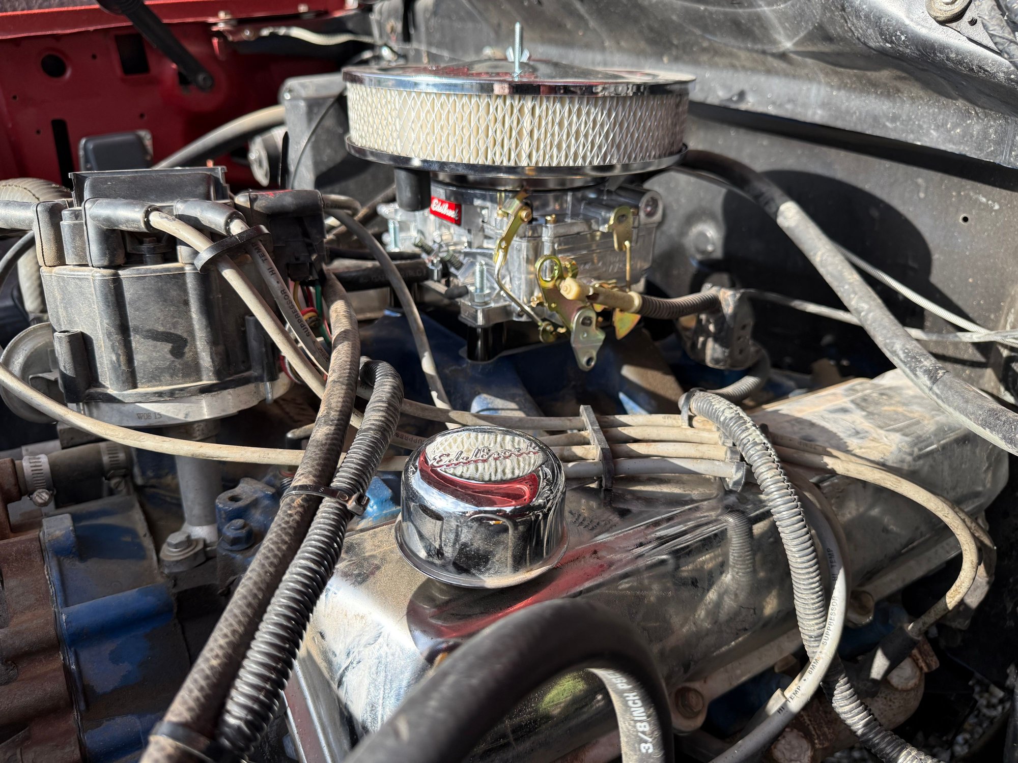

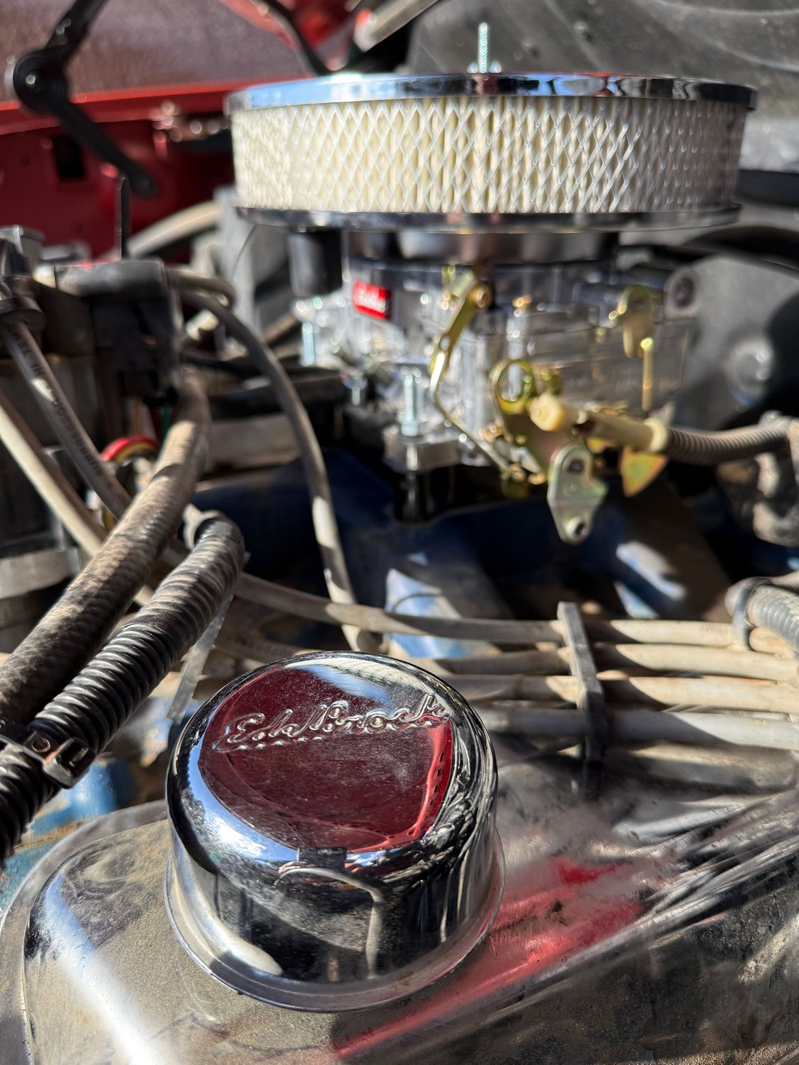

Pics of 1” spacer
Earlier I forgot to add the pictures of the 1” spacer…here ya go. Other than keeping things a bit cooler is there any other benefits from installing the spacer?

Is the spacer a 4 hole or open and the same for the intake manifold? Just want to know is all.
Yes there is another benefit from installing the spacer, it adds plenum space and that changes the power curve
Dave ----
4 hole…does one vs the other make a difference?
Larry

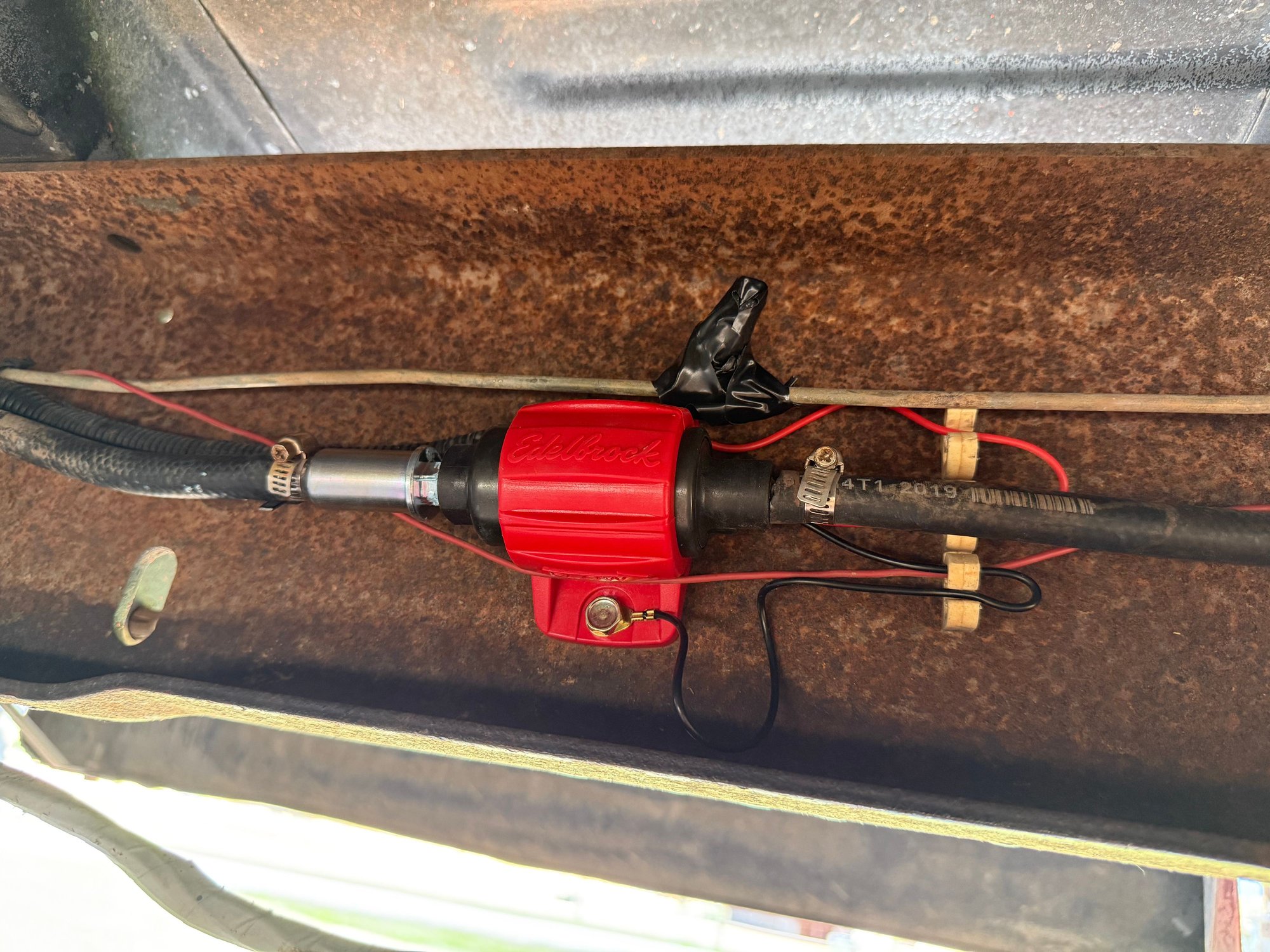

Officially closing out this post as fixed…thank you
Okay I installed the new edelbrock fuel pump and everything is working as it should. Stepping on the gas I can tell I have more power and it’s more responsive. I’ve attached a picture of each item I worked on. As of now I’ll say thanks for all your help as always. I officially close this post/ request for help out as problem was analyzed and fixed with the new 1” carb spacer and a new fuel pump.
