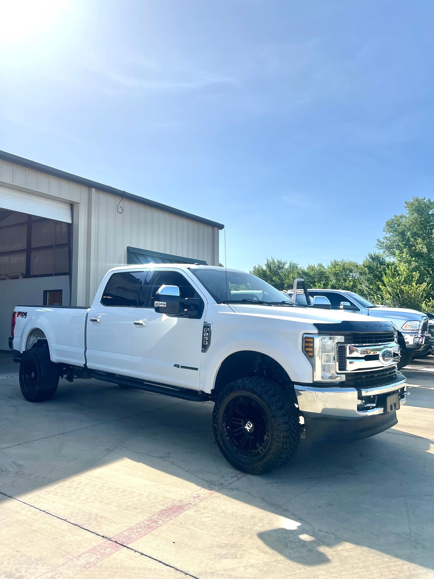

no sir, no light bars lol. Yeah agreed I wanna have it changed, I bought their 3 month warranty thing through AUTTO so I’m gonna have them take a look but can’t till monday so wanted to get some ideas before then, so I’m gonna have them inspect it all just curious if anyone had any other thoughts on it. I’ll check the cooler now didn’t even think of checking the cooler, it is dusty and dirty around here. Here’s a photo of the truck.
