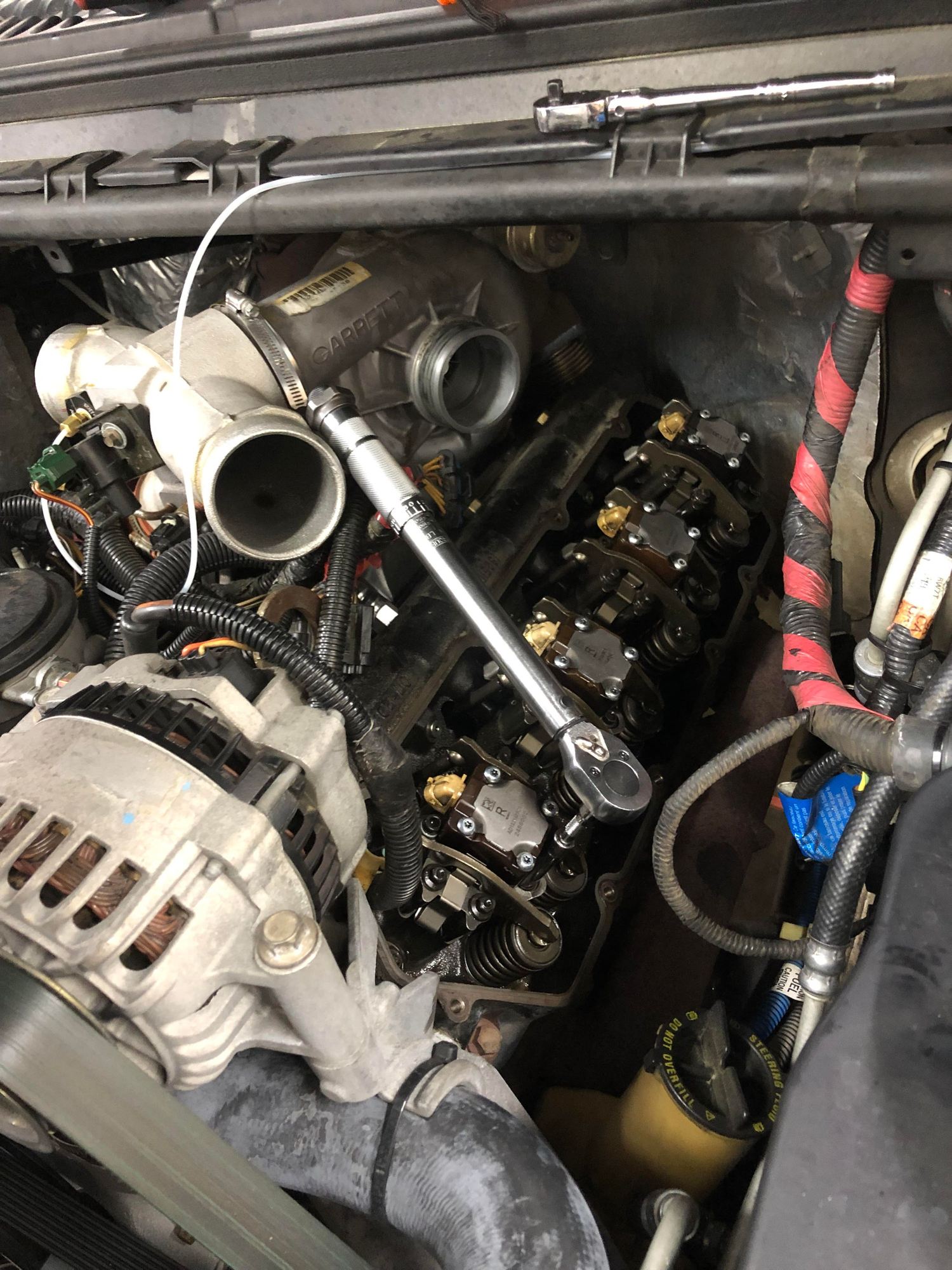

That metal ID plate is what motorcraft reman injectors come with.

Originally Posted by Hit Man X
I THINK those are about 120cc split shots, somewhere in that area. Truck runs and drives okay on them and all are AB?
My old were all 'AA' Reman like with the large 'R'. I think the consensus was they are from Ford/IH something like that.
AB injectors are ~120 cc split-shots and were used on 1997-early 1999 California F-series, 1997-98 E-series, and early '99 F-series.
The injectors look like Motorcraft remans, I put four of them in my early '99 and they look exactly like those.
MLE1 is the catch code for a 1996 F-250/F-350 manual transmission federal calibration, so unless it's been flashed, it is set up to run single-shot AAs, not split-shots. A 1997 California truck would use AB injectors if it was <= 14,000 lb GVWR although it looks like according to the PCM catch code list that >14k GVWR trucks were all "50 state" calibration and thus should have used AB injectors only in early '99. Something doesn't quite add up...
