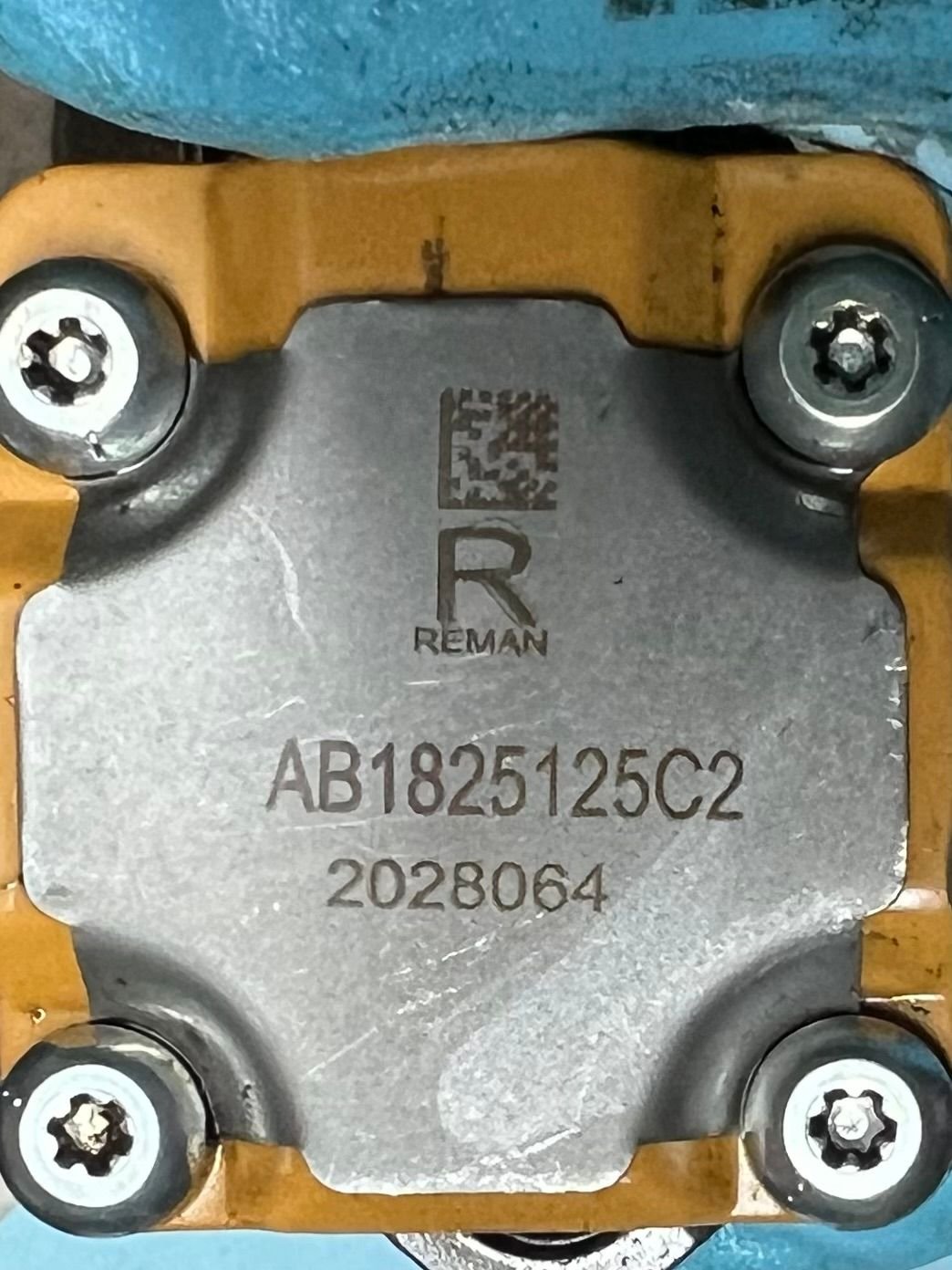

Recently while doing a compression check on my engine, I was kinda shocked to see that AB injectors have been installed. I tried searching through the forum to see what truck had Cali emissions. When I went to E-fuel there was not the dampener on the metal fuel lines going to the heads. The catalyst sticker does say use in Cali in trucks over 14k GVW. My pcm code is MLE1, which Hydra and Chattanooga Diesel say is for federal emissions. I have attached a photo of one is the injectors. The donor truck was a 1997 F-250 Heavy Duty. Am I missing something?

I THINK those are about 120cc split shots, somewhere in that area. Truck runs and drives okay on them and all are AB?
My old were all 'AA' Reman like with the large 'R'. I think the consensus was they are from Ford/IH something like that.

Yes they all are AB, truck runs great! Two seem to be Motorcraft and the others are some parts house special. Did compression check and pulled injectors due to chasing an oil consumption issue. Do you know if it possible that the internal orings in the injector can cause an oil consumption issue?

It is possible that who ever remaned the injectors built them to AA specs, using AB injectors as cores. I read somewhere that the solenoids are all the same regardless of the coding on them. Don't take this as the gospel, as you can read anything on the inter web. Jim at Rosewood Diesel could probably tell you more. Yes the internal o rings can cause oil consumption if they are bad.

The smoking could be caused by the wrong programing for the AB injectors, as for your oil consumption a bad injector might cause it as well. I would also inspect turbo shaft play and wetness on the outlet
