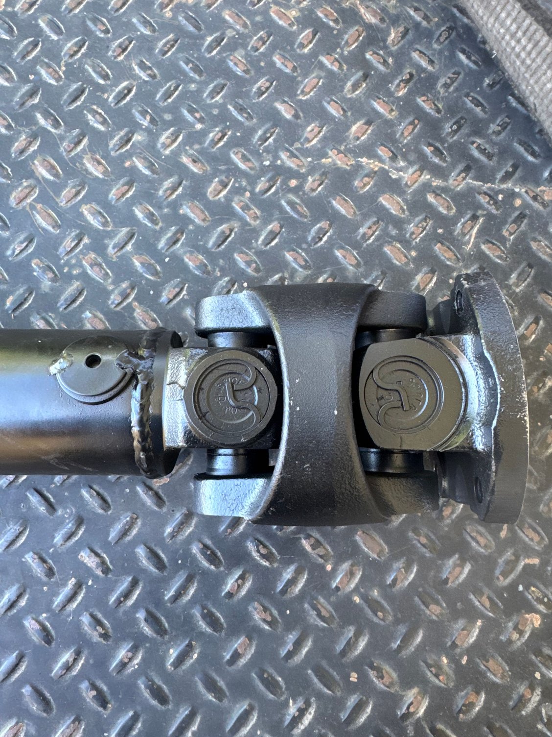

and get back to some normalcy! LoL My front driveshaft was ready to be picked up. Brian has now moved to a new commercial address. I will post his business card here but i will list his new shop address separately as the card isn’t updated.

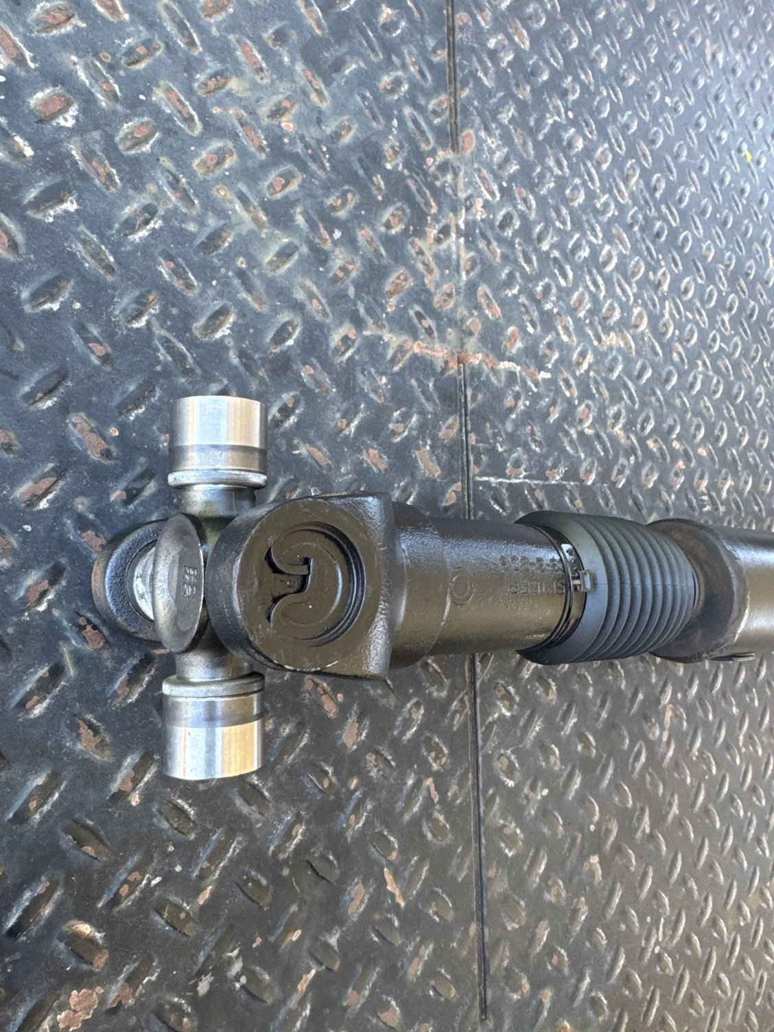

Anyway, the shaft looks real nice with the Neapco double cardan joint which is greasable. Two 1350 spicer joints in the DC Joint, New 1410 front joint and a new dust boot for the slip joint. Has nice welds where the old cv joint was cut off and new DC joint welded on. Brian also balanced the shaft.

Here are some pics of the new installed driveline that ford should have put on at the factory!
