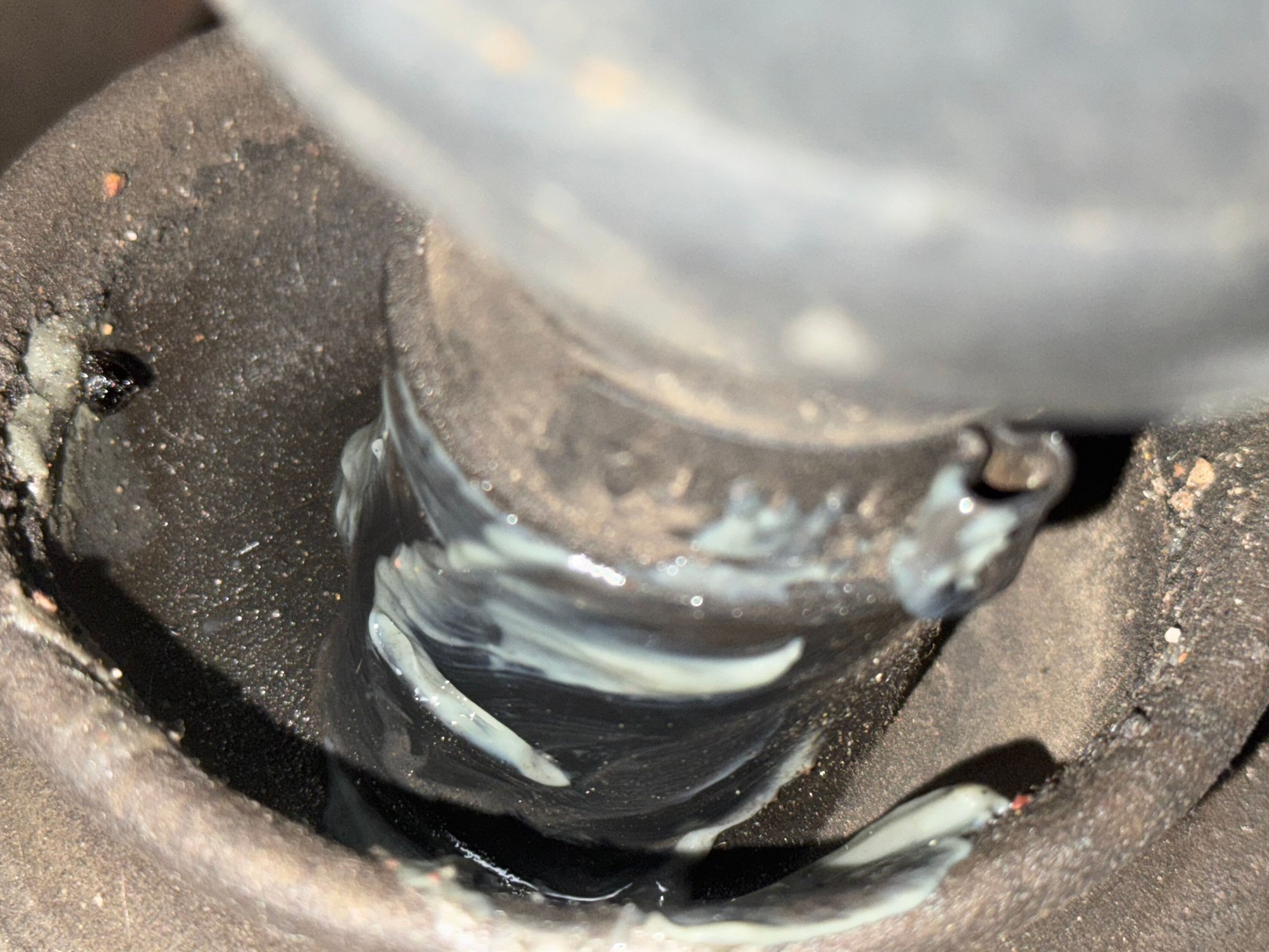

Was under my 17 F350 doing an oil change and noticed my front driveshaft was oozing grease through a ruptured cv joint boot. I looked around the internet for the cv joint and actually found one on rockauto but decided that part too will probably fail again.
I ended up getting a Dorman replacement front driveshaft and it has a double u joint cv joint as an OE fix upgrade. I was surprised to see this driveshaft damaged after only 52k miles. Also noticed my cab mount bushings are on their way out! 8 year old truck and it’s falling apart!

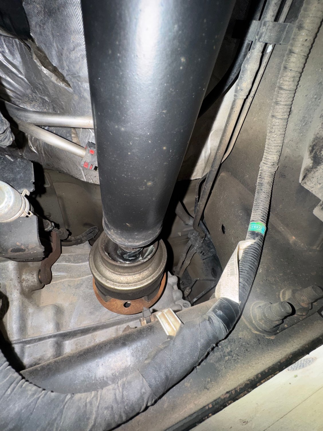

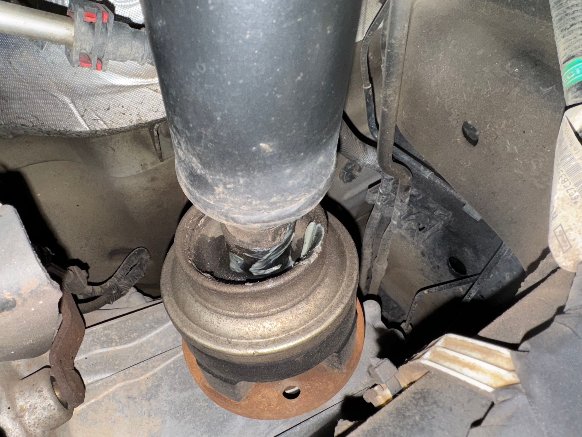

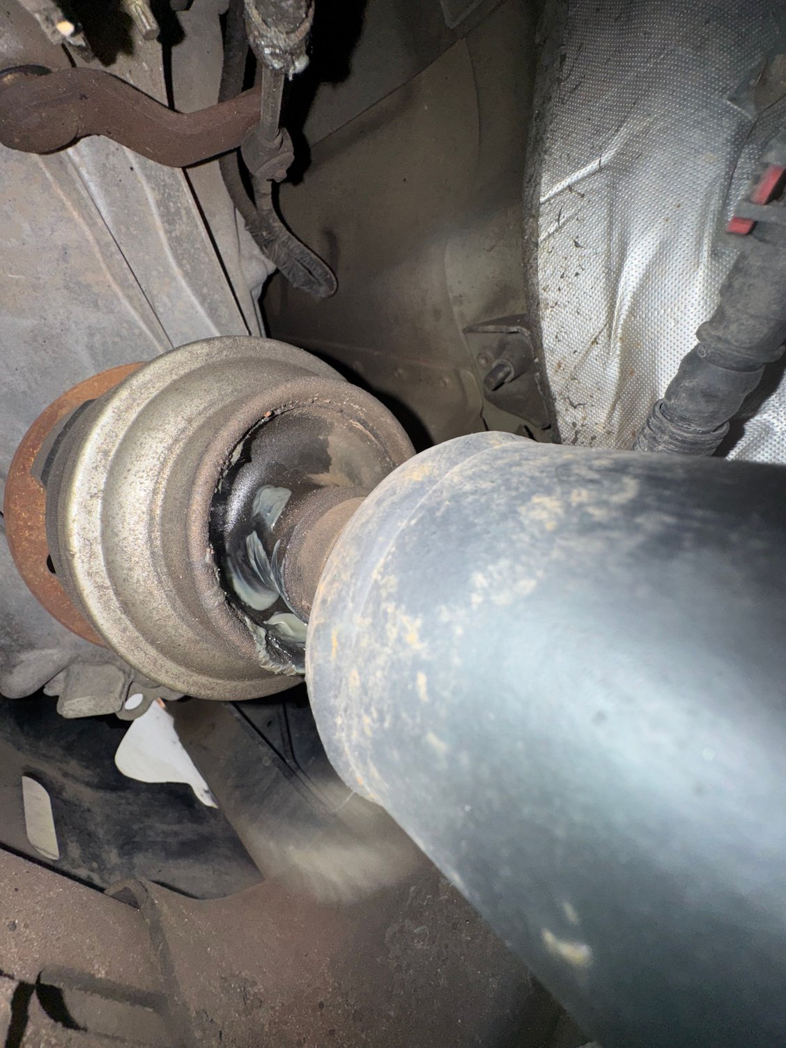

Here are some pics of oem front shaft. CV joint is at the transfercase side of front shaft. Grease boot is ruptured and grease looks milky as if contaminated with water.

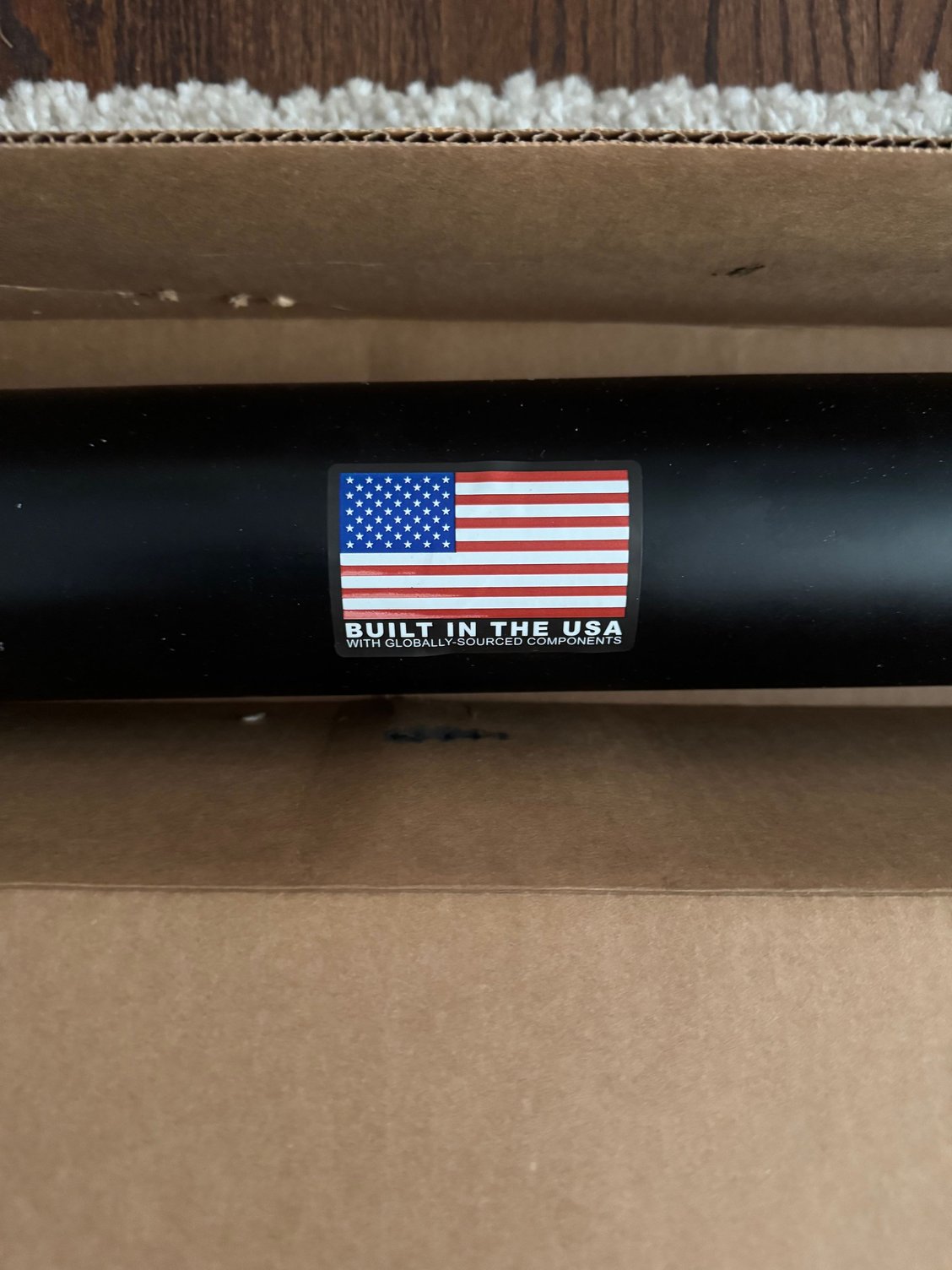

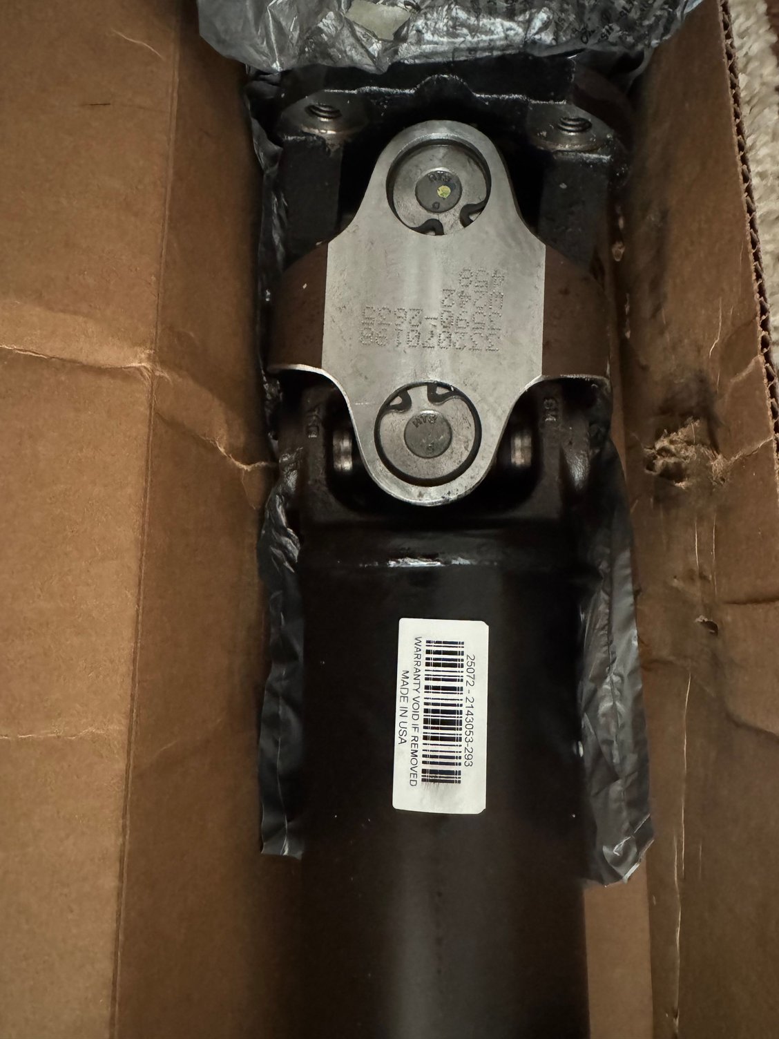

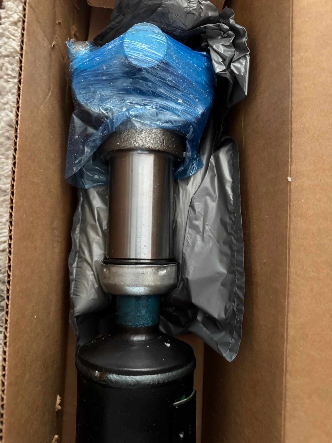

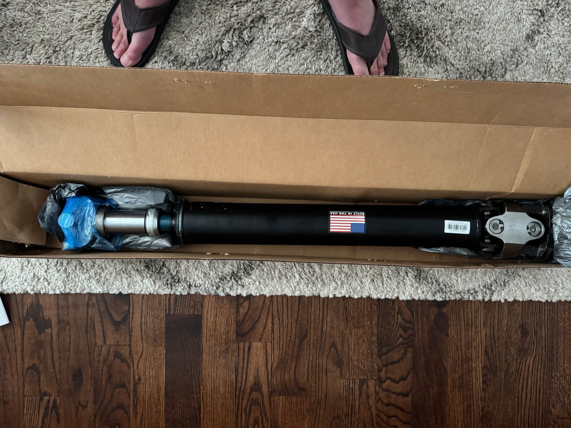

New Driveshaft arrived. Looks to be quality unit with a double cardan joint instead of the oem cv joint and Made in USA.

As far as I can see, the u joints aren’t greaseable but are serviceable, not peened but have clips.
That’s probably a good thing for strength not being cross drilled for grease pathways.
Factory shaft front u joint is also non greaseable. I only changed to a double cardan joint shaft because i don’t want to keep changing the cv joint grease boot. Ford really cheapened- out here!
Theres also another outfit in Michigan building a front shaft for our trucks, i believe called “Wellbuilt.” They were actually about $70 cheaper than the Dorman unit. Both are made in USA. So no bad choices imho. I felt that Dorman being a top tier level supplier would have a superior product.

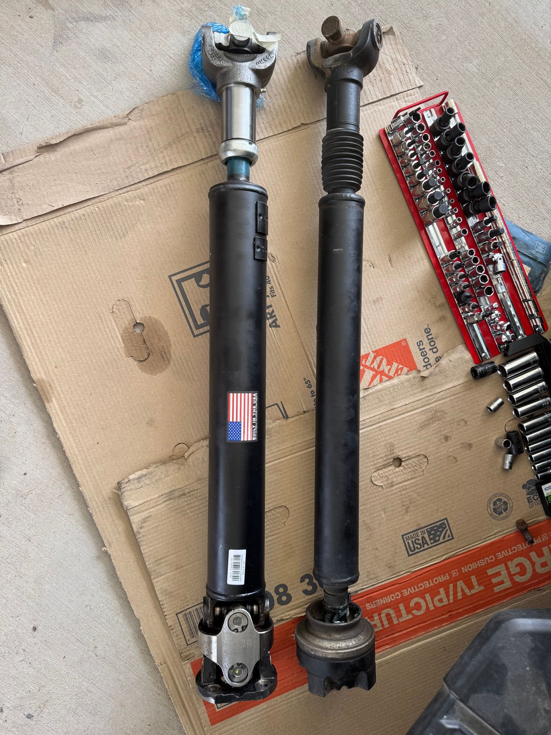

Follow up comparison pic of oem shaft and Dorman replacement. Ford shaft is 100% non greaseable and slip joint dust boot. Dorman shaft has a greaseable slip joint only and no dust boot.
Job isn’t too bad. Only one skid plate to remove so you can gain better access to the front CV joint attach bolts which are a 12 point design and a 6 point 12mm socket fits perfectly. Front driveshaft bolt heads are an 8mm and I used a 1/4 drive to remove them, no heating and or presoaking with penetrating fluid.

Amazing side by side comparison. Looks like one belongs in a Super Duty and the other in something less.

Dorman unit definitely looks overbuilt!
