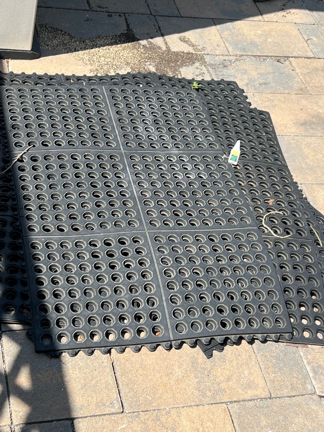

If you can’t get support from distributor and there are no forum quick fixes….the best thing to do is store stuff in totes in the bed under the leaky cover or if the leak is localized ( leaks at tail gate but no where else …you can elevate your stuff with these Home Depot mats and it will keep your stuff dry as the water drains from back to front.
Make sure your bed drains are not clogged.
