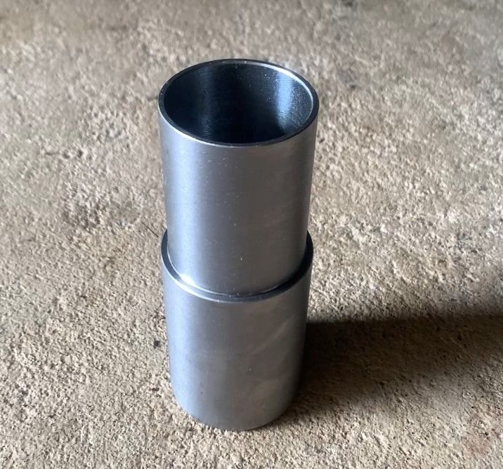

Forgot to report back. I found a bushing puller on Amazon. After grinding down a bad weld, it made quick work of pulling the bushing. Video attached.

Really easy. The tool also came with a bushing guide to insert the new one. Some light tapping with a hammer, and the bushing was installed.

It's the set made by JS Professional Parts
https://www.amazon.com/dp/B0DZVGKK8D?ref_=ppx_hzsearch_conn_dt_b_fed_asin_title_3 https://www.amazon.com/dp/B0DZVGKK8D?ref_=ppx_hzsearch_conn_dt_b_fed_asin_title_3
https://jsprofessionalparts.com/prod...727-36rh-37rh/
