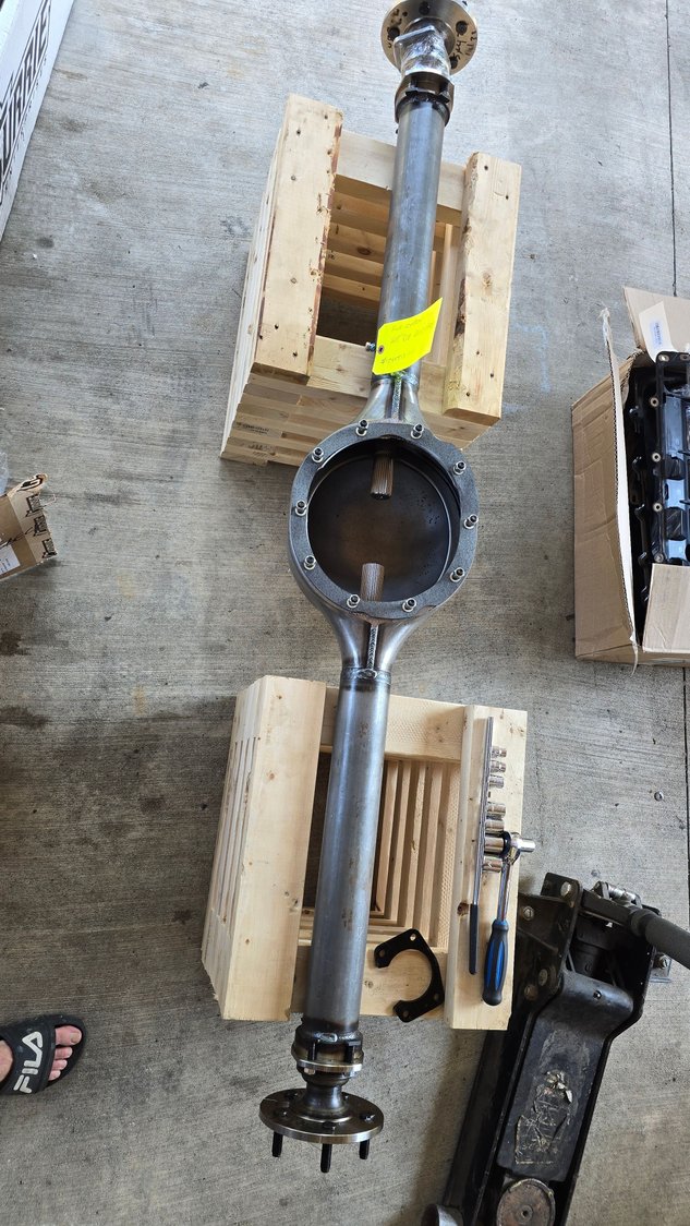

The new for 9 inch arrived too, just starting to mock it up, hopefully I'll get it and the rear 4 link in before the weather turns and I call it for the year...

I'm liking what you're doing. If I ever get to do another F-100 I think I would like to do a natural patina truck. The rear housing looks pretty wide. Are you going to be narrowing it? What size gears are you planning on running?
Thanks!
The rear housing was made (hopefully) exactly the right width for my rims and so I don't have to cut or tub it.
3.55 gears to match up with the 10 speed.

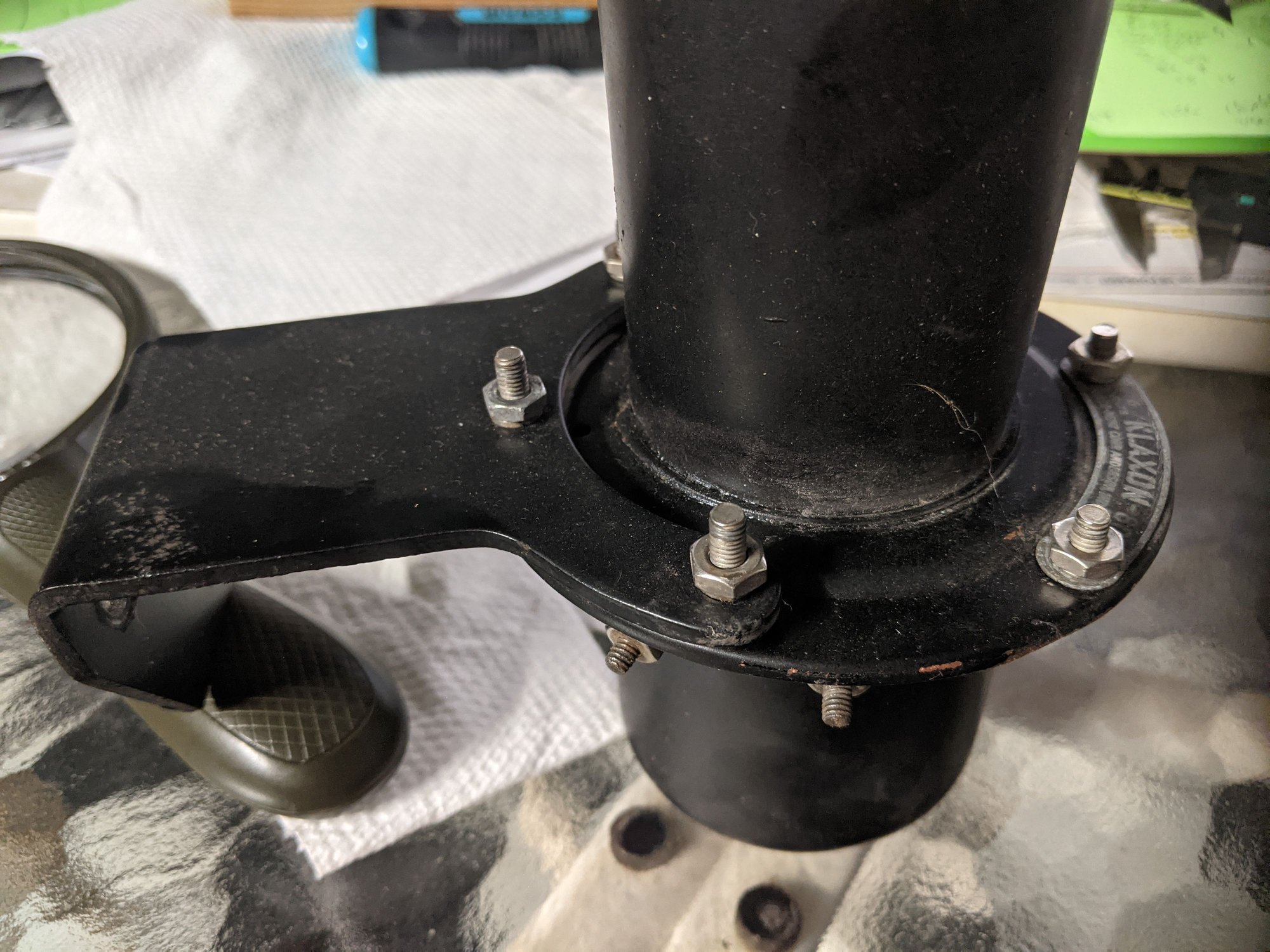

Originally Posted by 53patina
Another dumb question, what's this for and should there only be 1? It's on the rad support, but only 1 side
Horn_Mount_Bracket
Horn_Mount_Bracket
Definitely the horn mounting bracket.
