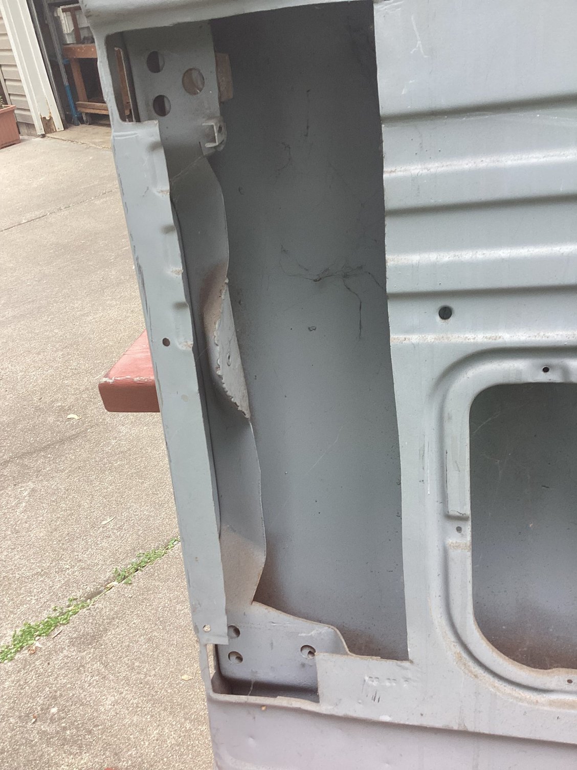

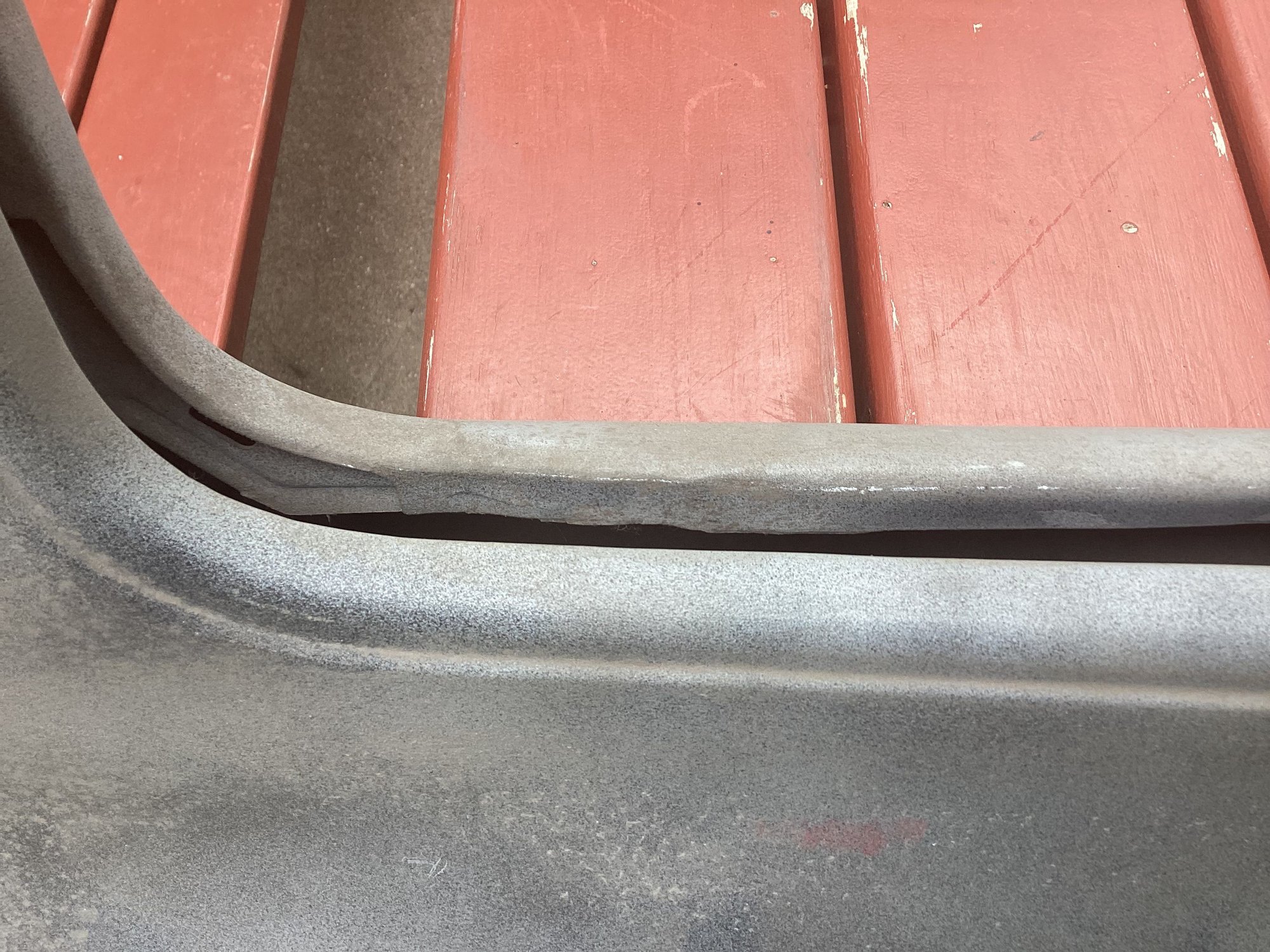

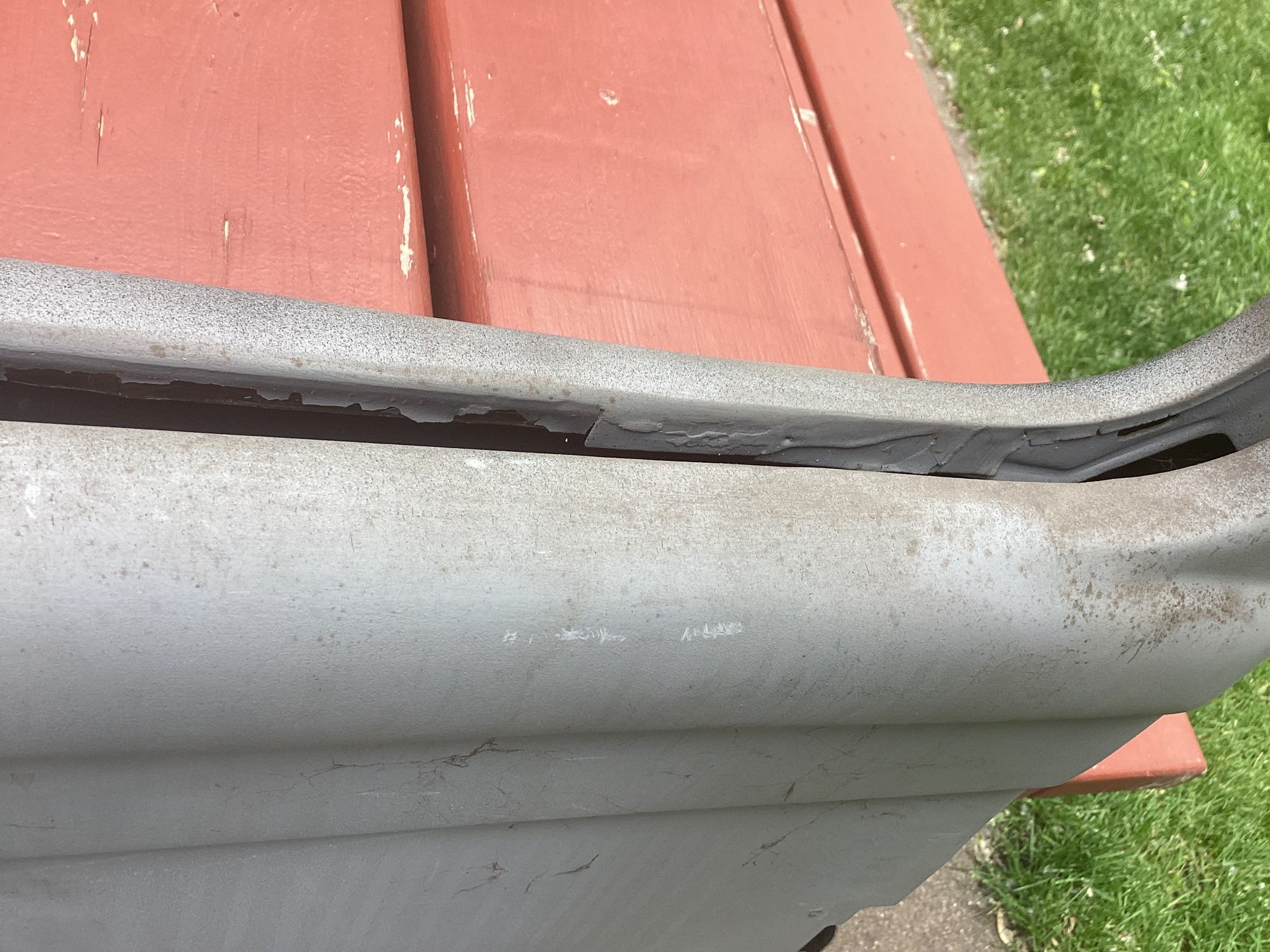

The right door I started to modify. The top edge of the door where the wiper strips fit is cut out and replaced with the 90 degree bent metal strips which are included in the kit.
The third picture shows an access panel cut out to gain access to inner structure for modification. The top hinges is shortened.
