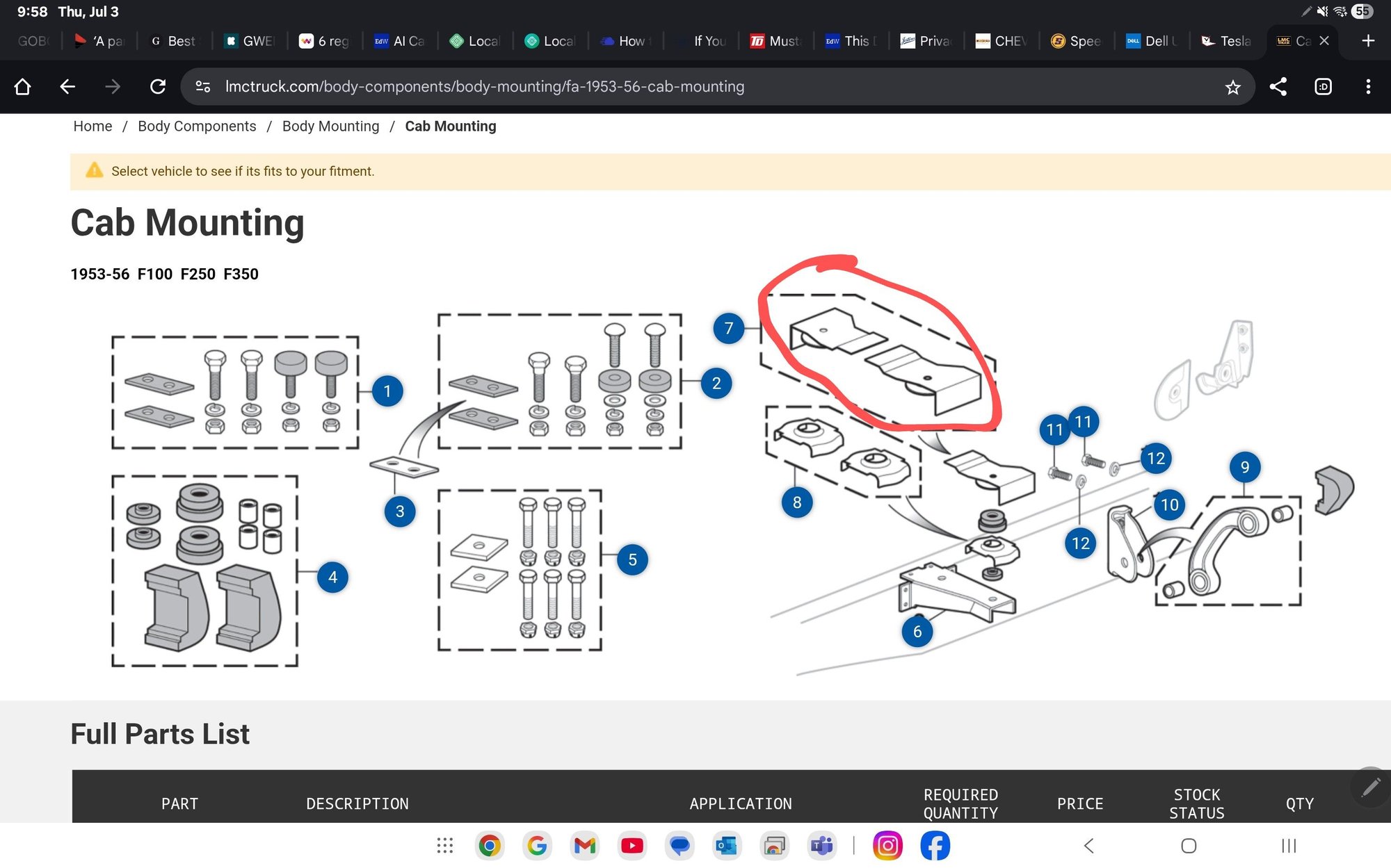

Where do these go?
I bought everything new to mount the cab, most of it I understand, the parts circled in red I don't know. Do they get welded to the cab?
Old Jul 4, 2025 | 05:21 AM
  #33
DG11's Avatar
DG11
Joined: Jun 2024
Posts: 62
Likes: 32
From: Pleasanton, Texas
They capture the rubber "doughnuts" at the front cab mounts, and weld under the floor panels. The vertical turn downs were also spot welded to the rocker panels on my 55 F100.
Old Jul 4, 2025 | 08:22 AM
  #34
56panelford's Avatar
56panelford
Posts: 283,563
Likes: 8,228
From: northwestern Ontario
Yes they get welded to the cab bottom, drill or punch holes so they can be plug welded in place or unless you have access to a spot welder..

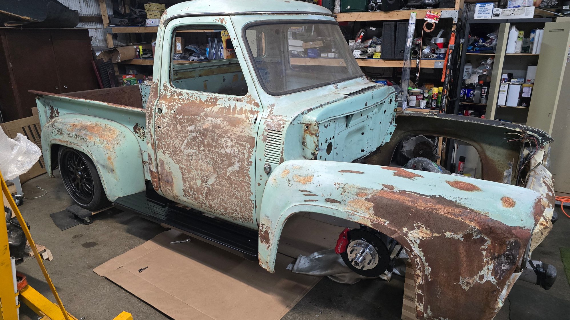

Old Aug 1, 2025 | 12:27 AM
  #40
53patina's Avatar
53patina
Joined: May 2025
Posts: 53
Likes: 61
Running board issues
So, got a lot done today, putting pieces back on to test fitment
But I have about 3 inches between the cab and the running boards...
Not sure why... They seem to lineup on the back fender pretty well, and the front cabs mounts are on and bolted down, have I installed the rear cab mounts wrong? Even if, seems like a lot to make up...
Any advice is more appreciated
Thanks
Old Aug 1, 2025 | 05:43 AM
  #41
DG11's Avatar
DG11
Joined: Jun 2024
Posts: 62
Likes: 32
A cab skirt fills the gap between the bottom of the cab and running board. Mine were degraded plastic, and broke when I took them off of my 1955. You should be able to buy remanufactured at a place like LMC Truck parts, and others. A metal retainer strip attaches them to the bottom of the cab.
Old Aug 1, 2025 | 08:48 AM
  #42
56panelford
Posts: 283,563
Likes: 8,228
Your cab is sitting high because you have those brackets bolted to the frame upside down..
Old Aug 1, 2025 | 08:51 AM
  #43
abe's Avatar
abe
Joined: Dec 2000
Posts: 25,365
Likes: 5,377
From: Central PA
Midwest Early Ford has them. They are called running board to cab seal. $20.
I'll measure my gap later but 3" sounds about right.
Old Aug 1, 2025 | 09:11 AM
  #44
53patina's Avatar
53patina
Joined: May 2025
Posts: 53
Likes: 61
Thanks! 50/50 chance, but I get this sort of thing wrong 100% of the time
