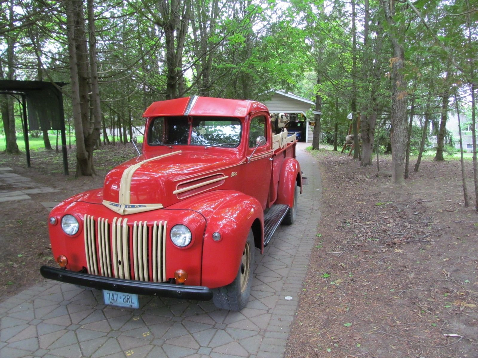

I own a 1942 pickup and the door lock key mechanism isn't working. It used to but just stopped. Not sure if just insertiing some oil might solve the problem. I took off the inner door access panel thinking I would see if the mechanism inside has come apart but it's a whole new world in there and small and dark. Please advise the best course of action.

I think I may not have been clear in my description. The key turns easily in the lock. I suspect the key mechanism has disengaged from the mechanism that actually works the locking mechanism of the door.
The door used to lock and unlock, no problem. Then one day the key no longer locks the door. The key still turns but it won't lock the door. Something I suspect has come undone - maybe ?
