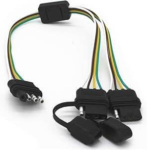

They have this 4 pin splitter for less than $10 on amazon. You could find a way to mount it or just use it when using the trailer.

Good to know as an option.
Thanks!

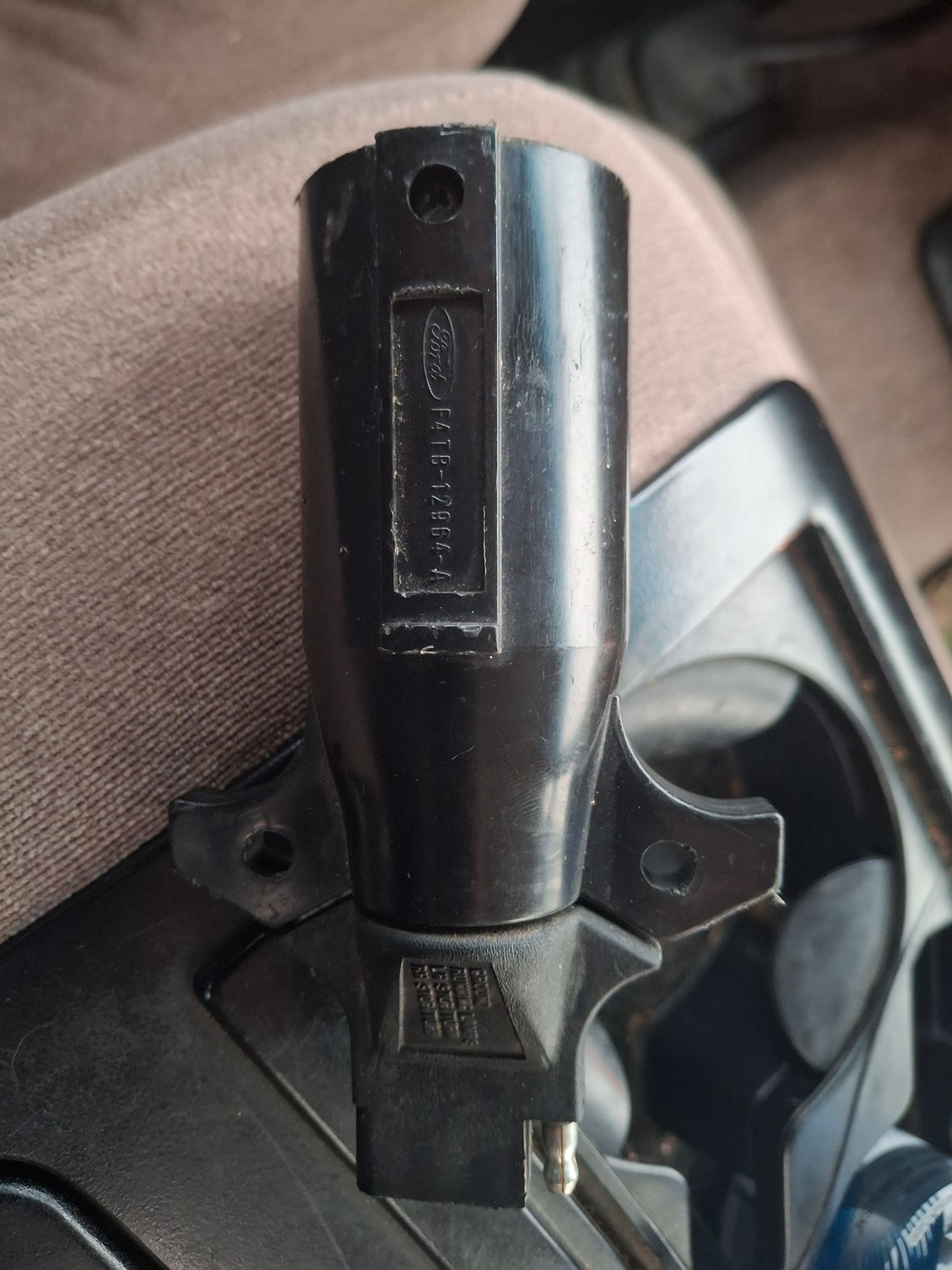

I used a Hopkins adapter ... no cutting, no splicing
  1. pull the ford connector from the back of the 7 pin mounted on the bumper
  2. insert ford connector into Hopkins adapter
  3. insert Hopkins adapter into back of 7 pin mounted on the bumper
  4. viola, you have an extra flat connector

This also looks like a viable option. This intrigues me since it will not tie up the factory flat connecter.
Thanks!
