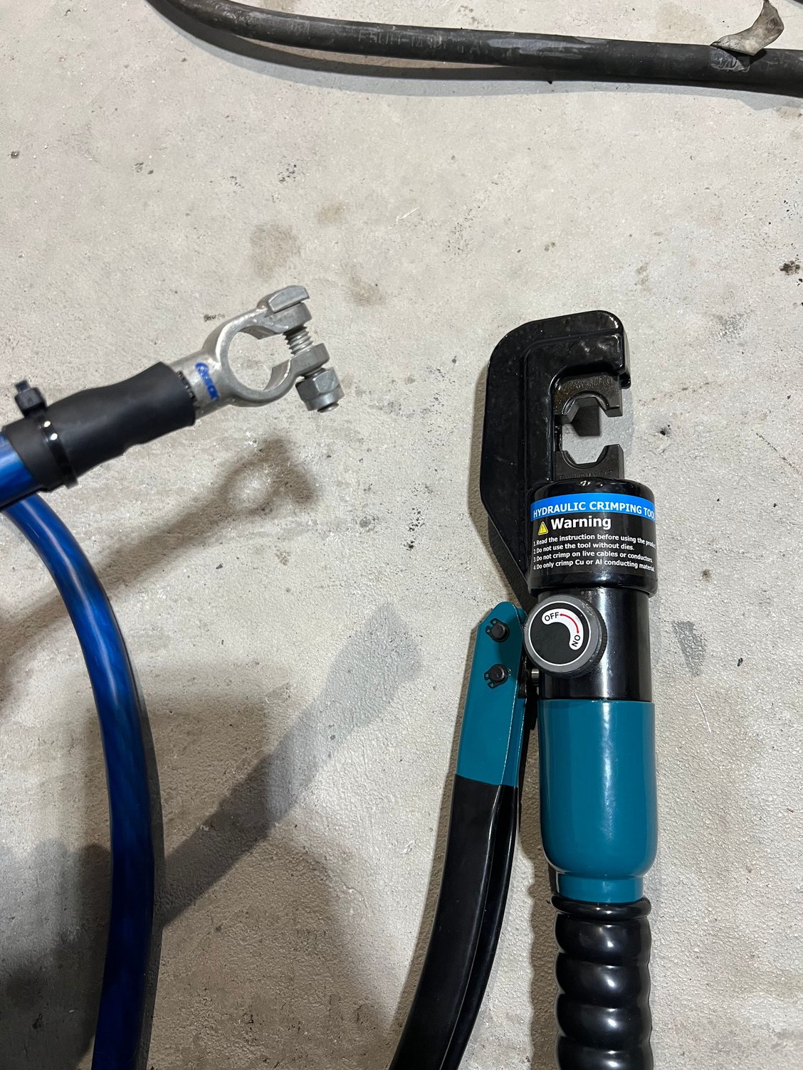

You can make em yourself for about $300-350 but you need to buy this tool for $40

I made my own, used welding cable, upgraded the size, FTZ Power Lugs etc. not the cheapest or easiest, but it was done right.
Reading the specs on the CE electric site, if true...thats a good setup, marine cable, FYZ Power Lugs, can't ask for much better, the price reflects.

I am usually the first one to advocate for DIY but having priced out both my truck's cables and the trailer mover's cables, I discovered that CE Auto Electric is actually very competitive.
