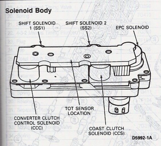

If the connector is clean, you can test the pack.
Originally Posted by FORDF250HDXLT
Testing it is actually VERY easy, You'll be messy, but drop the pan, pull the filter, unbolt it, unhook the wire, pop it down out of there (you don't have a repair plug ou can just plug into it) and put on a clean surface.
Get out your multi meter and follow the instruction is the prior photo of what it should read for resistance. If it's not within specs, which it's probably not, since you already tested the line from TECA to the solenoid pack plug, right? I think you claimed you did that already. Do it again anyway, making sure all wires reads 0 ohms and if the solenoid isn't within like, what was it? 5 ohms or so, right?
Also note this: Apply 12v power to the + pin of the EPC and ground the - pin. When you ground the - pin with power supplied to the +, you should hear it click on/of as you connect ground and remove it........No click......bad solenoid. Replace the pack. Same if it doesn't read within spec of resistance.

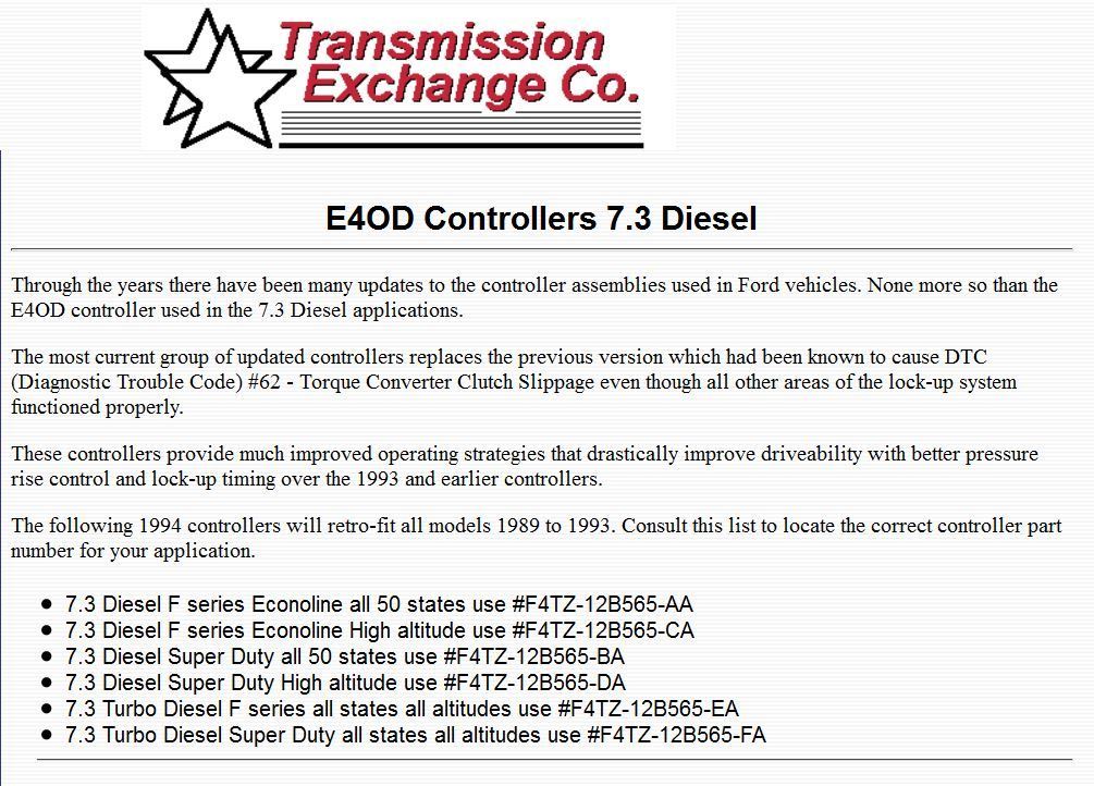

If it's within spec, and all your wires have 0 resistance from TECA to Solenoid pack plug, then and only then, would I blame the TECA and replace it (with a '94 TECA).
Just keep this in mind:
The odds of a poor connection (corroded wire/bad wire, poor pin connection) causing code 99 = 95%
The odds of a failed solenoid pack 4%
The odds of a failed TECA 1%
That's not exact of course, that's my best guess, but I bet it's VERY close! Maybe I should have left a % for something else, but I don't know what else could fail to set this code......I'm pretty sure this is it.
Oh. Almost forgot, but note solenoid packs are year specific. If you need to replace it; be sure to use the PRE 1995 pack. That's the '89-94 pack for IDI trucks with the E4OD. They take "good" effort to pop in and out......Don't be afraid of it.
Any good reman or used according to budget is good. They rarely fail. I would trust a tested used one in my work trucks that I count on to make money, so. If you can afford a reman pack just the same.....go with that. You'll get a brand new, clean electrical connector installed in it. Never mind the nice new solenoids haha this is more important. (joke placing emphases on how vital clean connectors are so important.)
