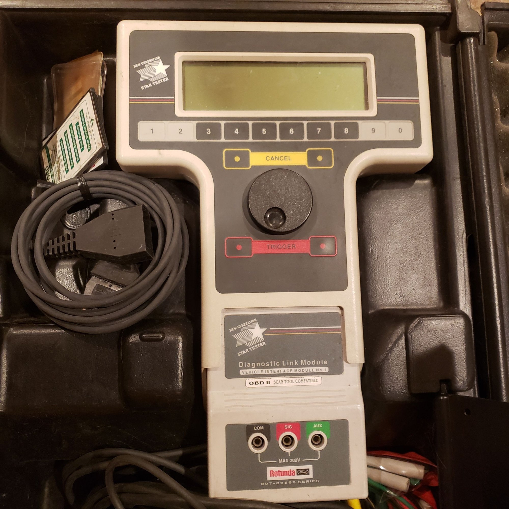

I can run the wipers and 4x4 using the Ford NGS scan tool
These are for sale cheap at times because it's outdated tech
But it's what's required for Ford vehicles of your generation
Only a few scan tools will run B and C codes, U codes as well
Find someone in your area that has one of these to help you out
