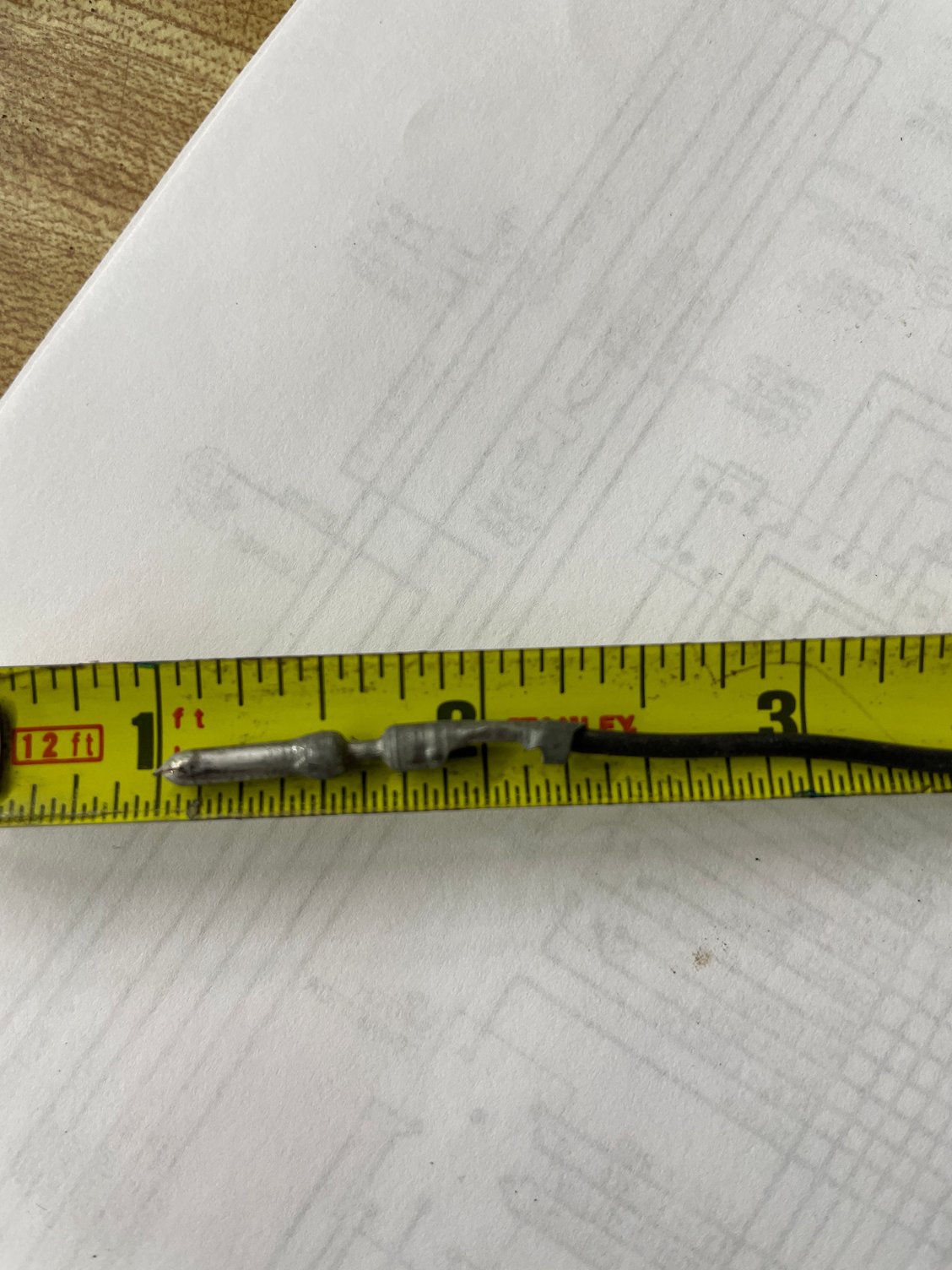

I have a kit car (glassic model a) that was built in the early 70s with mostly ford parts. I am updating the wiring harness to a speedway motors universal one to remove the multiple scotch locks and chaffed wires.
it has the ford turn signal switch wiring and connectors, I wondered if someone would have a place or part number so I could install the correct male terminals and use the factory plugs rather then use weather packs.

No, I’d like to find the terminal that is in my picture in the original post

Are they called "wedgelocks".
https://www.ebay.com/itm/33262644183...8aAhWGEALw_wcB

I've had wonderful success finding those sorts of Ford OEM terminals through this site: https://www.clipsandfasteners.com/We...r-p/a14888.htm

Yes I think those are it and I did order some from clips and fastners

Connector bodies and pins are very difficult to source, and sometimes you have buy large quantities.
This ebay post looks similar and maybe the part number will be useful. The price from Clips and Fansteners is much better.
https://www.ebay.com/itm/14321676901...Bk9SR7i2lOb1ZA
I have resorted to junkyards for most of my connector requirements. Salvaging pins can be difficult though.
