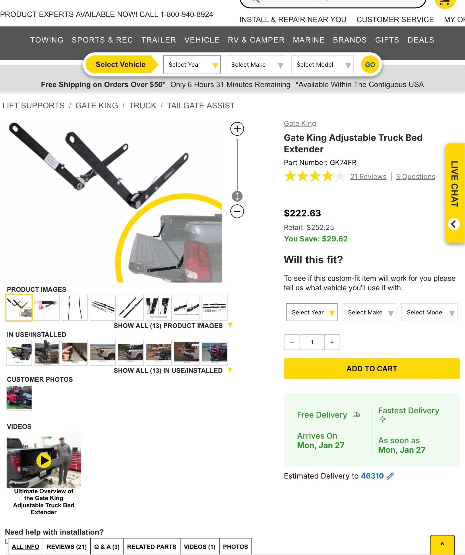

Saw an advertisement for a locking hinge that replaces the cable and allows the tailgate to be locked into several positions from open to closed. Made of flat stock so it would eliminate the cable issues. Can’t remember where I saw it, most likely Facebook, but it looked to be of good quality.

Drove me nuts trying to find what I referred to above. I believe these are those brackets.
