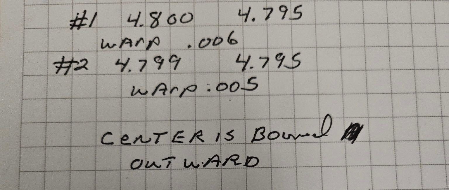

Heads are done for?
Just got a call from the mill shop. They said one side of the heads are already at minimum spec and the other side is close to 4.805 max. The middle is warped. Are these heads to far gone? What’s my move here?
here are the specs from the shop
I’m gonna run a Felpro head gasket which is supposedly 10thou thicker then stock when crushed. Would this potentially allow me to mill the heads to true flat (cutting out the bow) and still have enough valve clearance?
Im also gonna check the block I’ve read it’s unlikely that it’s also warped but if these are warped .006 out that would mean overheating at some point.

Likes: 78
It seems like they should be able to mill them flat, I don't know, because I didn't send my heads in, or even measure them, for that matter.
I'm a retired body shop man, and can see by eye and feel, even very minor defects, so I cut mine real good, but still, it was done by hand, and, I only aimed for 85% good enough.
Good torque on the head bolts or studs will take up a lot of slack and imperfection, on my stock 6.9 bolts, I went up into the low 90's. They'll crush and fill in small gaps.
I cut them flat with a knife stone by hand, as a hone. I haven't had any problems.
I wouldn't worry about the precups, but this is just anecdotal, just my experience, and perfectly flat is always best, if you really want it.
I just don't think they're all thaat sensitive, I just got it 85% and run it.
If they ain't buggared em' up, I'd just ask them to get em' pretty decent as they can with what they have on hand, and if in doubt, run head studs and crank em' tighter.
If you use your stock head bolts, I can attest that they'll take slightly above 90, I think I went about 93 lbs. If you use 7/16 studs you could probably go to 110.
Someone will probably have better detail with the specific answer on the specs, these r' just my musings.
